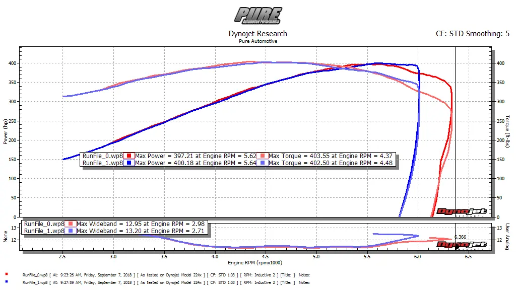

All set for dyno tomorrow morning. I’m not gonna make adjustments while there. I’m at 9 degrees initial timing and running 11.1-11.6 in the ARR flat out.

Chart
