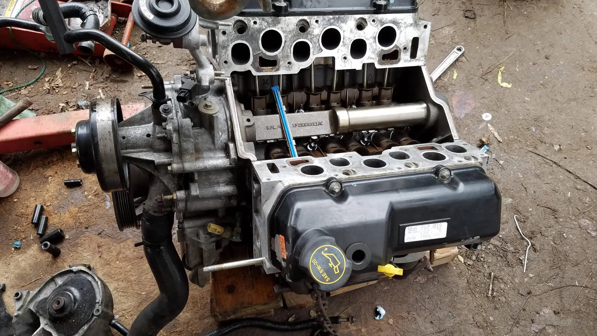

I bought a donor motor supposedly from an '03 Mustang V6 (Claimed it was wrecked, had 35K on it). However, it had a '99 Flywheel (Externally balanced flywheel... not right for an 03) and it has an air pump system on it from a '99 (My '02 does not have this air pump system at all) (Second picture).

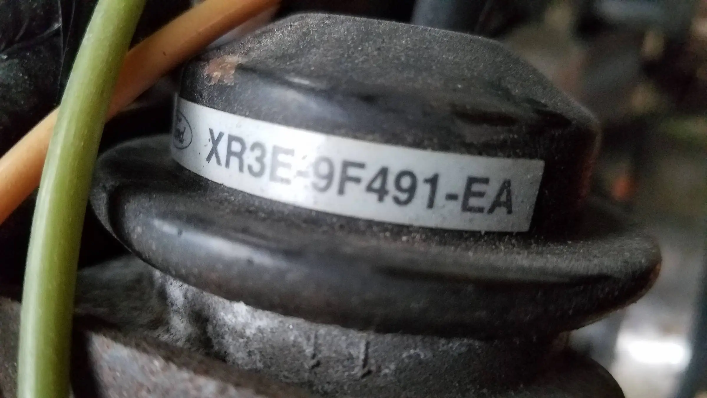

I googled the model # on the air pump valve and came up with this. Looks like it only goes to '99 and '00's with California emissions.

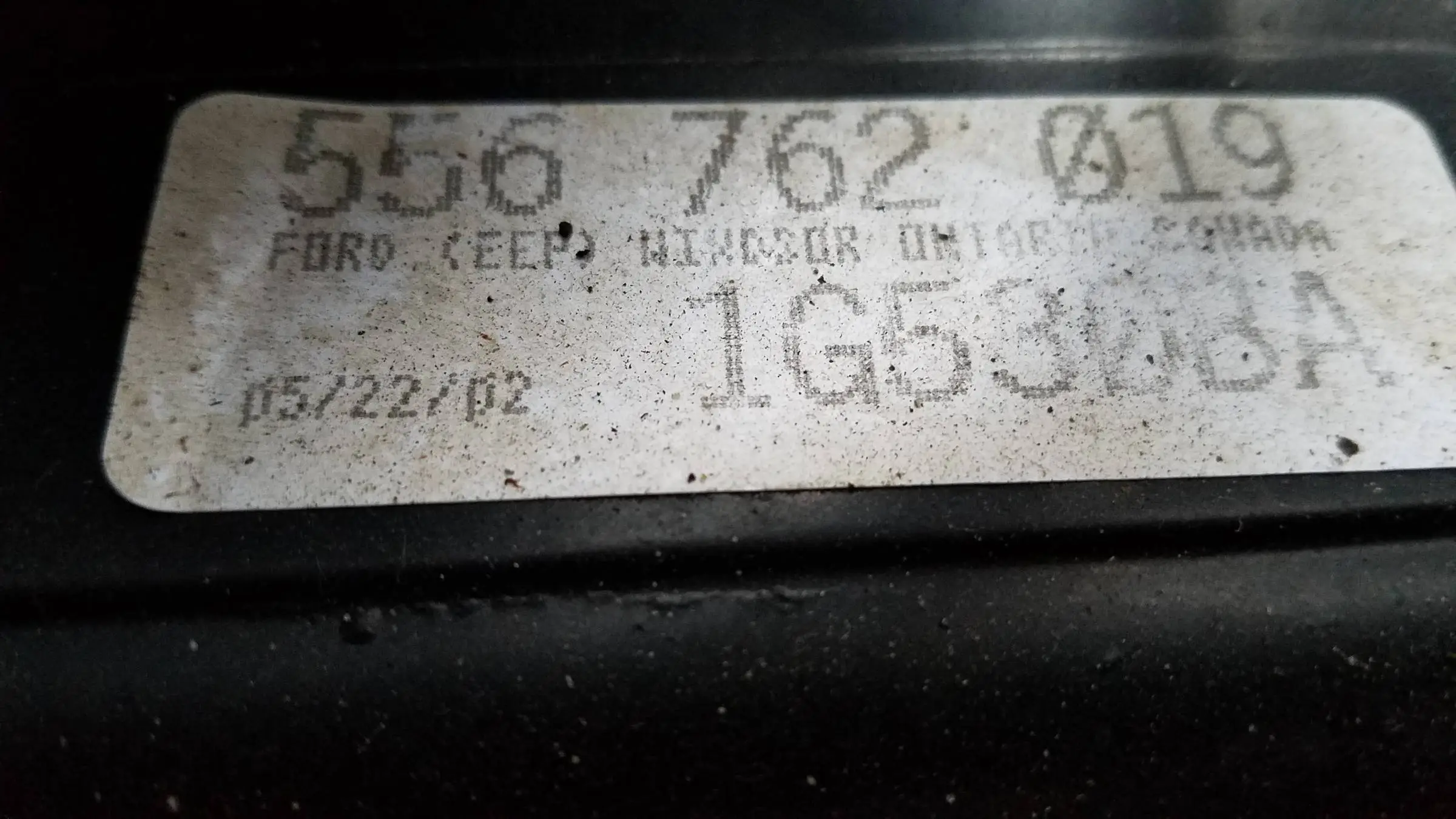

I can't tell anything from the valve cover... I have googled 1g530ba and I only find cylinder heads for sale.

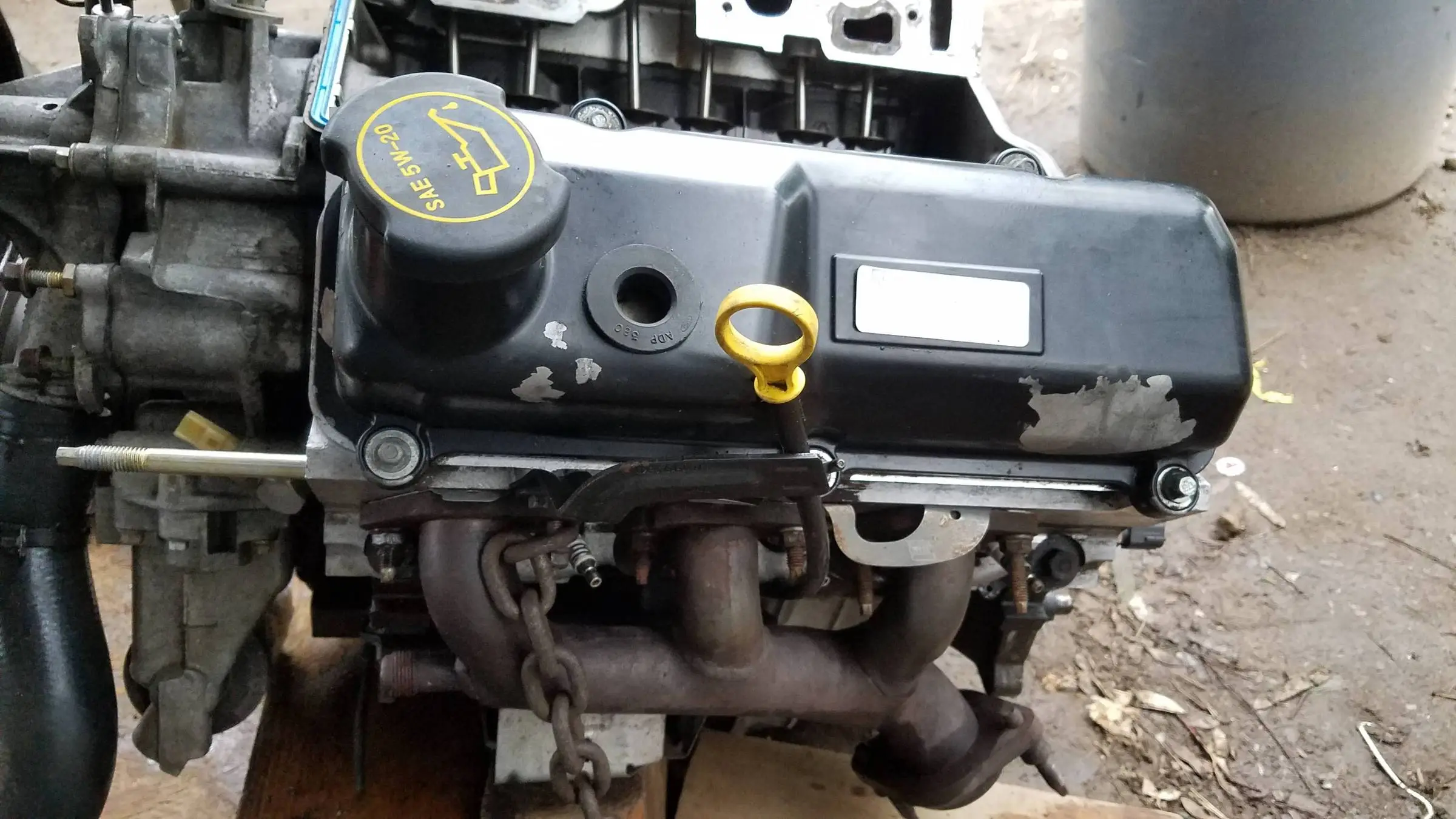

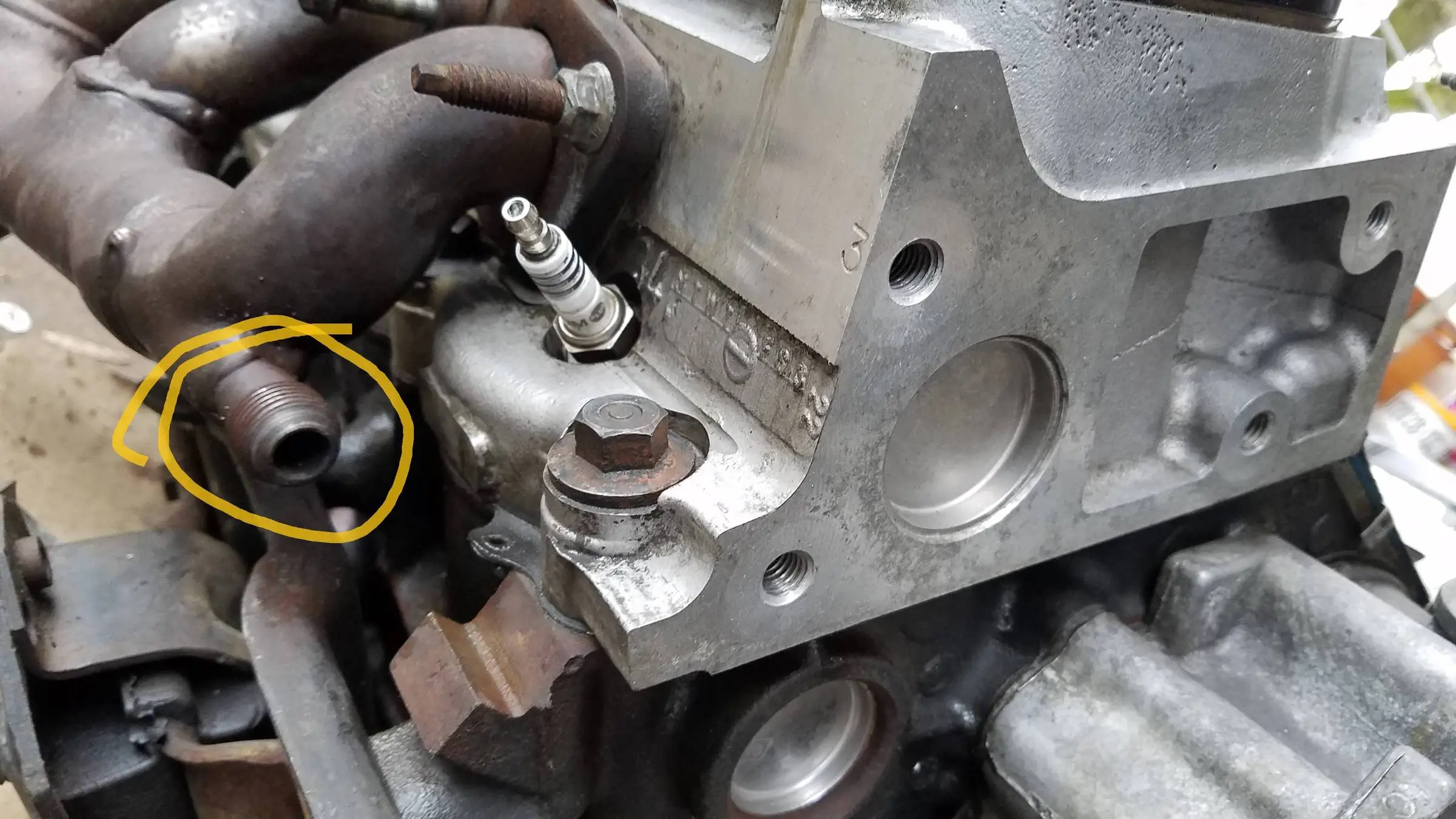

I noticed there's no rod for the IMRC on the back of the donor motor's intake... what gives? Could it have broken off? I just serviced the one on my car and it was fairly obvious where it was located. I already see I'm going to have to use my original exhaust manifolds, upper intake, EGR system and I also think wiring harness. There is an extra EGR tube on the donor motor's manifolds and it is plumbed differently. My 250K exhaust manifold has cracked on the passenger side so i wanted to get rid of it. This is a first glance, I haven't actually begun tearing into these yet.

The cast aluminum on my donor motor is very oxidized, but the sticker is still there on the valve cover and no evidence of leaks....
Anyone want the air bypass valve?
