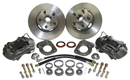

I am interested in buying a conversion kit, but it states for a 68 v8 spindles. Are there an difference in v8 spindles to a 6 banger. And this is the setup does anybody have any info. Conversion is 450$ and free shipping. Has anyone heard of performance online?
the six cylinder and V8 spindles are essentially the same. what you should be looking for are drum brake spindles as in 68 they changed to disc brake setup from the four piston design you have pictured, to the single piston design used until the late 90s. if you have six cylinder spindles you are golden to use that kit.
