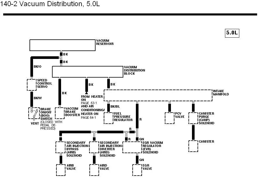

Does anyone have a picture or pictures of the vacuum line routing on the stock 94/95 intake ( the vacuum ports under the intake, and the 3 way splitter near the EGR)
Trying to finish up SeriousSn95's car and for the life of me, I can not remember the vacuum line routing on the intake, it's been so long.
Is this what you were looking for?
