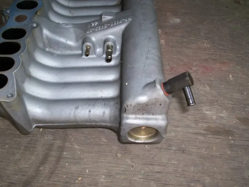

the stock intake in the picture below has 3 vacuum ports 2 under the inake and 1 on the side so if all 3 vacuum lines are connected on yours you should be fine is does not matter where you connect the vacuum lines as ling as the line fits snug on the fittings you will need to plug 2 fittings if you have four underneath and one on the side connected.

The small nipple goes to the canister purge valve, and the other two run to the PVC valve
