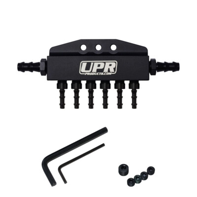

Do they make any that have additional ports from what comes stock? I've been searching but without any luck.
Edit: maybe this one?
UPR 8-Port Billet Vacuum Boost Distribution Block Turbo Black Air Lift Ride Bag | eBay
UPR Universal 8 Port Vacuum Distribution Block Billet Aluminum. The UPR vacuum block can be installed anywhere in your engine bay with the three. UPR's Super Clean new design incorporates a hex on the inside of the fittings for a.
www.ebay.com

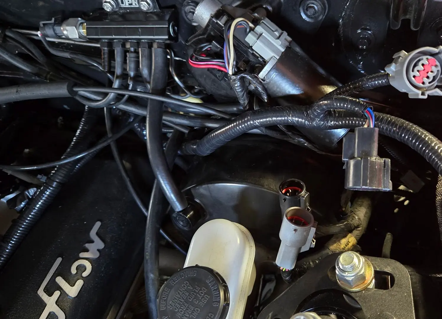

The one I linked is actually a direct replacement with 2 extra ports. They are on the sides. You remove a plug and install a fitting of your choice. (The extra fitting isn't included) My boost guage uses a presure transducer that sends an electricl signal to the guage. I mounted my transducer in one of the extra side ports. Its on the left of the tree in the pic below.
Ah, didn't even see the side ports. Thanks for clarifying. Gonna order one up and maybe try to get one extra (somewhere) of the super small barbs, one for the FMU and one for the Boost gauge line. I wonder if i can run the manifold source to the left side port to provide vacuum to the entire tree.
