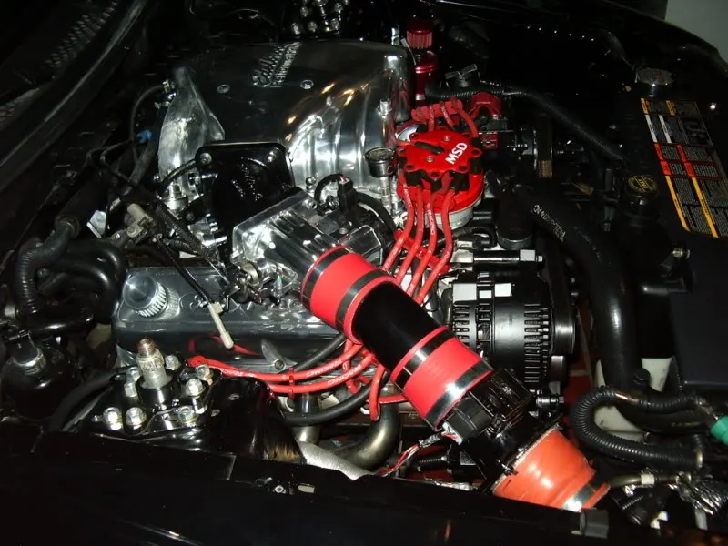

+1 on the fox valve covers. I have them on mine with the fill tube cut down and a push on cap on top. It is hard to see in this picture because the fuel lines run over the top of the cap(help keep it down).

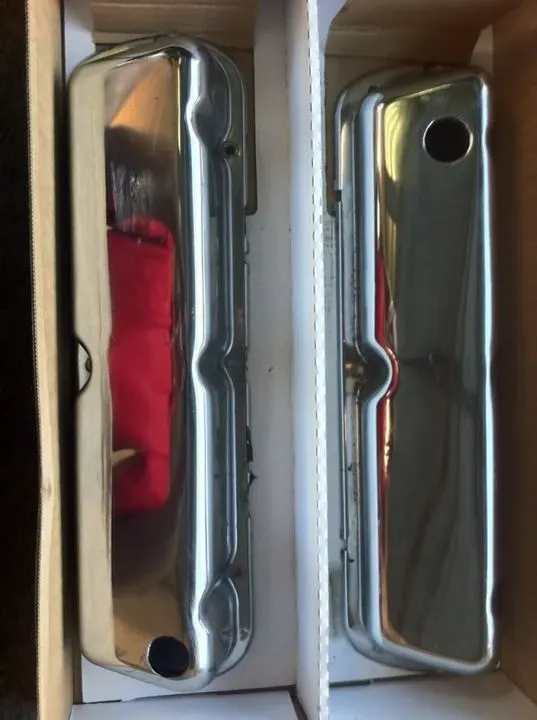

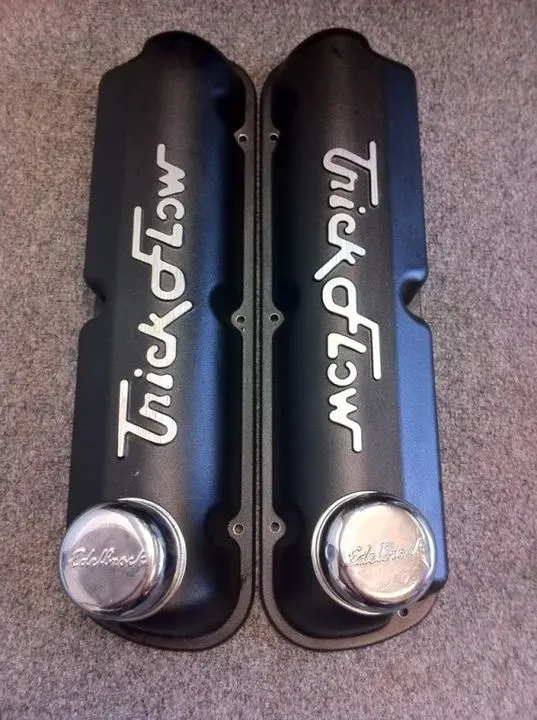

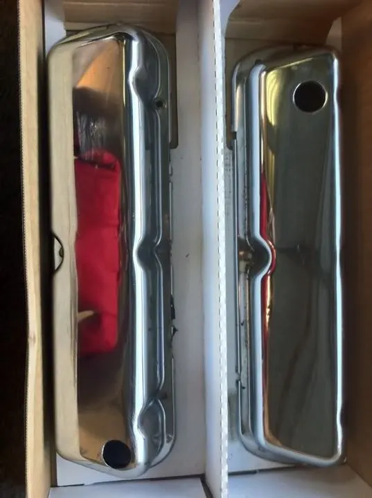

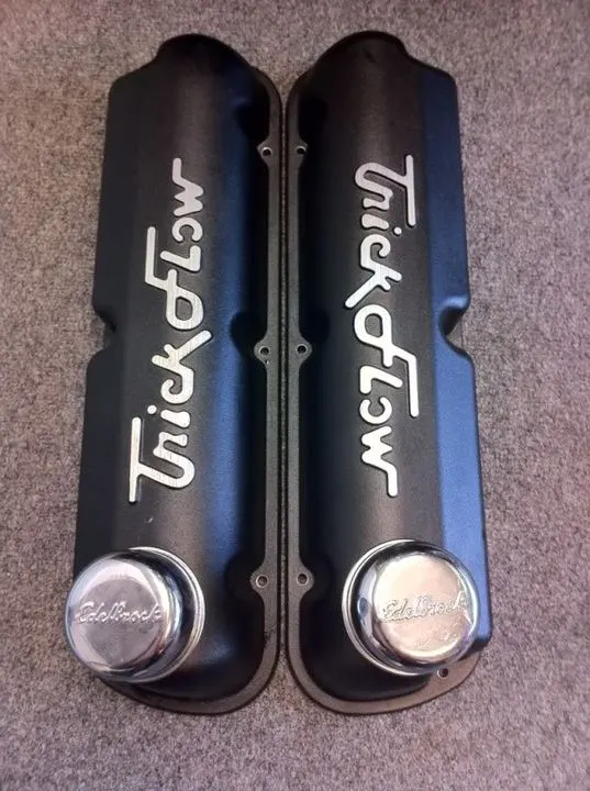

We've been through valve cover hell. We just removed the stamp steel AFM covers which use stock bolts in favor of TFS stud & nut covers. Hopefully these will fix our leak.
Either of these covers would work for you. On my 347 I used the AFM covers with no problem (cleared Scorpion 1.6 Stud Mount Rockers). Although these Aluminum TFS covers are really nice looking. Would love to polish these up.
