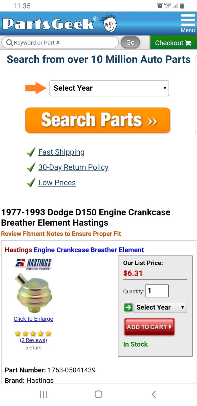

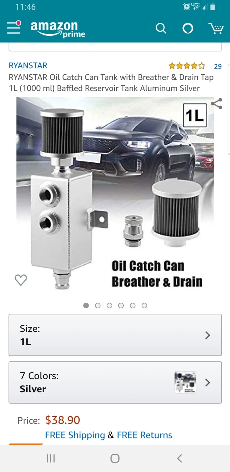

Get the valve covers with pre made and baffled oil holes...like trickflow. Use a mid 90s dodge truck breather. Run 5/8 hose from the valve cover to a cheap catch can mounted behind right front fender. Trickflow no longer has the ones I have in my car. Only the passenger side has a baffled hole.
This is the breather
Here's the breather tank
