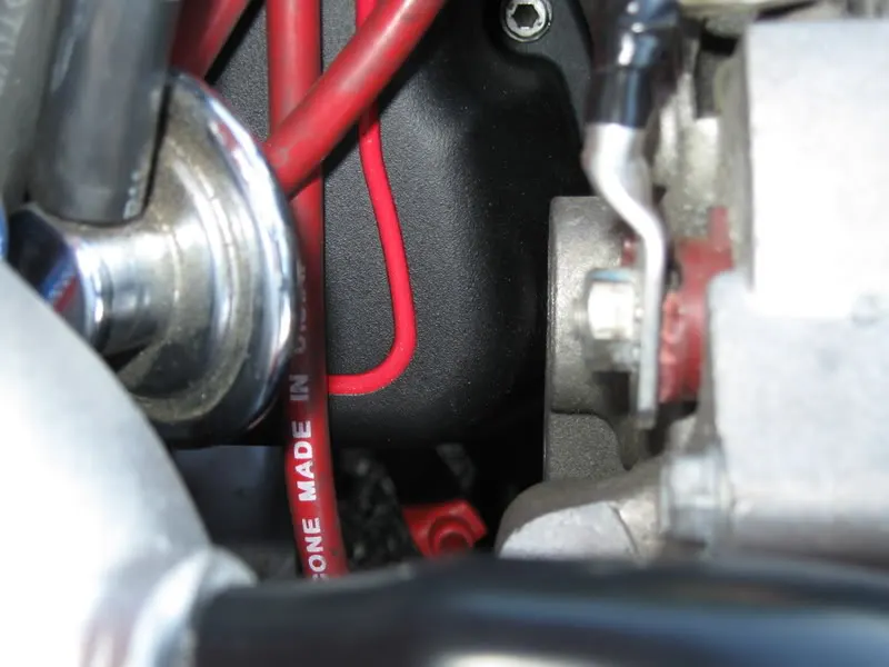

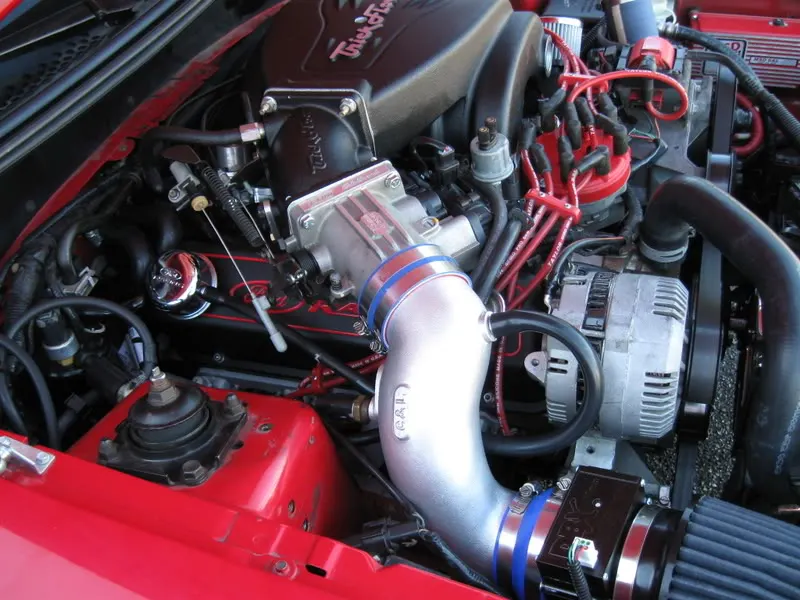

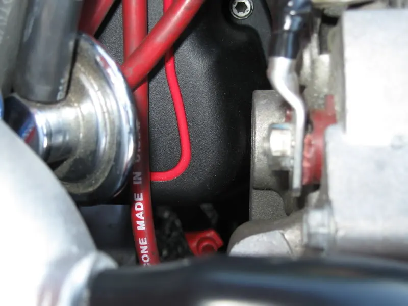

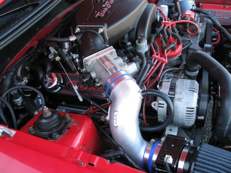

Will a track heat with a 3/8 spacer clear these "tall covers"
They will fit, on a 351W but not the 302
No Spacer.
Close Eh ?
