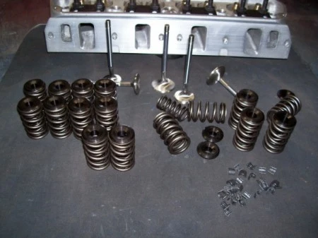

I have some drop in dual springs for your heads that will work great for the cam and 1.7's, and they will carry bigger lifts up to .600 if you decide to go bigger later... cool??
Just me..................................
Thumper
