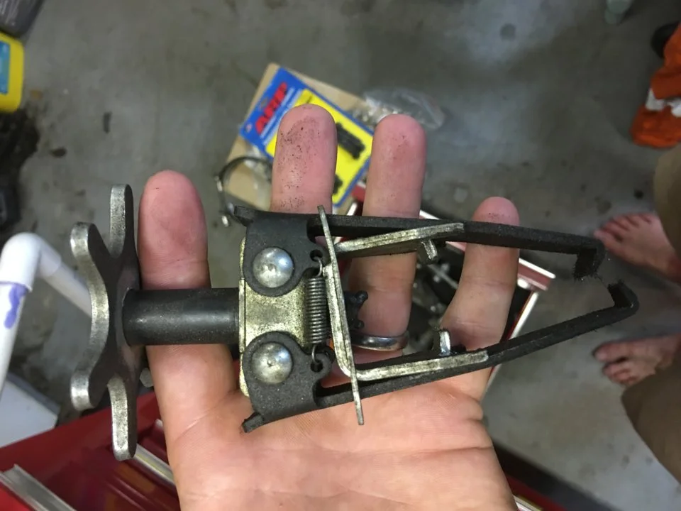

sen2two said:
What tool is this? I have an O'Reilly close by.
Boosted92LX
Dec 19, 2010
5,721
4,244
224
Apr 25, 2016
  • Apr 25, 2016
hoopty5.0 said:
That is a good one too, but it's been my experience it doesn't work too well with double valve springs, as it compresses the outer coil, but not the inner. Single springs, darn good tool.

Oh I thought he had single springs. Yeah, worthless on doubles.
To be fair, I don't think he specified.

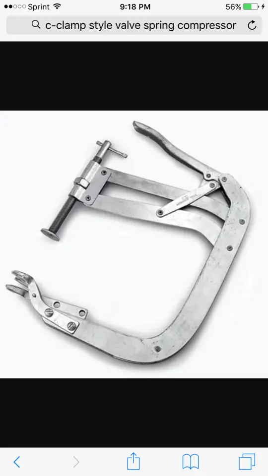

So..... I'm still at a loss on which one to purchase.
I wouldn't mind buying a used American made tool when they were built to last. In fact, I would prefer this.
Like I said in my first post, get a c clamp style. They look like this:
Lots of places sell them, and with dual springs, that's pretty much your only choice. As far as locating where to buy one, google is your friend.
