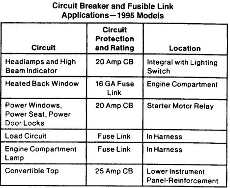

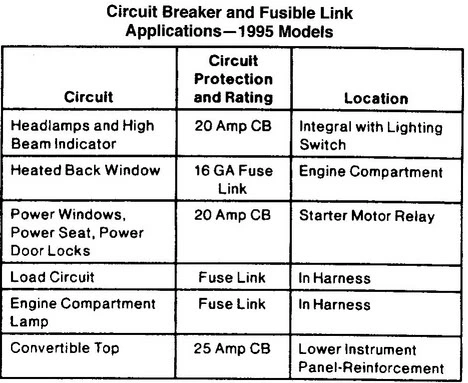

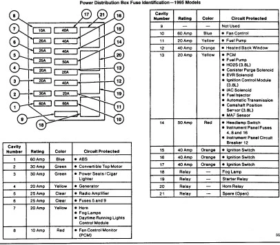

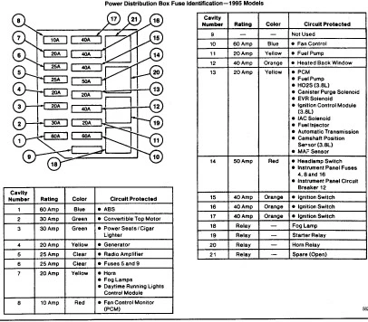

here is some more info that may help
ok while messing around
i pulled the fuse and jumpered it i went back inside and messed with something that i thought was the brake switch and when i pressed the button the top went down but now again the switch doesnt work.
