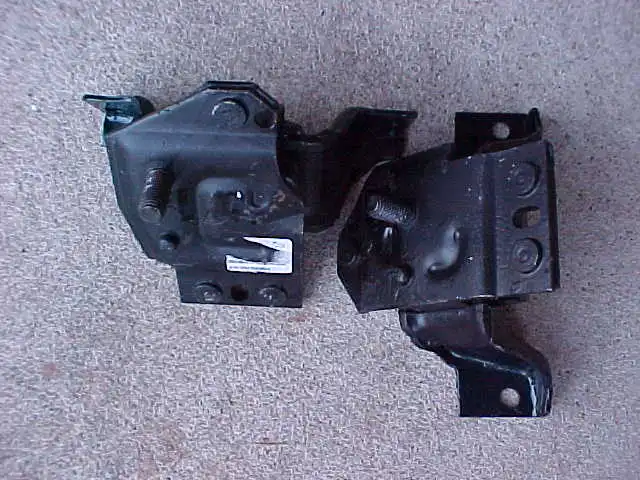

Go with the vert ones. They are built much better vs the others. The vert ones are a "captured" design where the metal of the chassis side part is wrapped around the motor side, with rubber in between, while the other styles are just joined by the rubber and can separate, especially the parts store ones. From what I've seen, the 90+ cars all had the vert mounts, but earlier ones had different ones. Also, they are said to lower the motor 1/2-1".
Pic from PPI:

The guy have you covered. Like Thomas noted, if you ask for mounts for a 93, you should get 'vert' mounts.
