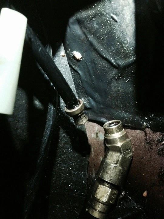

We discovered the point of leaking in the top lift system. I'ts a fitting connection in a line. I suspect this is a return line? Anyway the connection is loose enough it pulls apart without much effort. Can this be repaired by installing new o-ring or other simple method?
Looks like the line goes into the fitting and is then tightened down. I would take it apart and see if the line broke inside the fitting.
Yes, I will look closer. Maybe I can trim the line and put it back together. If not I'll try and find a ferrule coupler that fits the line. Something like this.
