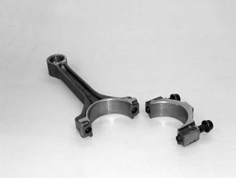

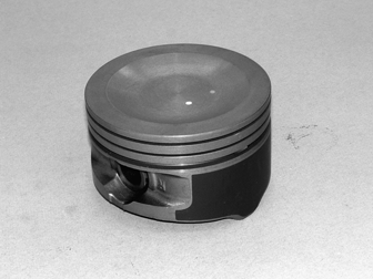

You can get roughly 400 rear wheel HP (which is ~460 crankshaft HP) from a stock PI bottom end with comparative safety. Some say 450rwHP is the safe upper limit but all one needs to do is take a look at a stock 2V piston and rod:
to know that such power levels are just asking for it.

If you're boosting more than 6-psi, yes. When you compress air it gets hot and hot intake air is more likely to promote detonation. Look at the picture of the stock, cast hypereutectic 2V piston earlier in this thread and notice how very thin the top of the piston is above the top ring. This lack of material and the brittle nature of hypereutectic pistons makes them very susceptible to damage from detonation.
This damage usually takes the form of a part of that area above the top ring actually snapping off.
Intercooling provides a level of security against this occuring by keeping IATs reasonable.
