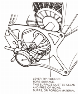

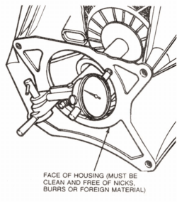

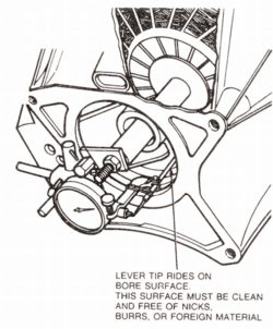

When you installed the clutch did you align the bell housing? Did you torque the flywheel properly?
Q.: How do I check bellhousing alignment?
A.: The first step is to check bellhousing face runout. You are checking for parallelism of the back of the bellhousing to the back of the block. Install the dial indicator (as shown fig.1). Rotate the crankshaft and mark down the reading. Be sure to push the crankshaft against the thrust bearing for an accurate reading. Maximum runout is .010.
The next step is checking bellhousing bore runout. You are checking to see if the bellhousing bore centerline is aligned with crankshaft centerline. Reposition the dial indicator in the bellhousing bore (as shown fig. 2). Rotate the crankshaft and mark down the readings. Maximum out of concentricity is .015. If the bore runout is out of spec. install appropriate offset dowels.

Due to production tolerances of engine blocks and bellhousings, it is possible for the transmission centerline and crankshaft centerline to be misaligned. Misalignment can cause transmission gear wear, transmission jumping out of gear, driveline vibration, clutch pedal vibration, pilot bearing noise, release bearing noise or excessive clutch spin time. It may also damage the pilot bearing, transmission mainshaft bearing and clutch hub. It will also cause harsh shifting.
Before installing the bellhousing, check the block mounting surface and bellhousing surfaces for nicks, dents, paint debris, etc. These are some things that could affect the accuracy of your measurements.

I guess I'll be pulling everything apart, the bell housing alignment is a bit confusing to me though, from what I gather it's saying to check the "flatness" of the bellhousing and of the block where the bellhousing bolts up to block?
