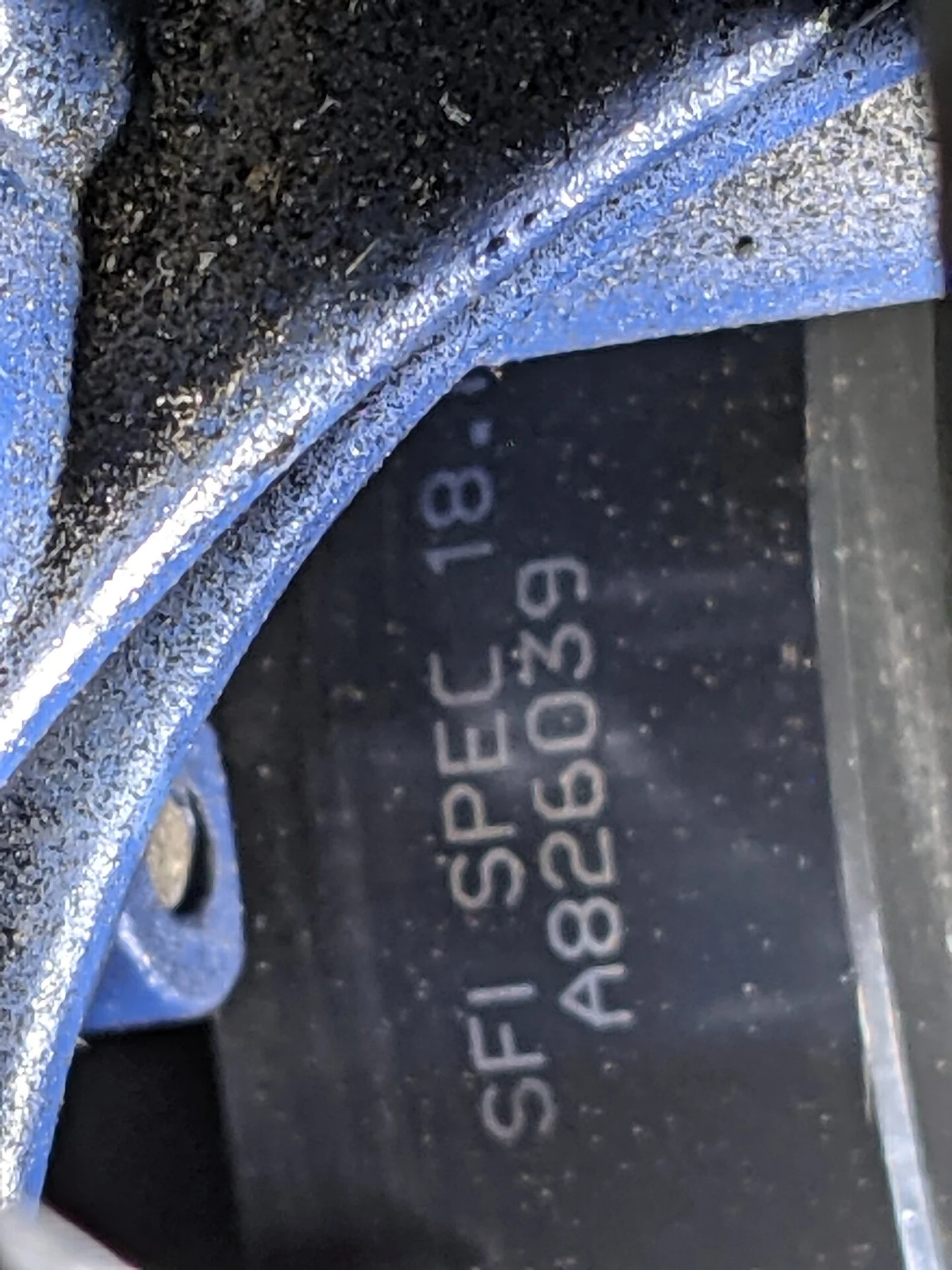

Here's some picture insight into the balancer. Just from a Google search it says this balancer is for internally balanced ?

Hey, let's do a little investing before tearing this thing apart,
Since you know little to nothing about the engine (verifiable facts) I would start with firing order, the HO firing order does not play well with a non HO cam. Engine vibration is a symptom.
I would start there.
I don't know what pre 94 means :shrug:
I mean I know it's 'before 1994' but the sbf (302) firing order changed with the 5.0 HO way before 1994,
The firing order you posted is for a non HO 5.0.
I would find out what the firing order your engine is supposed to use.

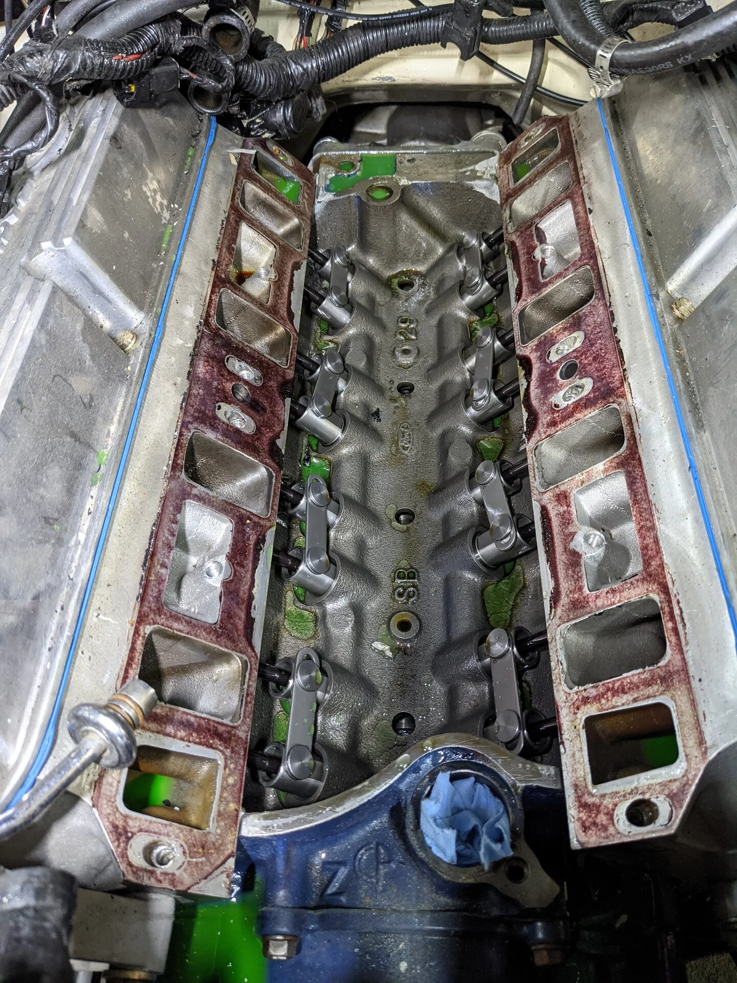

Hard to say if per day goes away because all that rpm the car is ripping and running. But it does it at a dead idle no clutch engaged and engaged. I'm guessing the flywheel as well. Car is as described, block, heads etc. Ripped it apart as I had a brand new trick flow intake to go on.
