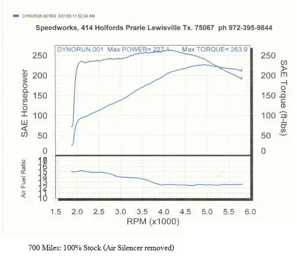

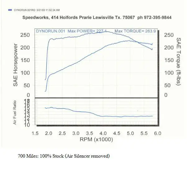

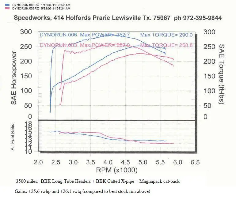

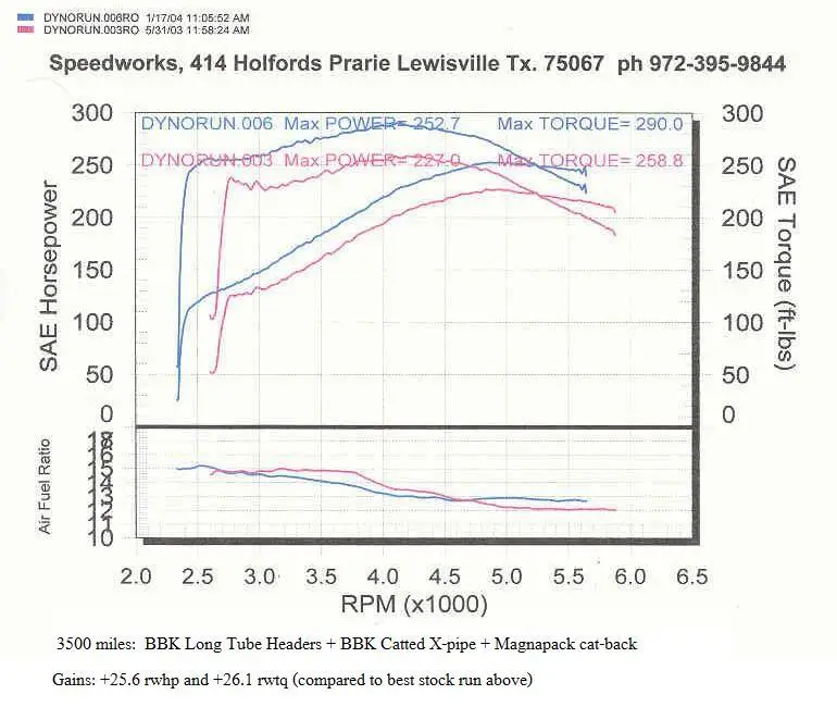

Did you notice a power gain from the longtubes?
Definitely, it was my second mod to the stang (1st was tri-ax). I installed the set-up back in 2004, here are some dyno graphs:
