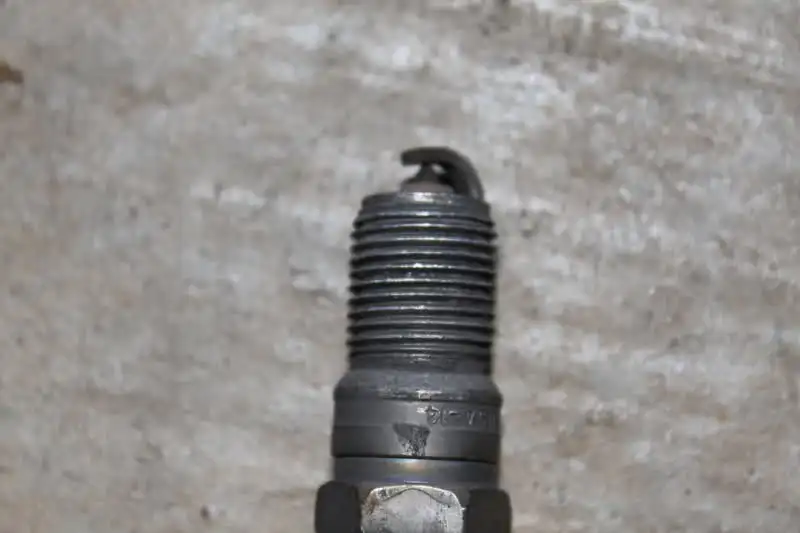

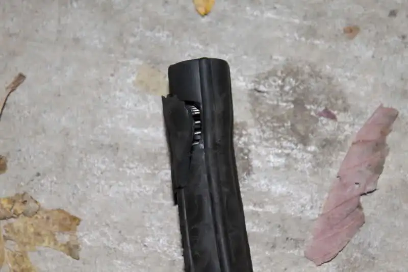

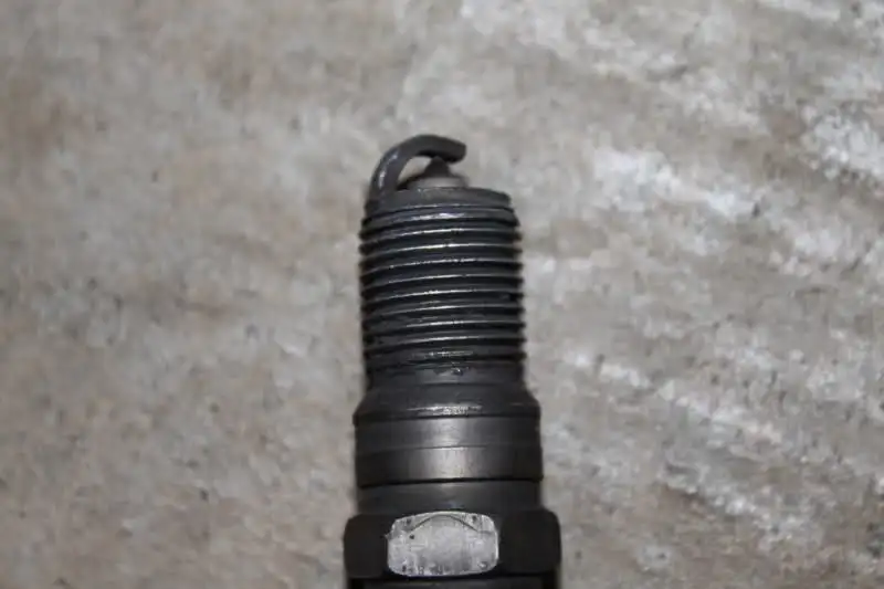

Alright..I blew a plug. The threads on the plug seem to be okay still so hopefully the head is good. It was only a little loose in the head.
