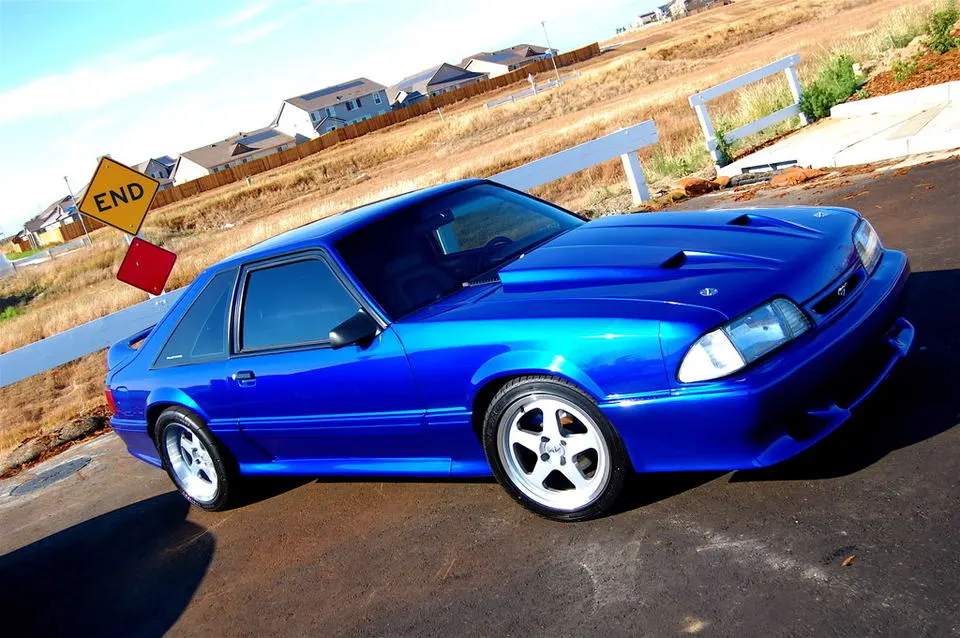

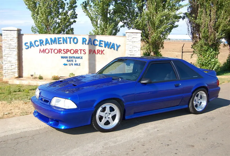

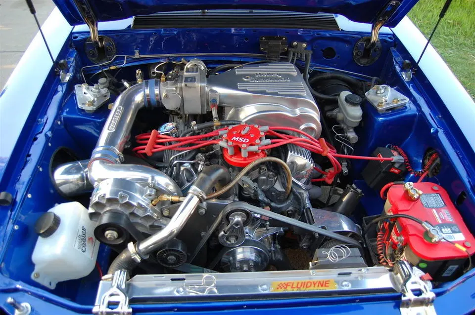

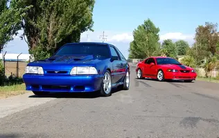

Here are a couple vids of my Buddy Matt's blown 88 GT running 10.09 @ 139mph.... This car is one of the most impressive Fox's in the country IMO because he runs those times with a Tremec 5 speed, a home built H/C/I 306ci with a stock block, & an S trim. He doesnt even power shift either, but if he did his car wouldve already ran 9's...This car has never even seen a dyno....
Watch how hard he launches on the 500rwhp Torch red 03 Cobra....Sorry the vid quality isn't the best, but u get the picture....
YouTube - sac raceway2.AVI
YouTube - sac raceway4.AVI

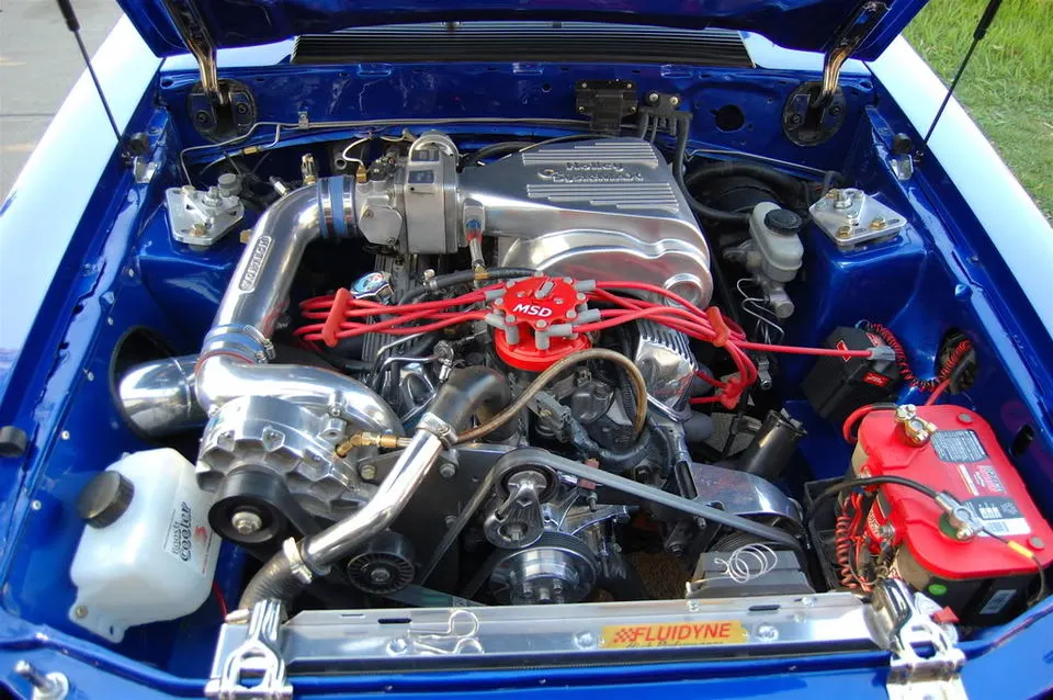

=Engine combo:
-Stock block 306 (with forged internals) 9:1 Compression
-AFR 185's (home ported)
-Hi Tech custom blower cam
-Holley systemax manifold
-Hooker 1 3/4 LT's
-Custom X pipe
-Dynomax Ultra Flow custom catback
-Vortech S trim (cant remember how much boost??)
-AFM power pipe
-SCT air meter
-Snow performance Methanol kit
-Bob Kurgan mail order tune

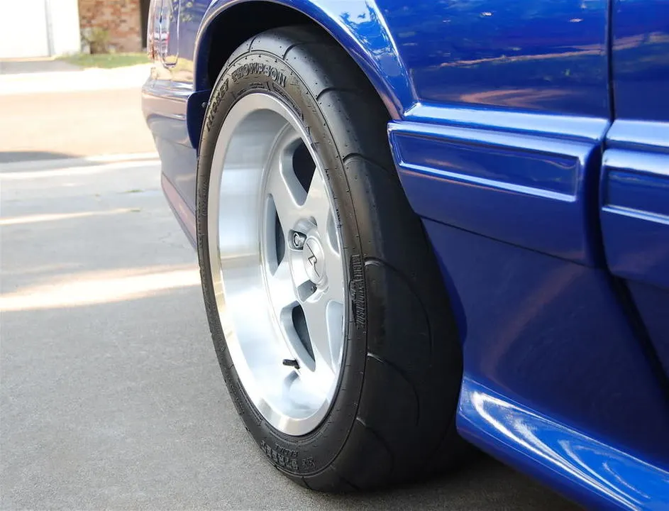

=Suspension:
Front=
-PA racing tubular K member & A arms
-Afco front coilovers
-Lakewoods struts
Rear=
-Baseline rear upper control arms & anti roll bar
-Maximum Motorsports adjustable lower control arms
-cut stock springs
-MT full slicks
That car has to be one of my favorites.
It more or less shows a perfect example of why fox bodies are great cars. Fast, clean, and one amazing street car.
His should be a great example of simple parts running great numbers!

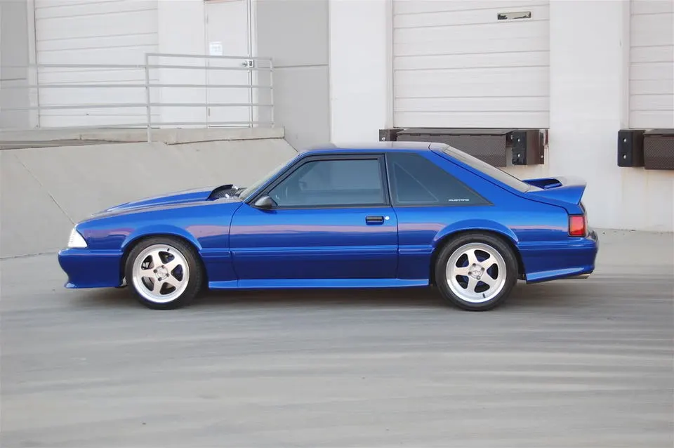

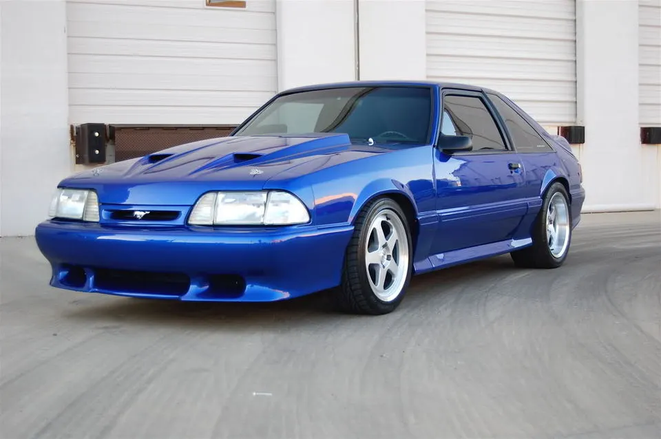

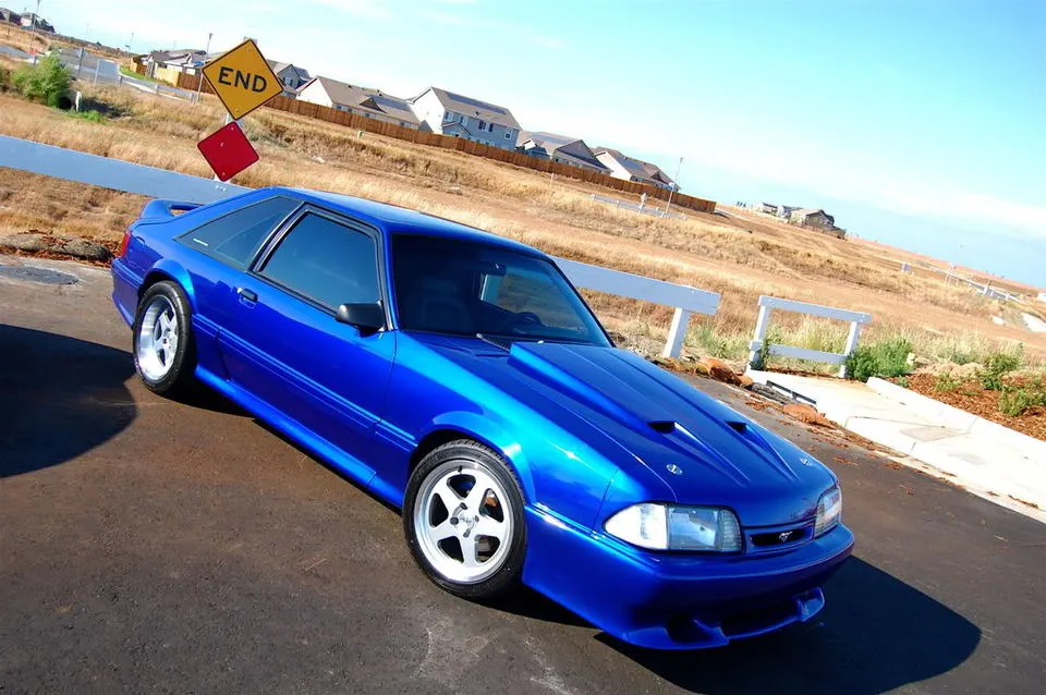

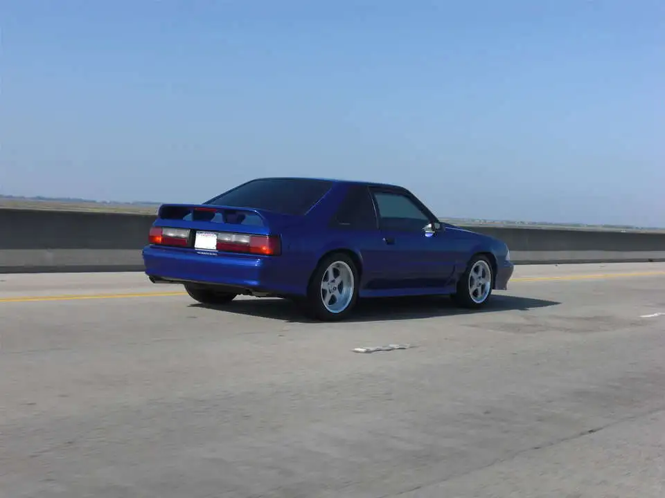

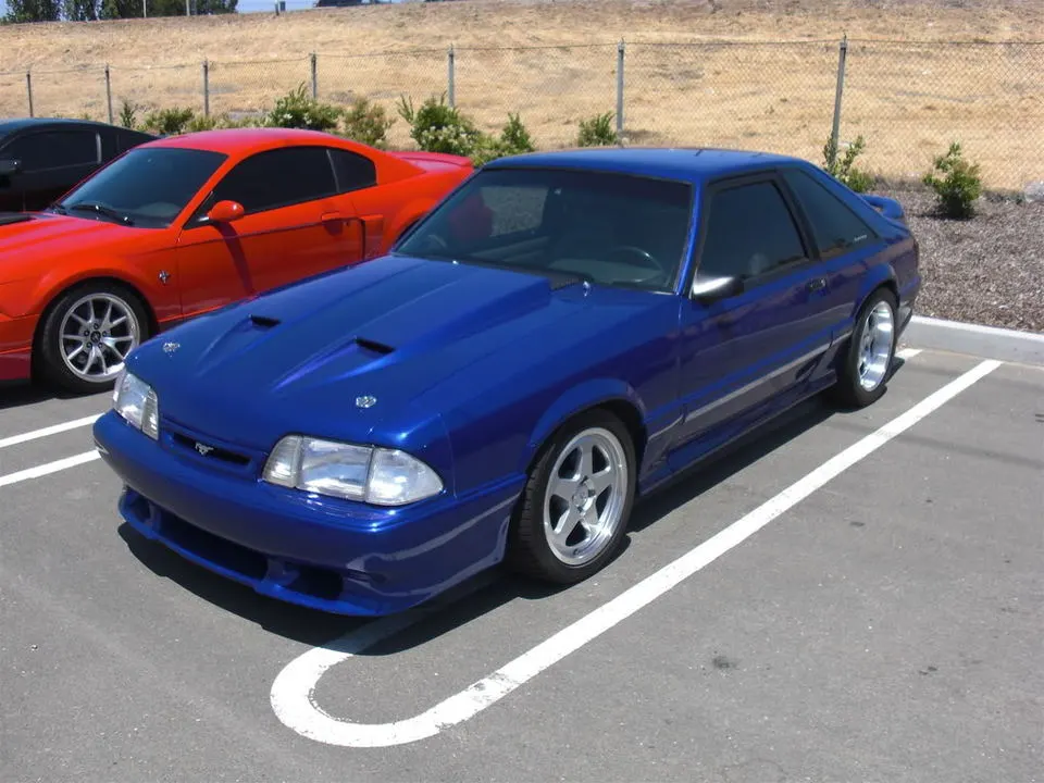

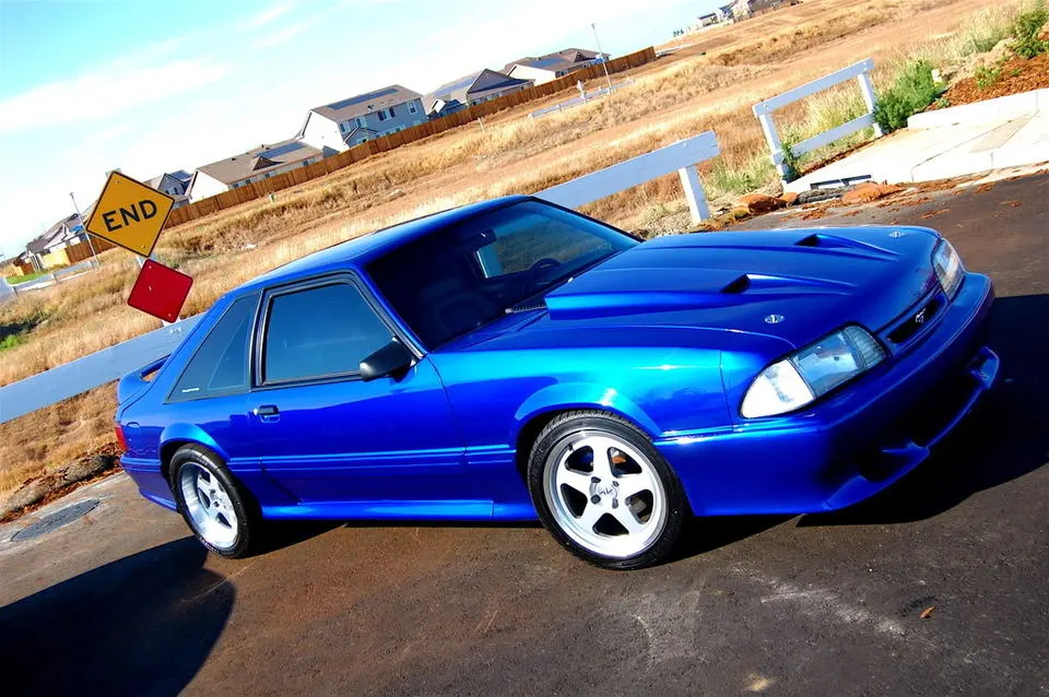

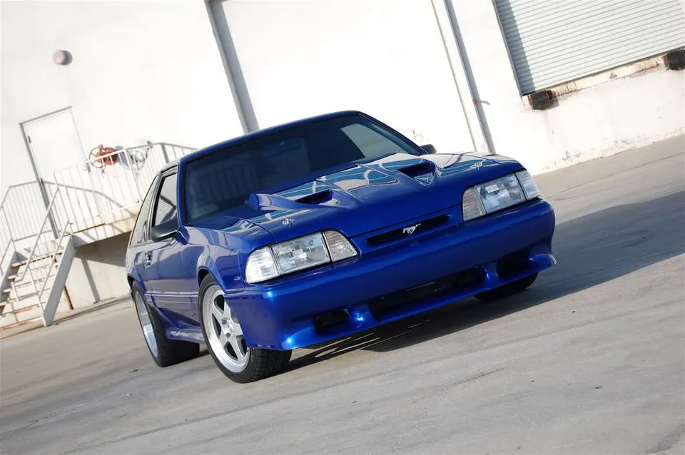

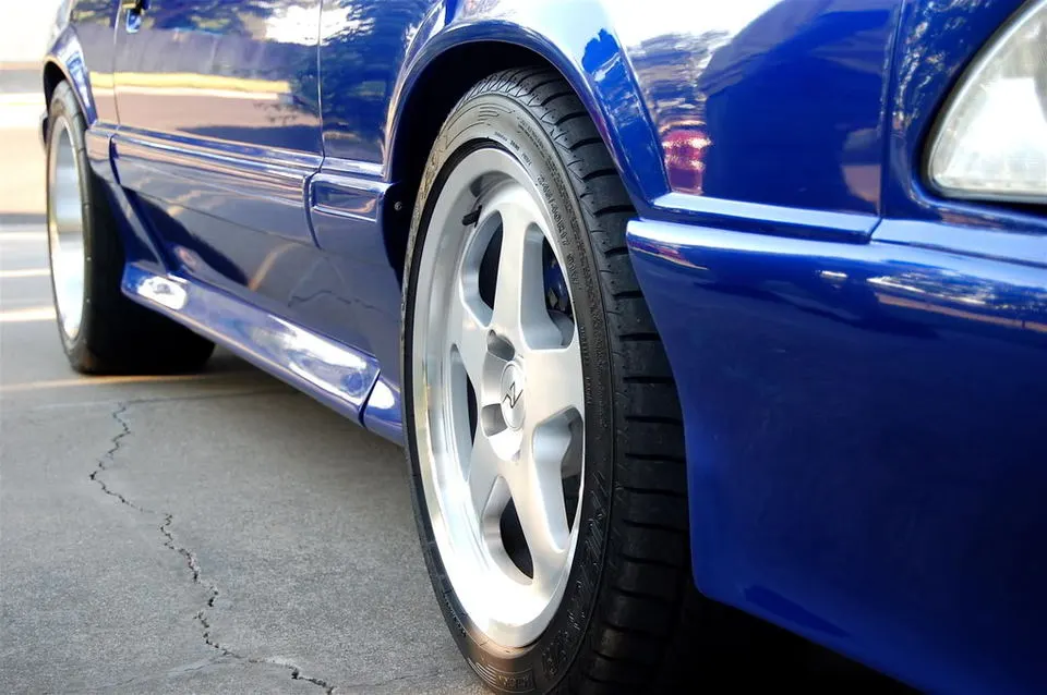

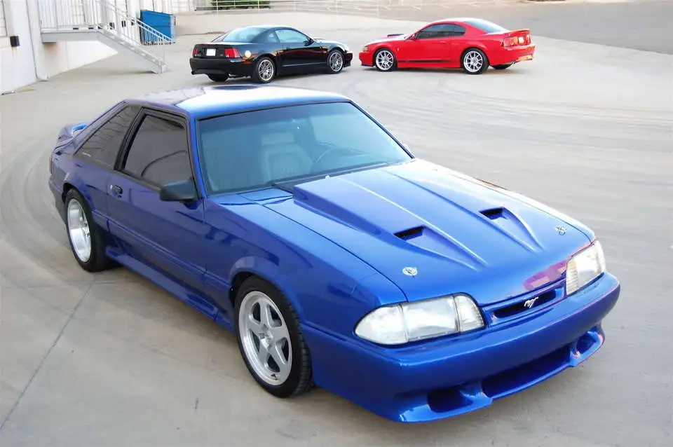

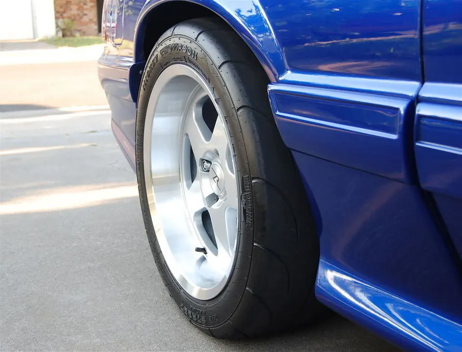

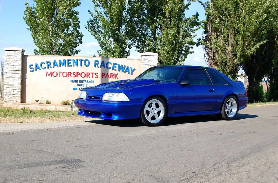

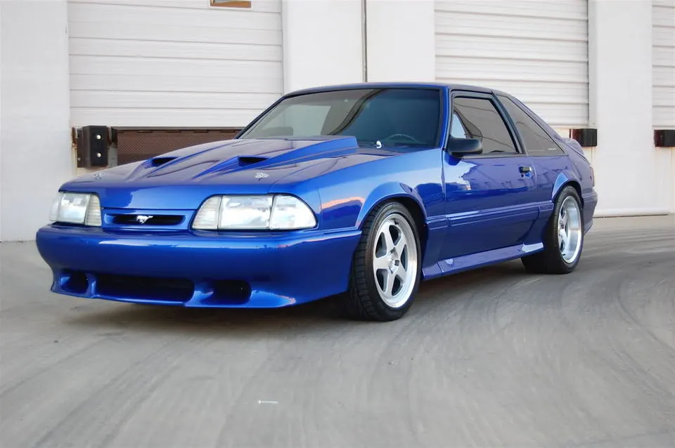

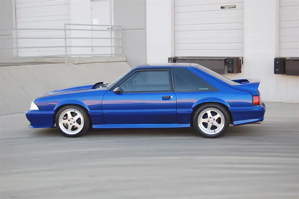

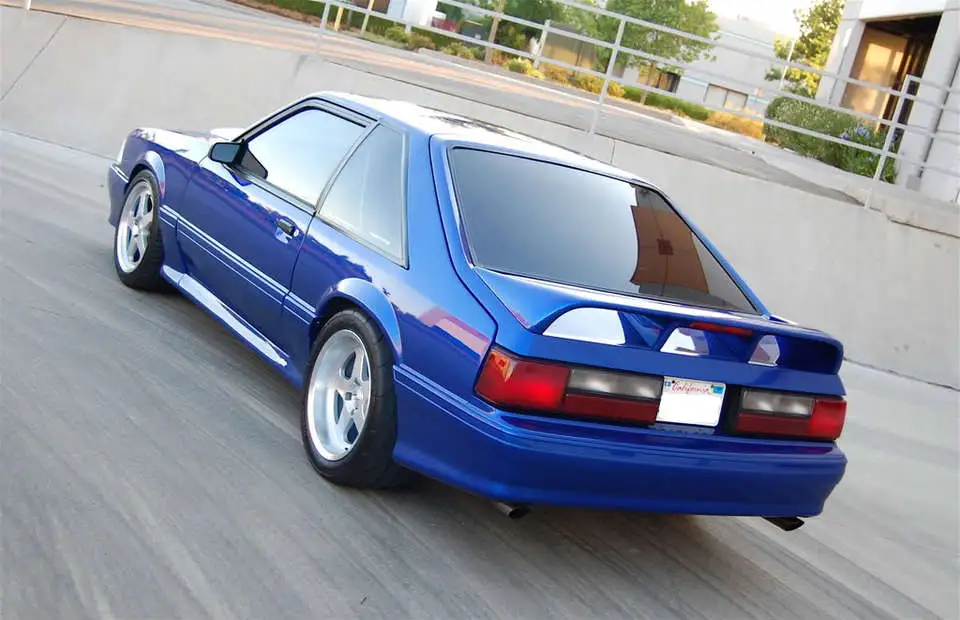

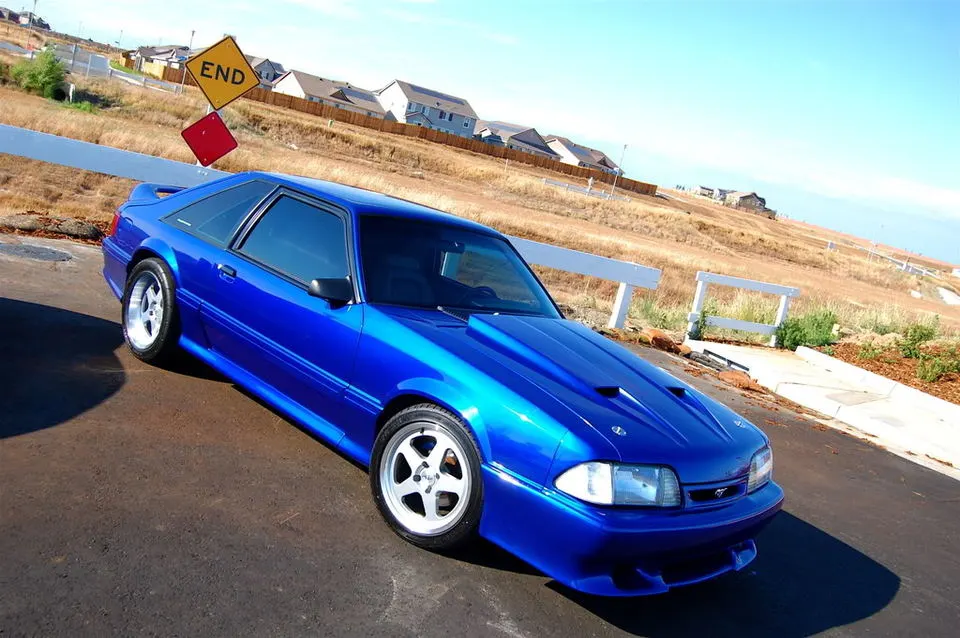

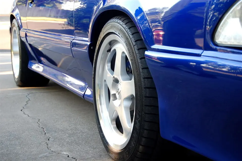

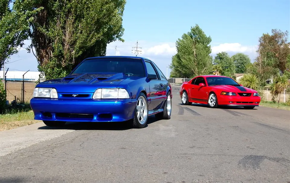

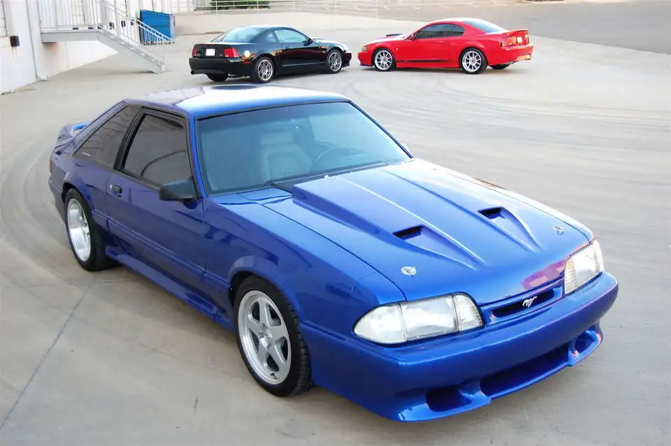

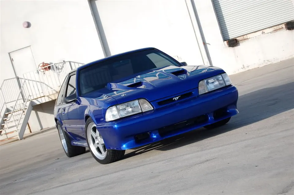

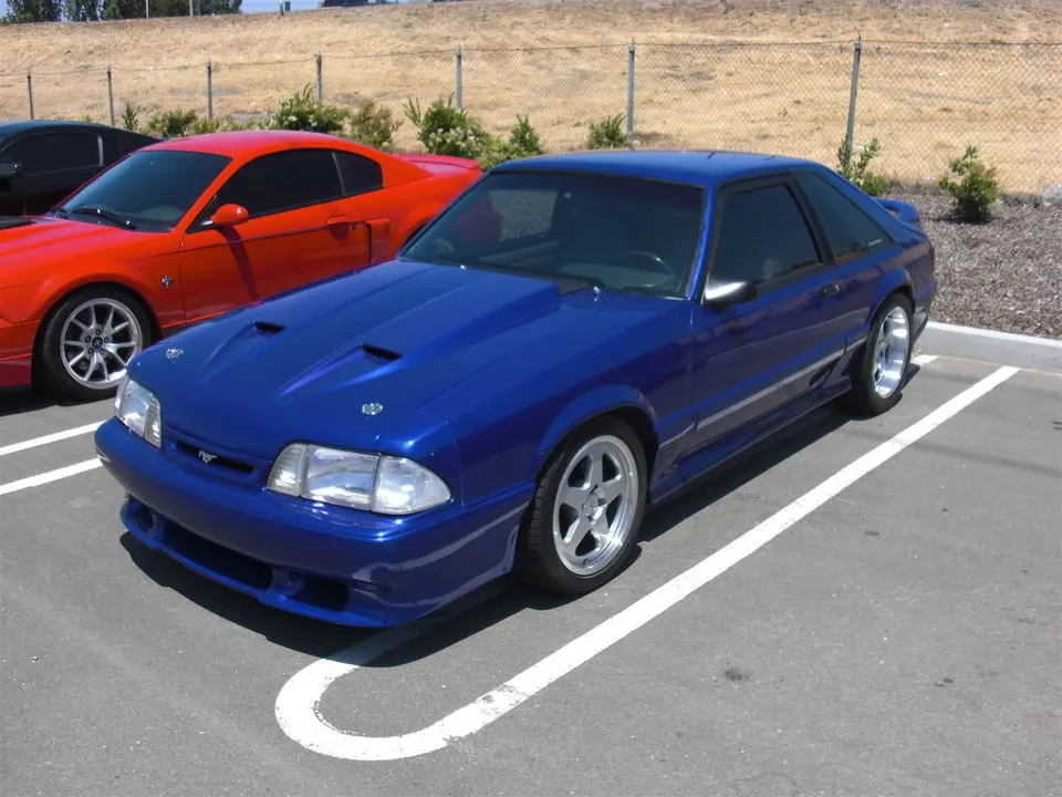

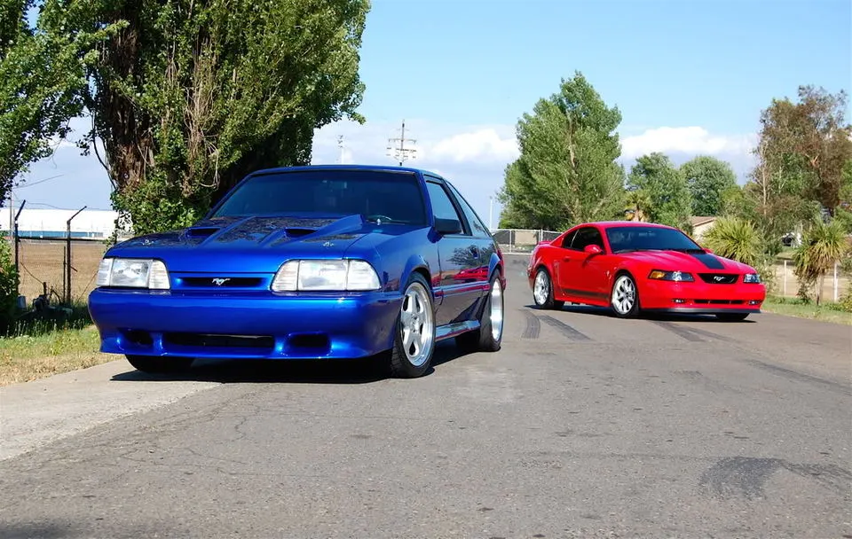

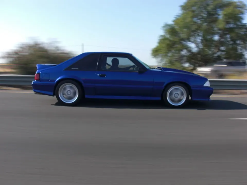

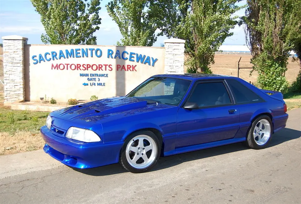

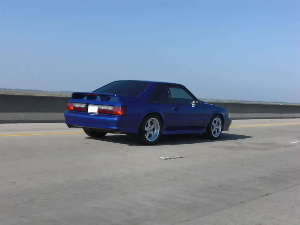

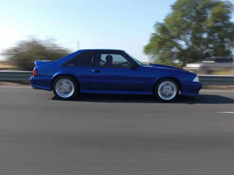

Here are More vids & pics....
No BS, that is the setup, no surprises... Its just built good, tuned good, & driven good....
A$$ in seat time makes a huge difference & he has plenty of it....300+ passes at Sac raceway...

Weight savings helps alot too. The car weighs 3,050lbs in race trim (slicks, skinny's, rear seat & passenger seat removed) plus the tubular k member dropped some major poundage...
His AFR's are ported too & everything on the car is port matched even the headers, so all of this contributes to the way the car runs.... Driver mod means alot though like I said before. Listen to his shifts, they are damn good....
