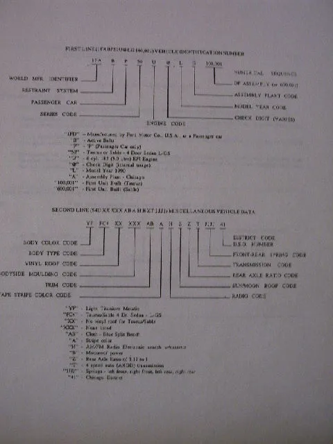

The book I have said the 9th digit is called check digit (internal usage). I don't know what that means. Here is a picture of the page, I hope you can read it...This book is only good for 1980-1995.
