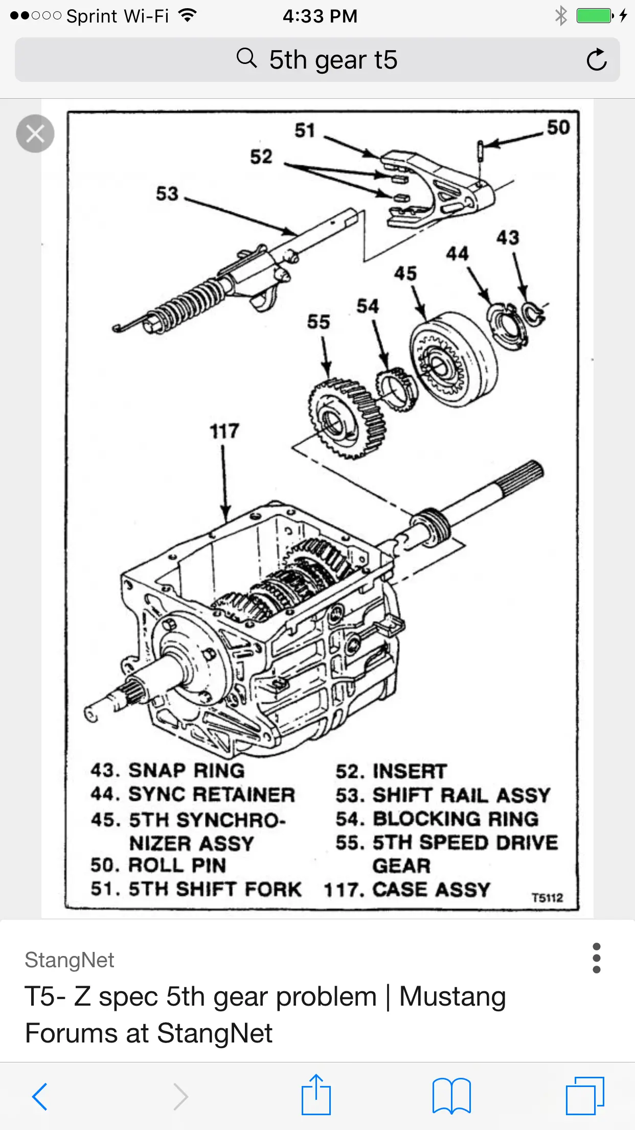

5th and reverse are separate inside the T5. Reverse uses an idler gear that engages the 1-2 slider and countergear inside the case. 5th gear is outside the case in the tailshaft.
I wonder if the 5th drive/driven gears have sustained some sort of damage or missing a tooth or two? Is the bucking directly related to the noise? Feel/hear at the same time?
