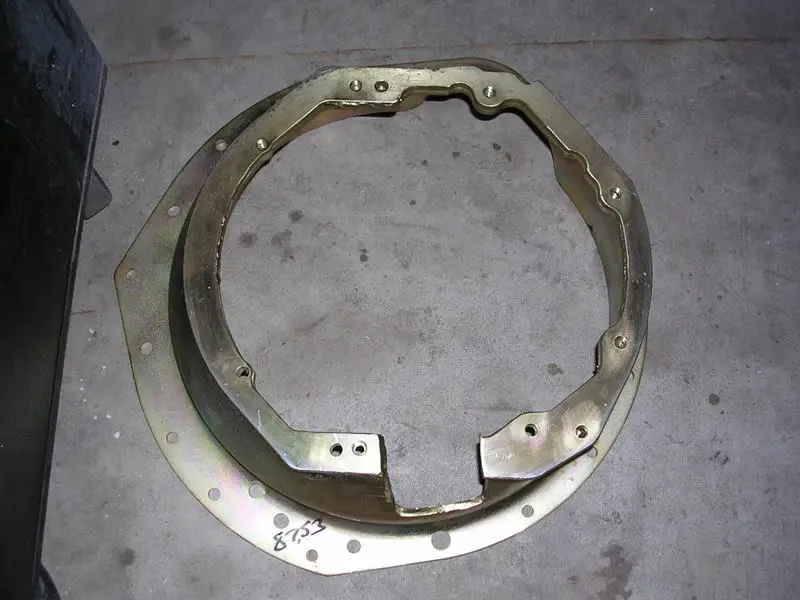

From what I could tell, all T56 bellhsougs are interchangeable among the different Ford and GM T56's, although that is not what I was told. The adapter plate I had bolt to both the LT1 T56 and the Cobra T56 as did the Mcleod scattershield bell.

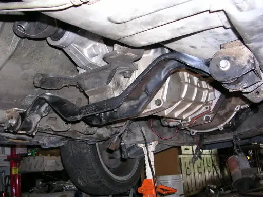

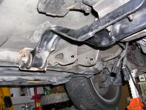

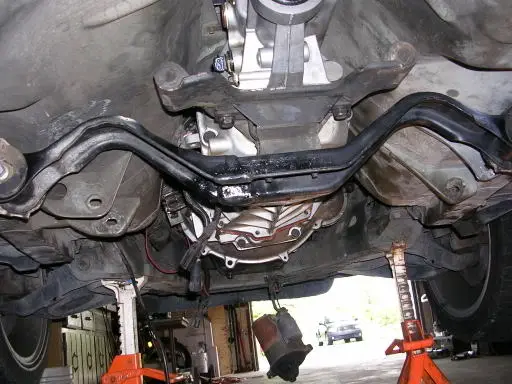

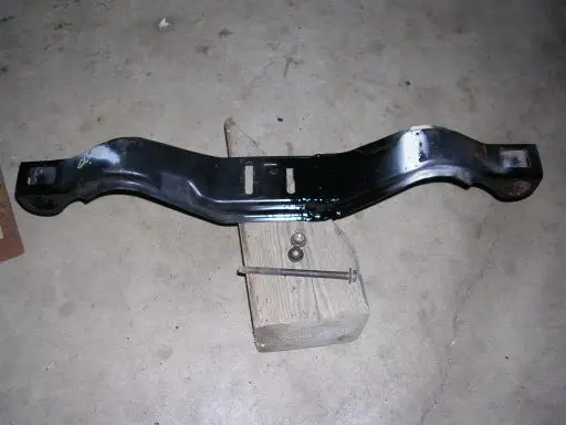

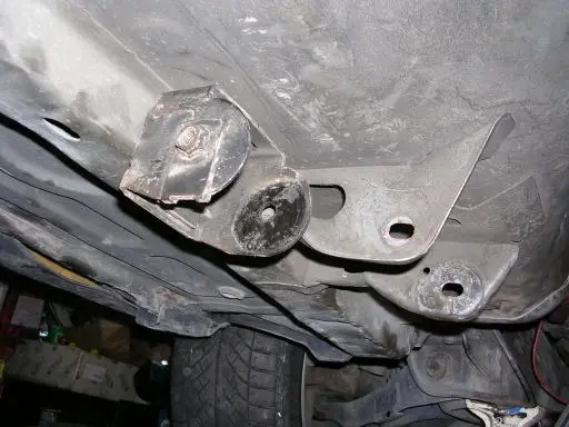

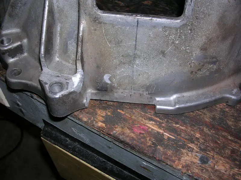

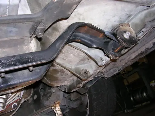

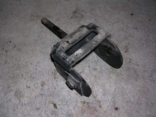

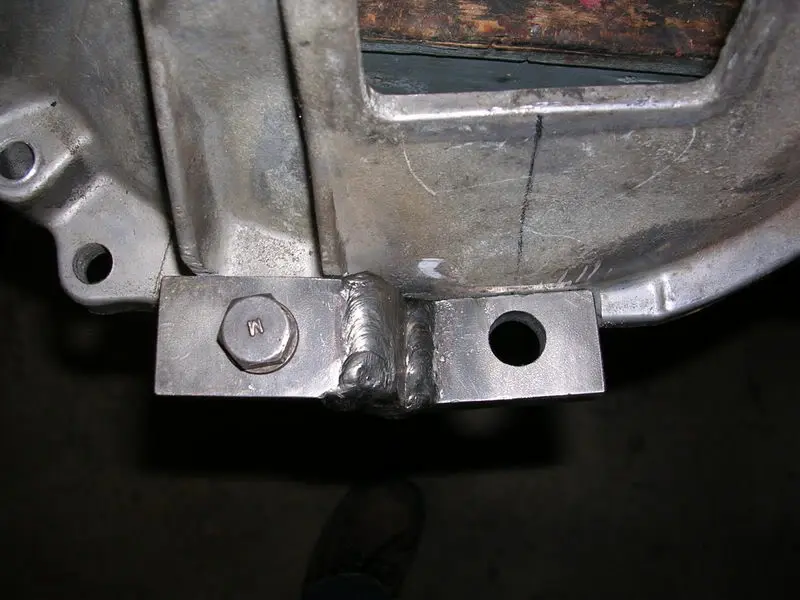

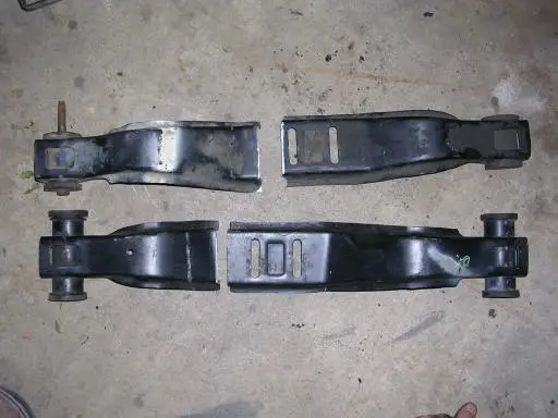

As for the crossmember and mounts, I did a little bit of fabrication. Where the crossmember needs to mount with a T56 is about 4" further back than the stock mounts which are spotwelded on. So I used 4 cylinder Mustang crossmember mounts, which have a single bolt that go through the frame, so I just drilled some holes for them. But then the V8 crossmember was not wide enough to fit, so I got an extra V8 crossmember from the junkyard and cut both of them both and welded them back together at the right length.

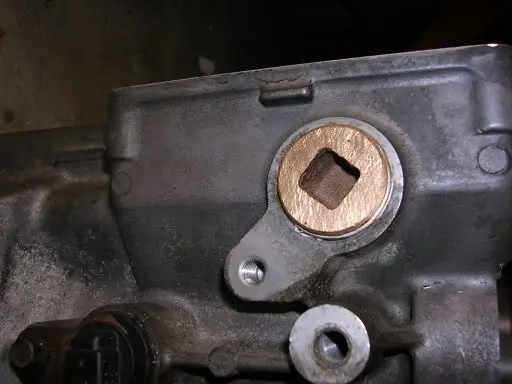

A lot of people don't know what to do with the reverse lockout cylinoid, but I just took it off and put a plut in it. It's pretty much impossible to put the tranny in reverse while driving.

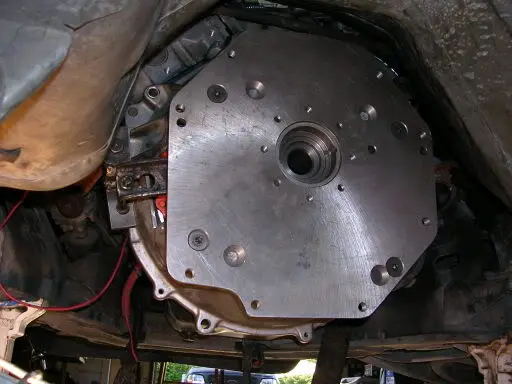

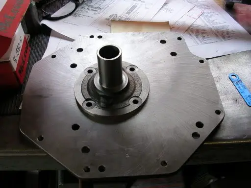

Adapter plate

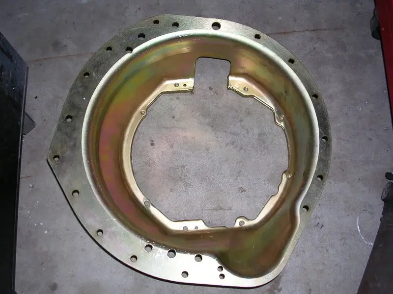

McLeod Scattershield

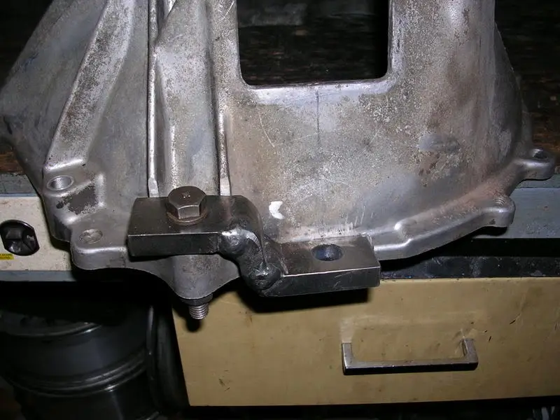

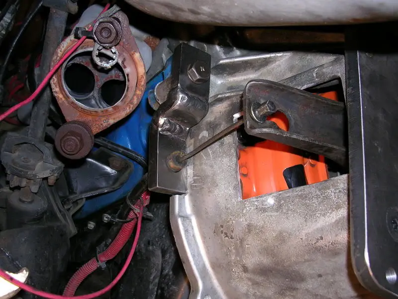

Modifications done to the TopLoader bellhousing to allow for the clutch cable.
Reverse solynoid deleted
Crossmember modifications and 4 cylinder crossmember mounts

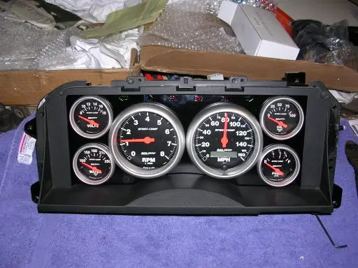

What I decided to do myself was just convert to an elctronic speedometer. I bought an MC Machine guage panel and did all Autometer guages, which cost me about $400. I thought I'd just invest the money that way in getting a little aesthetic looks as well.

I don't have any pics of it in the car, but I could take some tomorrow and post them up. I saw some pictures over or Corral of guys guauges with the MC Machine panel and I just fell in love with it and had to do it exactly like he did. I got my MC Machine panel for $50 (instead of the regular $150) because he only had slightly damaged plates left. It was just barely scratched in a few places on the front, but I painted mine black anyways so you can't even see it. If I would have done it over I would have had it annodized black though So if you order from him, maybe ask him if he has any discounted damaged plates, although he was a little reluctant to sell it to me.
