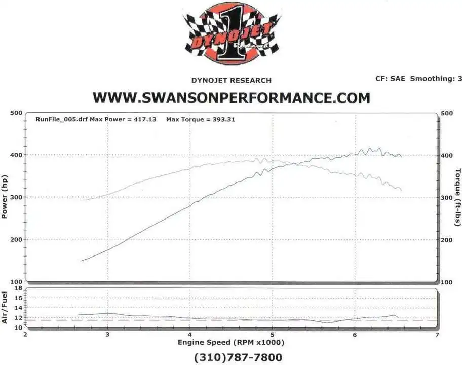

I am VERY pleased with my dyno results. I had the car tuned by Danny Swanson in Torrance, CA. I would highly recommend him to any people in Cali. My car put out 417.13 HP and 393.31 TQ!! This is with my Vortech v1 (stock pulley), custom front mount intercooler, and AFM powerpipe. I also have a X pipe and 3.73 gears. I frucking LOVE the power :D . Now it's time for some new street tires and suspension. I'll post the dyno sheet as soon as I get my hands on a scanner.
The sheet :nice:
Reichard Racing is RR pulley. Good numbers, but your A/F is pretty damn lean. Not exactly something I would have let him tune to and just walk away and say have a great day lol. Most "safe" blower tunes for stock bottom end 2vs like to be kept around 11.4-11.8, for longevities take. If the tune is unlocked and you have an xcal 2 I would just add 2% fuel up top.

I thgink if you'll look again benny you'll see it dips below 12:1 @ about 3800rpm and stays there for the rest of the pull. looks good to me, but hell I blow engines like a 2nd rate hooker on payday.:lol:
I agree it is slightly lean past 6k rpm, but I'm not going to take the engine that high anyway. How can I use the Xcal2 to add more fuel?

Basically I just said that I would keep the RPMs to no more than 6K and that it looked a bit lean up top because you were running out of fuel pump.
Tim at MPH was worried about mine going lean as the fuel pump ages, and mine never got above 11.8-1 @ 6200...maxed the pump out also.

It's just all together lean up top. The car is intercooled so that helps keep IAT's down and reduce the chances detonation...but still it's lean. For the longevity of the motor, I would add some fuel. But yeah, there was no reason for them to rev it that high, you were probably floating a valve, thats why it looks all choppy LOL.
To add fuel with the xcal, go to load the tune, pick your custom tune the tuner put on there, then select "select optimized parameters?" by hitting the select button, scroll down to the fuel setting, change it to +2%.
I have no doubt the car runs great, and pulls hard. Good power + stock bottom end 2v + lean AT ALL = time for a new shortblock :p As long as you set the rev limiter to something reasonable, like 6000, it will be fine. Just watchin out man, don't wanna hear about no blown *in the bad way* motors :flag:

Yea I had the same thing posted on modular fords lol. I'm not sure what timing I'm running to be honest.
I'll try adding some more fuel with the xcal2 tomorrow.
Yea, you seriously have that thing tuned to the max to be putting down 400+ with your mods. I have more boltons than you just lacking the FMIC and I'm only putting down around 370 with Tim's tune. If it's not your DD, by all means, romp on it if you don't mind poping something. Otherwise, maybe look into taming the beast a bit. :nice:
