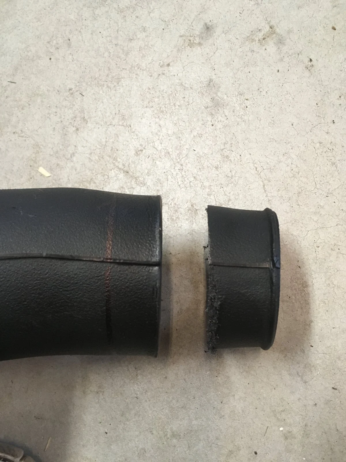

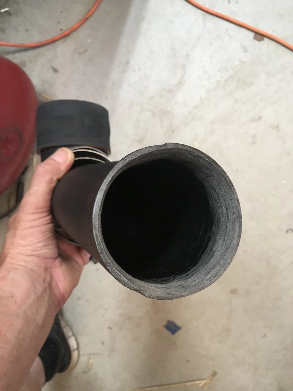

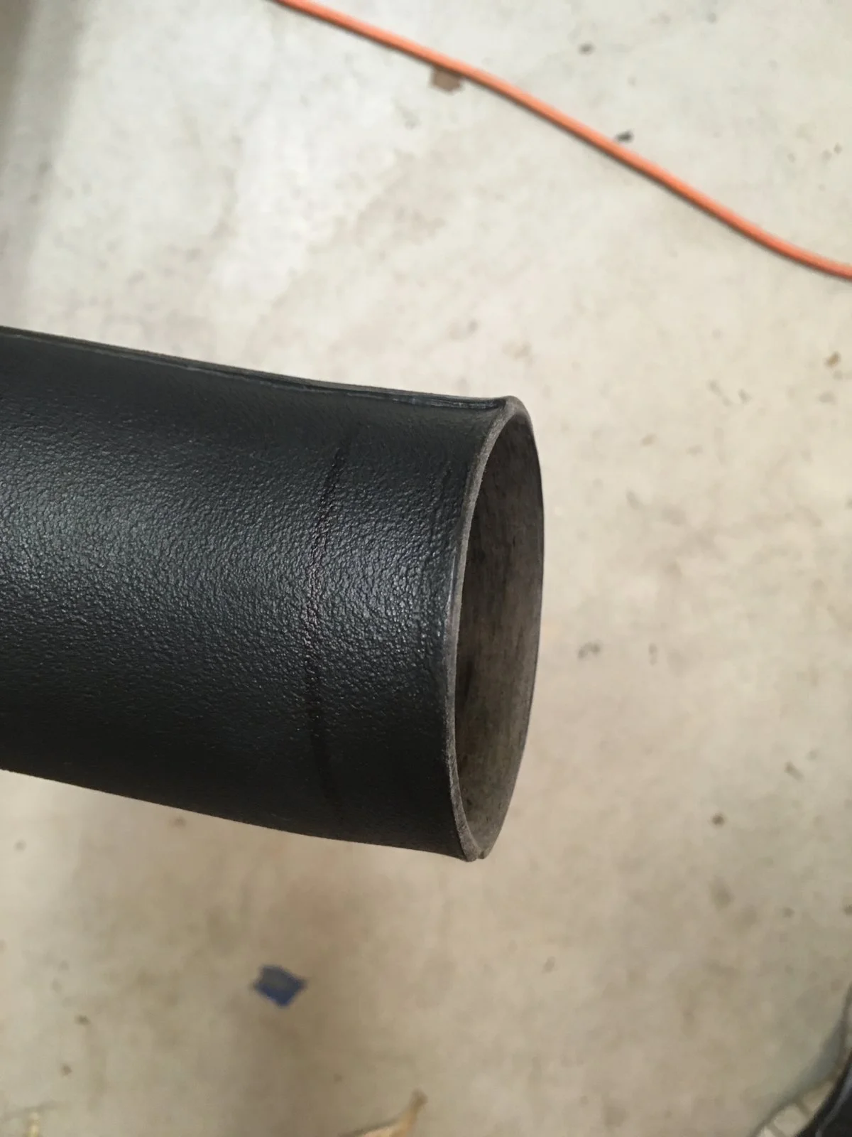

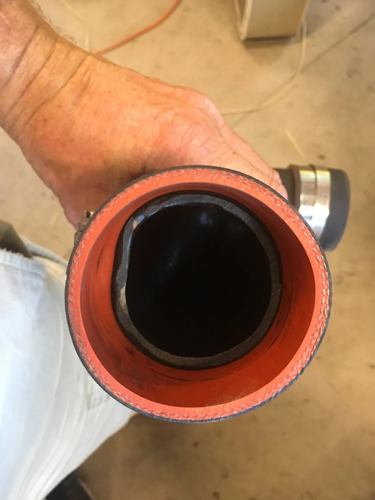

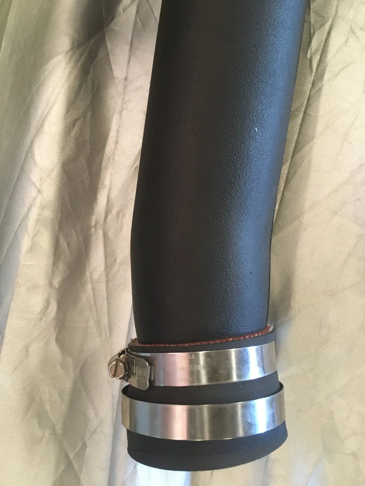

The pipe being deformed from the factory was a slight bottle neck. I fixed it. There is certainly no bottle neck anymore. Heres the pics.
I cut off about 1"
I heated the end with a MAP torch just enough to make it pliable in order to form a slight flare to help the clamp hold on.
I used a dremel with a sanding wheel to taper the inner transition.
