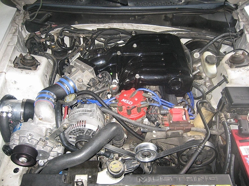

Here's the clocking you want on your blower:
