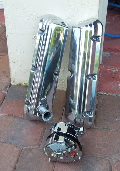

This is what they looked like before they went on the car. But like I said now they need some buffing out with Tripoli and rouge.

they wont fit with adjuster roller rockers. I just went through this and there was no way they were going to clear my Scorpion adjustable rockers....it's not the body that causes the clearance issue, its the poly lock on the stud. it still would have needed some grinding to clear the alt and I just went with the Moroso fab covers designed for the 94-95 . good luck.
Im not worried about the rockers as I still have stock rocker arms. You are saying they did not clear the alternator without grinding them down?
