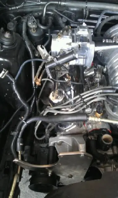

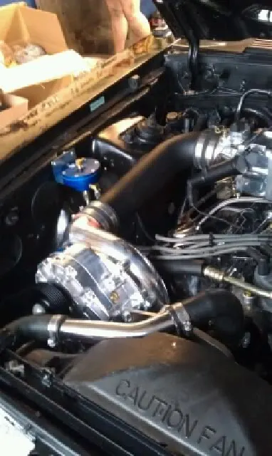

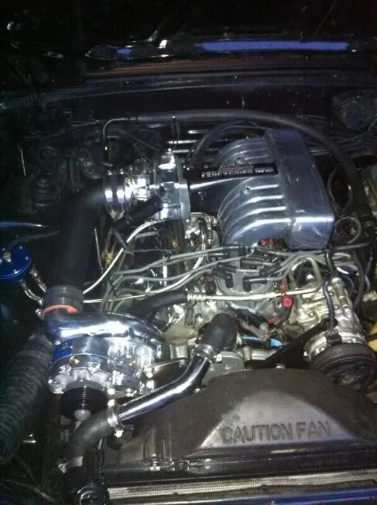

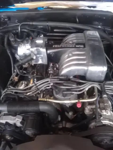

Well we are finishing the Vortech install and installing the stock belt but it doesn't fit at all, like a fee inches off. We bought the kit brand new and used the supplied crank pulley, tensioner, etc.
Can someone let me know a part number or size of the belt you're using? Vortech says the kit works with the stock belt but no dice.
Some pics of the install.

Just remember 1/2 inch makes a huge difference, can you post up a pic of how close your belt is to going on?
