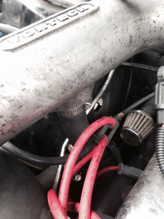

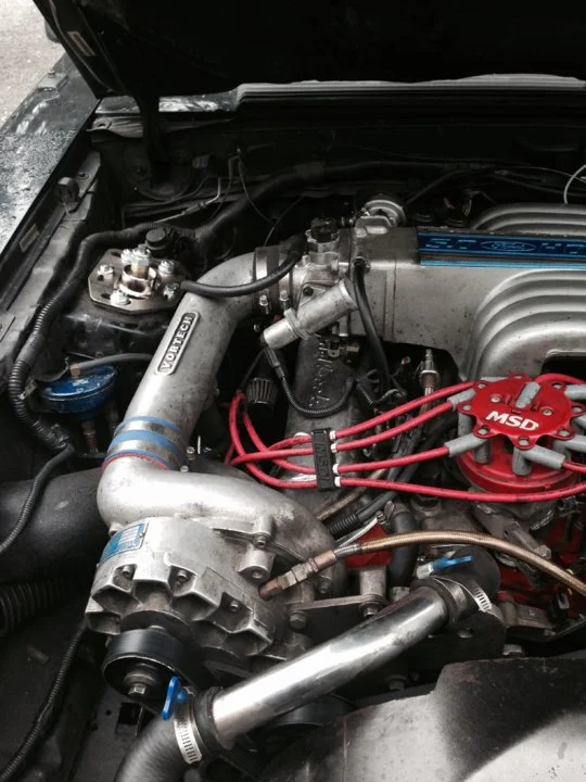

I believe I have the bypass valve. I am going to upload a couple pics of what I think the bypass valve is and a pic of the setup. I dont know a lot about it. It just looks like they used everthing necessary. Because when I search the vortech site i dont see any parts that it doesnt already have
Here is a pic of what i think the bypass valve is. Please let me know if this is not it so I know what I am looking at lol.

Looks to have a bypass valve so you should be good in that aspect. A few things to think about, custom tuning and removing the fmu if/when you put a new top end on the car (I saw another past asking about the TFS top end?) also as a maintenance item, remove the oil line and the nozzle to check for any debris and clean it thoroughly. The majority of failures that I have seen over the years have been due to clogged oil nozzles.

Ok. So I called vortech and was talking to a tech about my setup. And what we talked about here. He said there is something else going on because the supercharger should be giving me 11 psi or so with my pulley setup. Said belt slippage or the bypass valve maybe? Idk. Lost again
Looks like in the pics that you're still running a 6 rib blower belt on that sc-trim with a reeeeal small upper pulley. That's where your problem is. Your loosing boost because of belt slip.
You need to upgrade to an 8 rib pulley combo. I had an sc-trim on my Saleen and saw 11 psi with an 8rib 2.95"-6.87" pulley settup.
I have a thought with the low boost, other than the probable slippage that is happening. How do you know this is an Sc-trim? It "looks" like it's been on there for a while, could be an A-trim? You'd have to remove the coupler on the inlet to tell but it's a possibility as they don't make much boost. Just a thought.
