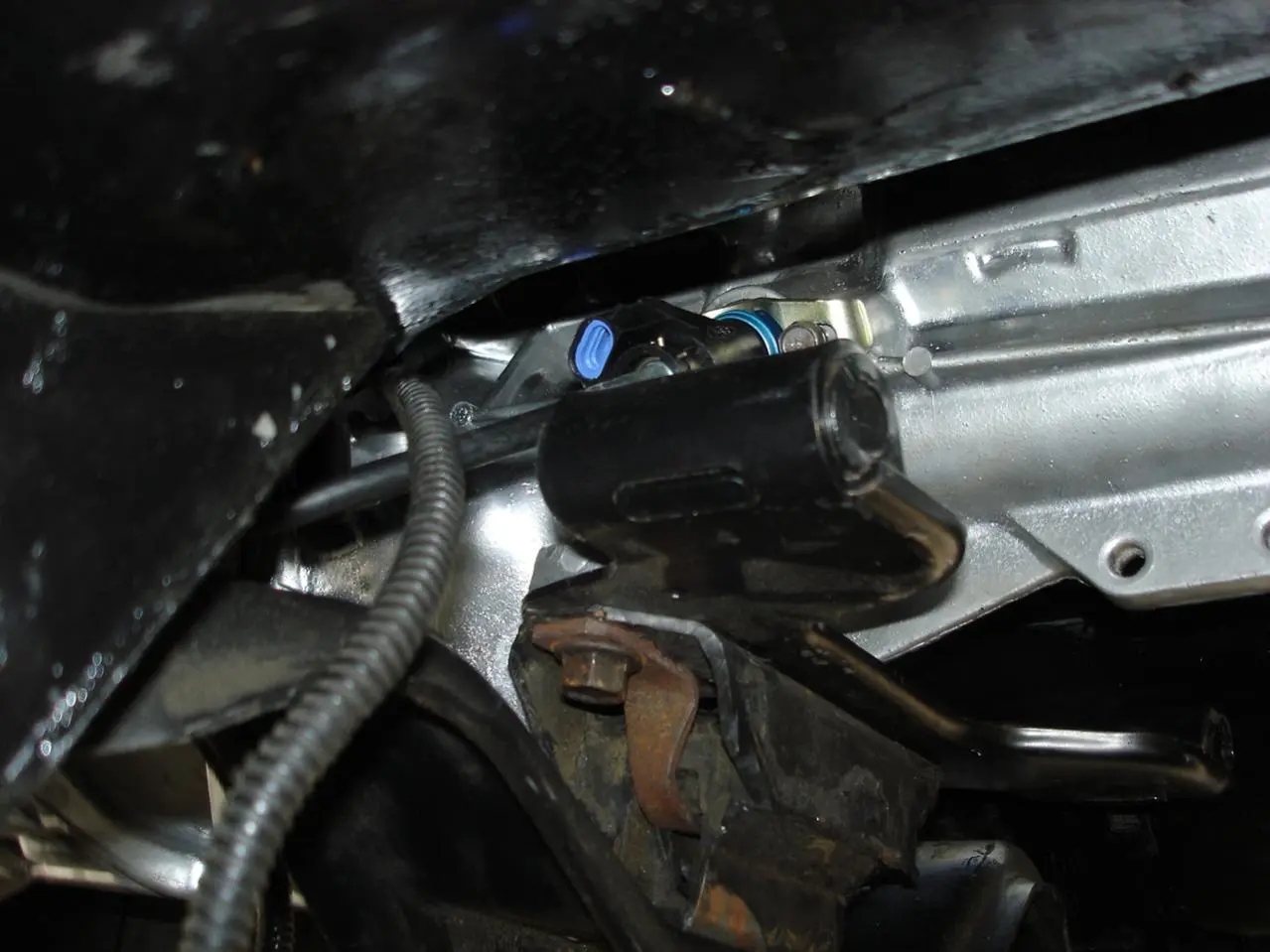

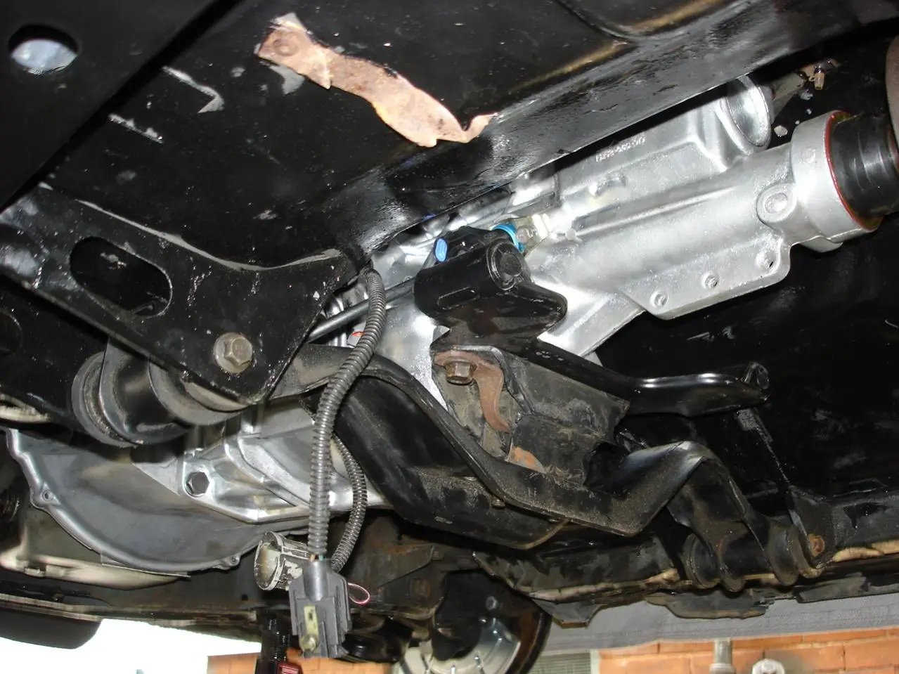

I might have pics of my setup for when i added it to my '88 when i prepared for MAF. I didn't have any issues...all fit in fine.
Actually..i'm sure i have pics of it
Here ya go. Best pic i had.
attachment.php
attachment.php
Check the install of the exhaust hanger that it looks like the way mine is routed. It's possible to reverse it and have that cause interference
