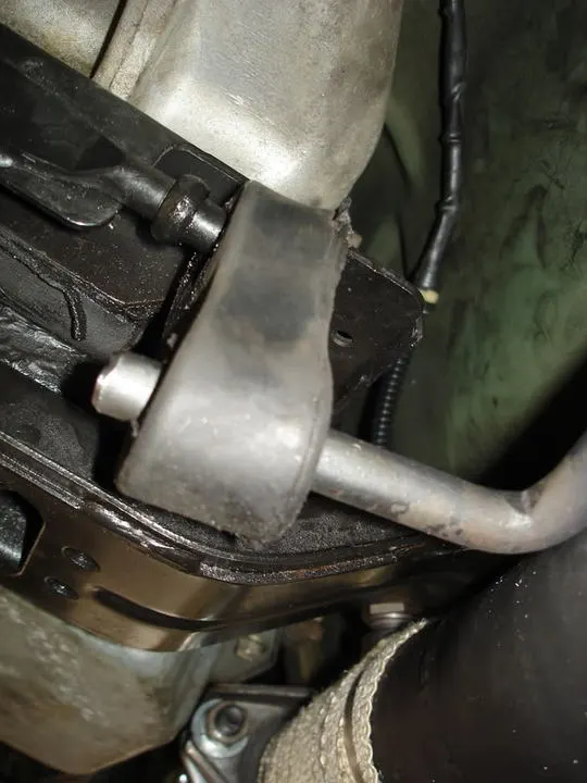

Make sure that you buy a nother O2 bung. I have myne on the passenger side.
The funny thing about my car is that its an Auto and I have Lts and the O2 bungs face towards the tranny and there 1 inch between the two.
So I had too weld 3
O2 bungs into my OR hpipe the 2 stock ones face outward and are at 9 and 3 and my lc1 O2 is within an inch back from the stock at 11 oclock and ith fits nicely between tranny and body.
