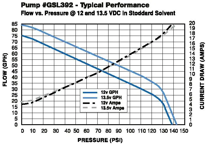

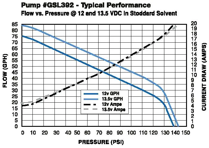

AFM had told me that the ratings on the fuel pumps can be missleading and that they will make the advertised specs but it may only be 2 inches from the fuel pump instead of at the end of the line.
But i still couldn't see how a 190 lph could be recommended over a 255 lph till now. The t-rex is rated 190 lph @ 70 psi and i did some searching and found that the wablro is rated at 255 @ 20 psi (12 volts) or 40 psi @ 13.5 volts.
In fact @ 70 psi the wablro makes 180 lph @ 12volt and 220 @ 13.5 volts.
So depending on which voltage the t-rex is rated, it could be higher then the GSL392 (Walbro 255). (I have a feeling the t-rex is rated at 12v.)
Im currently running a walbro 255 inline and to further my investigation i plan on timing how long it takes to fill up a 1 gallon jug at the end of my fuel line and also plan on doing the same with the t-rex as soon as i get it..
Just thought you guys looking to put on a supercharger or turbo would like to know about this. (especially to find out if the walbro puts out enough fuel like i don't think it did for me..)
BTW this is one of the most ideal ways to figure out which fuel injector size you can run.
