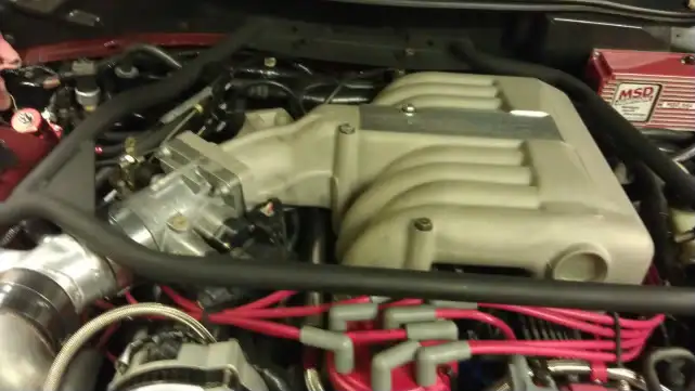

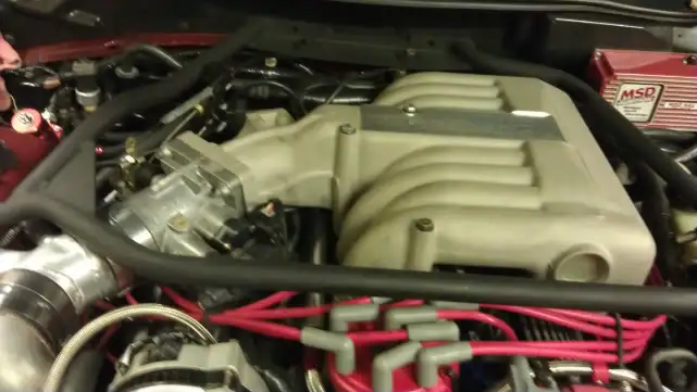

Out with the old and in with the new.
Old engine bay

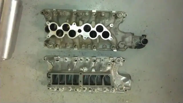

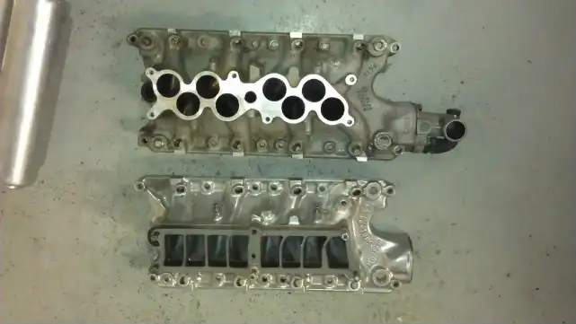

Lowers comparision
Upper Comparision

Wondering if I will have to redo my intake tube from blower to T/B... this intake looks taller...
Working the vacuum lines.. waiting on the 1262S-2 intake gasket, that is what was on it... Rest of the parts should be in to Cincy Speed tomorrow. Going hunting Sat. unless it rains... Might still finish this weekend though.

Addition of the new induction is def. going to get you over the 35HP you need. The Cobra intake is a mild intake at best. Even with high flow cats it's still going to make lots of power. Get it tuned afterwards.
The intake is taller, but the elbow brings the throttle body back down to stock height so long as you don't run a phenolic spacer. I was able to get that intake to fit without a spacer by using the Trick Flow valve covers. I shaved a negligible amount of metal off the bottom of the upper plenum to get a little bit of clearance between the plenum and the valve cover. In retrospect, I'm not sure if it was even worth it. You can get a used set off of ebay for under $100, and they aren't that expensive new. If you are still running an EGR valve though, that will be a bit of a problem. You should be able to get it to work with a little bit of love though.

Right now we have the lower on and set the upper in place with a spacer.... no egr... Had a small spacer on the cobra, it might work looks a little high but we will see... The intake is a little smaller then the Cobra and not close to hitting the tower brace. :) ....

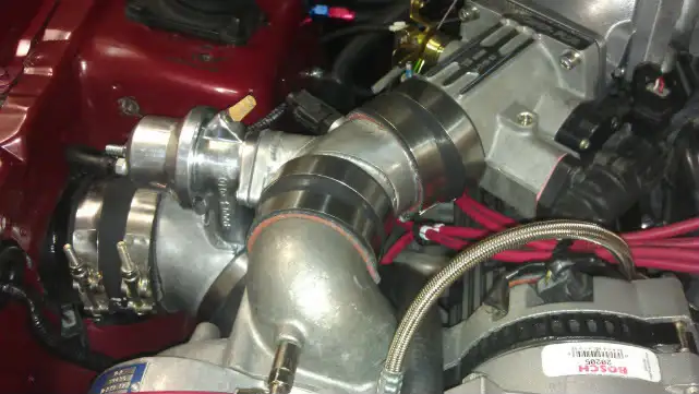

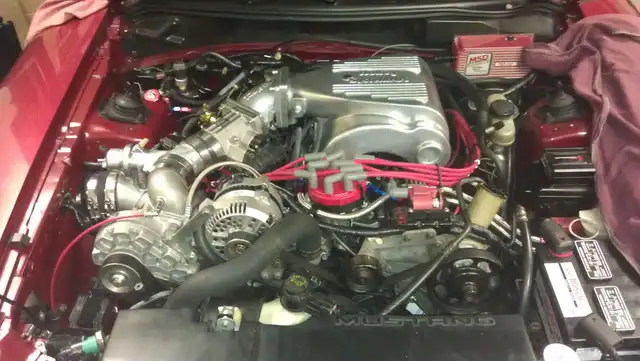

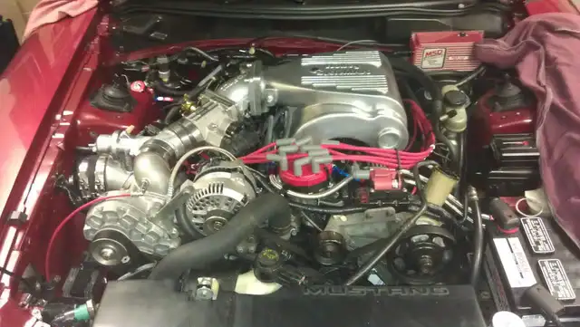

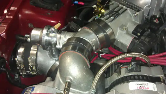

It's alive........ Short story... after fussing for 4 or 5 hours tonight the car started first key turn!!!!
Longer version
Didn't think the tube from the Vortech to the T/B would fit... Since the blowoff is welded to the intake tube loosed that and played with the different twists and turns, took a leap of faith cut 1/2 inch off the discharge tube and in it went with quite a bit of sweat. My 2 sons managed to get it together while I watched. Not tickled with the way it lines up entirely. off to one side a little.... more decisions... get a new tube made or live with it. If I get another one made the blowoff won't be welded to the intake tube!!
The car started great then they heard some noise from the engine (1st thought something fell in intake :( ) and we finally figured the one fuel rail wasn't full and temporally raised the fuel pressure (took vacuum line off) and now the knock noise is gone was pretty worried :)
Still have a vacuum line to get a fitting for and a couple little things to do then make an appointment for a tune. :) A big thanks to my sons for the work... nothing like working on a car for some quality time..
