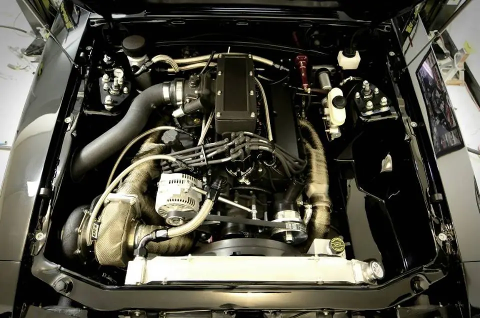

Just whoring another engine bay picture.

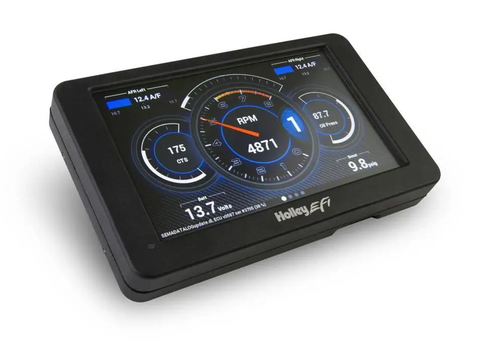

In other news, I was browsing around online and I think I'm going to get myself into another (unnecessary) winter project. I found out that Holley came out with a 7" digital dash late last year. The next firmware update will allow it to expand my HP ECU's input and output capacity. That would allow me to get the ECU to control more things without having to upgrade to the Dominator ECU. That 7" display also nicely fits into the stock gauge shroud area. I can sell my existing gauge plate and gauges for what the digital dash would cost me. Some re-wiring will be necessary, but it's nothing major. The digital dash even has provisions for blinkers, high beam, and barking brake inputs.
I can also then get the Holley to control the electric fan and water pump and sell my Dccontrol unit. Same deal with the boost controller. I don't really need any of these external units. They just add points of failure, IMO. The Holley EFI was not part of the original plan, so that's why I have all these other units. Now that I have the Holley, I'd like to use it to its full potential and I would actually save money in the process. Maybe I'll also switch to a DIS setup as well and ditch my CD ignition box. I've gotten real good at doing things twice, so I might as well continue the tradition!

I love my digital dash (FAST) even though it isn't nearly as fancy as that one:(... Controlling the fan and water pump on the ecu is a great idea imho, the ecu triggers the ground side of the relay and you get to eliminate a ton of unneeded devices like you said. Not quite sure what a barking brake is thougho_O:nonono:
Engine bay is absolutely killer btw!

I want a 4k pic next I just love the outcome of this engine bay.
Haha. Thanks guys. I'm happy with how the bay came out. Now we just need to nail this tune down and we're ready to rip.

The holley dash is badass, the possibilities of stuff it can do is only limited by the user. If i were you i would order one now, cause like everything else holley, the price will go up and up.
Have you messed with math channels at all yet? You should check that out, you can set up guages to do pretty much anything you want with them. I found one that would estimate horspower off of the datalog. I also talked to the guys at holley about making some sort of odometer with the dash and they said it is definitely possible. I have one just sitting on the shelf waiting to go in.
It's so funny you mention the odometer. That was the only thing I realized I would need on the dash. It would be so easy for them to add that because the Holley digital would already have the speed sensor input for the speedometer, and I have a hall effect speed sensor all ready to be hooked up. It would be nice if the digital dash can accept a magnetic 2 wire sensor input like the dominator. I guess I'll find out once they release the I/O harness for it.
I thought about pulling the trigger on it sooner than later and doing the firmware upgrade once holley releases I/O update.
you can hook the speedo into an input and use the math channel to calibrate it, that is what i was planning on doing. I have a magnetic collar on the DS so i will use that for a signal.
