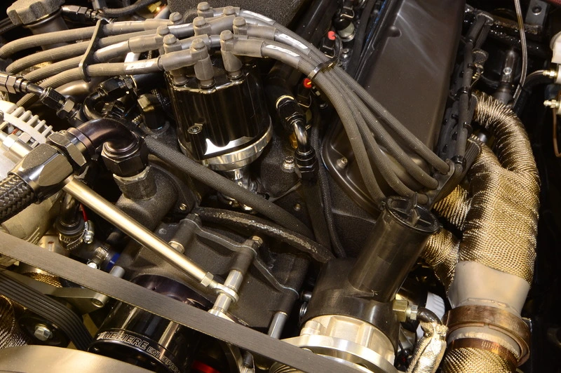

Here is the new route for the return lines. The Y block is mounted right under the frame rail.
Compare that to how they used to run.

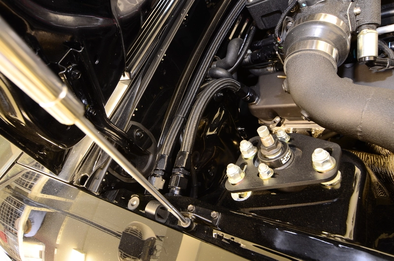

Here is the area behind the strut tower.
It used to be a bit more cluttered

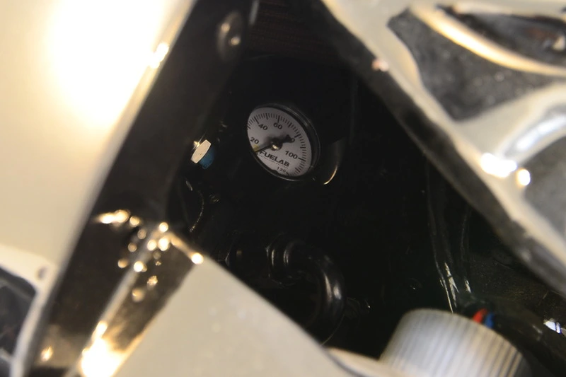

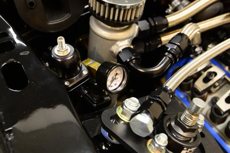

The fuel regulator is hiding in the fender, but I can still see the pressure gauge.
You don't think the way you have the return lines so close to the head(maybe even touching) that you will still have the same problem with higher fuel temps? Of course the head won't get as hot as the turbo downpipe but it still gets pretty hot. Just asking. :shrug:
I don't think those lines will get any hotter than the fuel rails, which are probably just as hot as the front of the heads. The front of the engine bay gets way more airflow from the fan than the area near the firewall. I haven't had any hot fuel issues so far, so I'm hopeful I'm okay.

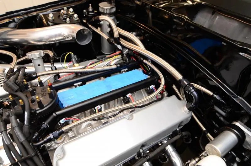

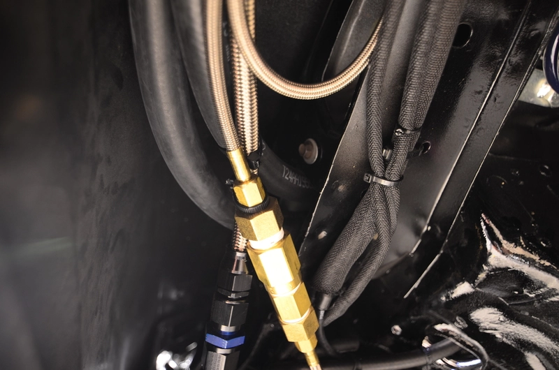

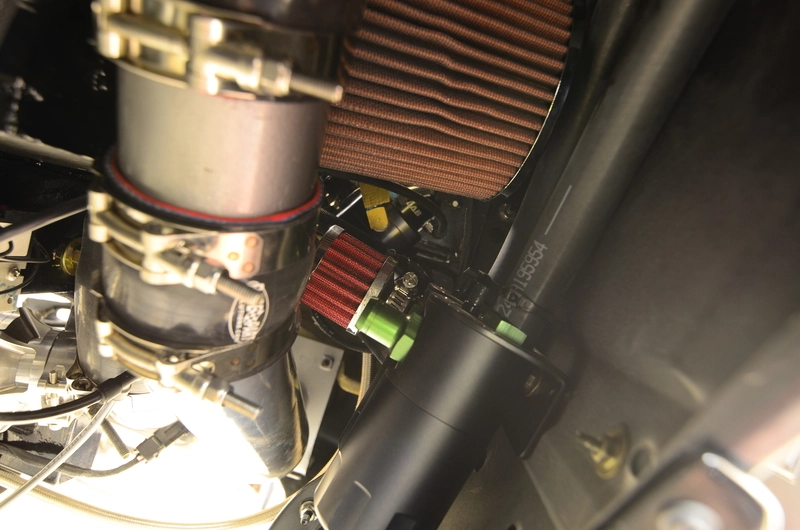

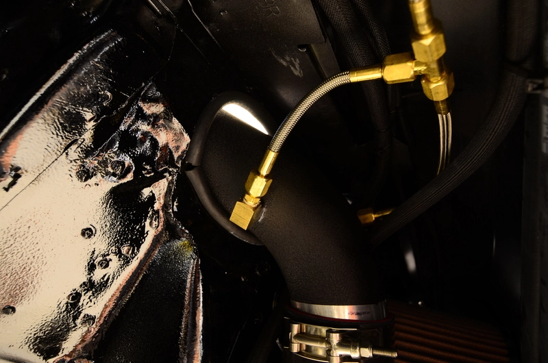

Here are some pictures of the route for the catch cans. This is a picture looking up into the wheel well where the lines come in behind the strut tower.
And then both of the cans mounted to the studs that hold on the ground effects. They are so light that it shouldn't have any efffect on the strength of the studs. I have two breathers for it, but only the one fits. I need to get a 90 degree adapter to allow the other breather to fit. No big deal.

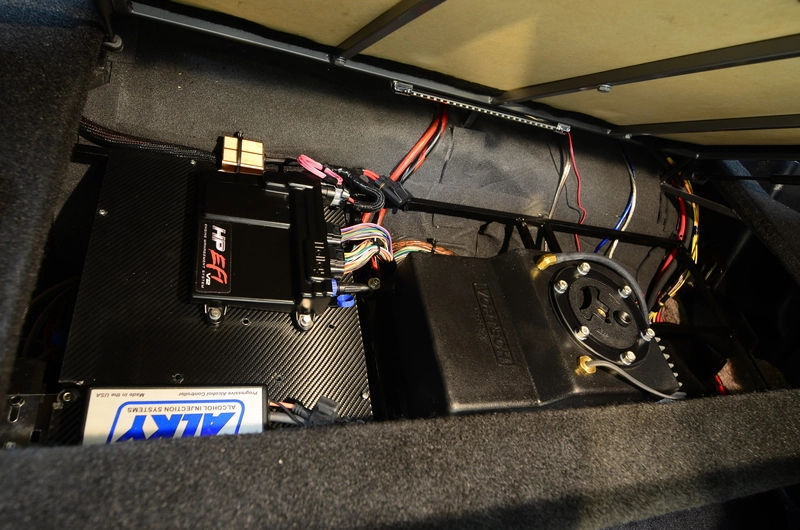

Here lay the meth tank and electronics. The tank is a Vortech aftercooler tank with a low level indicator and vent that is ran to the outside of the car. I welded in some extra brackets to hold it in place.

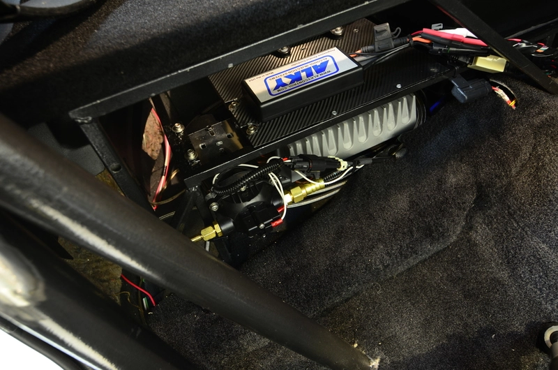

The pump sits in the same area. Fully accessible once the front panel of the rear seat delete is removed.
Dual nozzle setup.

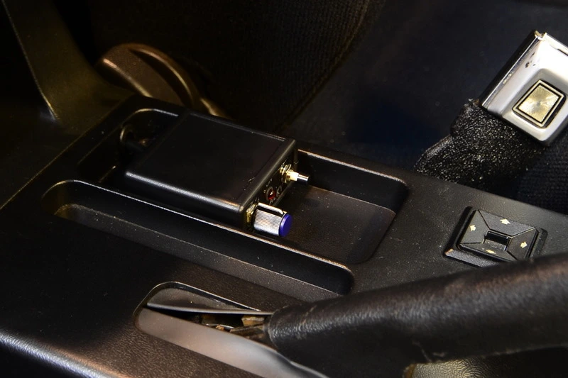

In addition to the controller in the rear seat area is the adjustment knob and test button. I decided to put it under the arm rest for easy access.

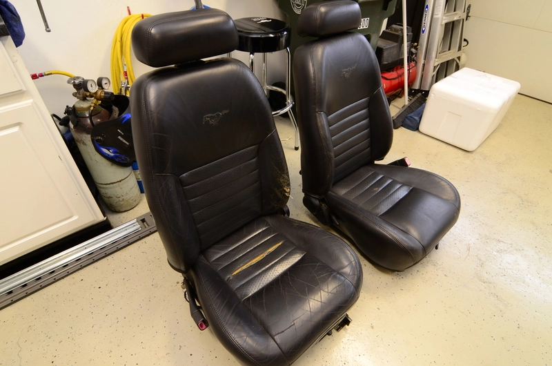

Always Mike. It literally never ends. Other than some new front seats and a few small tweaks to fix little odds and ends on the car, the winter should be pretty quiet for me.
