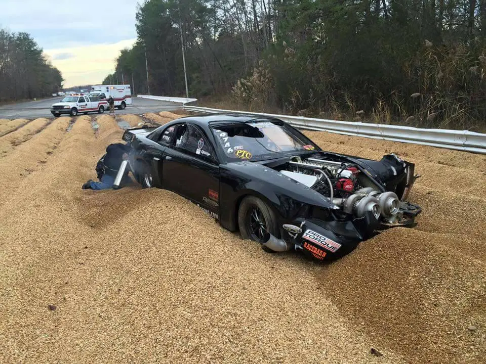

It hasn't happened yet, unfortunately. Frank found himself in the sand trap last Sunday and messed up his back. He broke a valve and it blew off his intake bending his throttle linkage, which stuck the throttle open. He literally flew 50' into the trap.
Hoping to reschedule sometime this week. My car and trailer have been at his shop since last Saturday. I'm not fond of it sitting anywhere except my garage!
