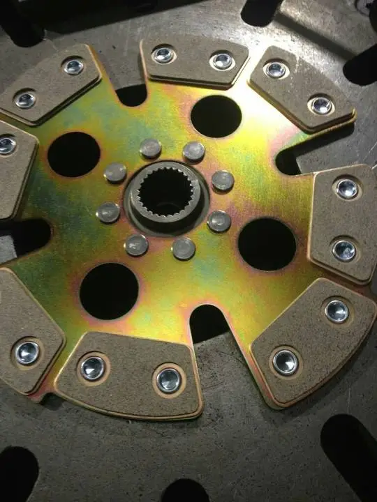

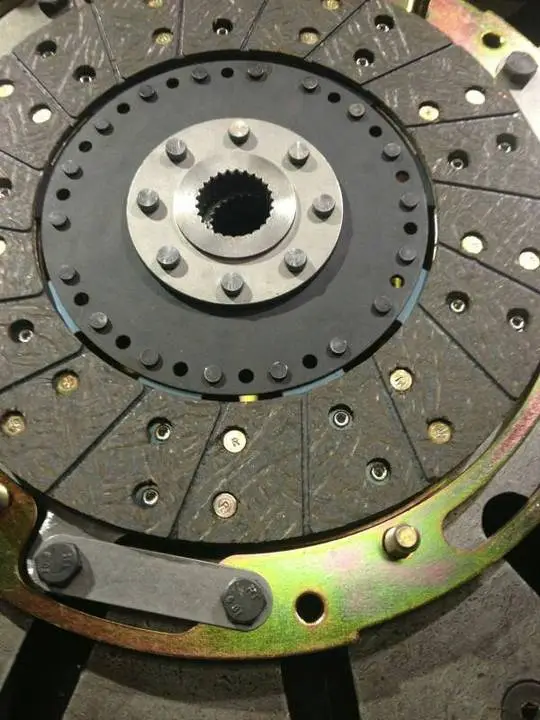

Got these pictures from Clutch Dynamics today. The twin disc is shipping tomorrow.
Went back and dug up the clutch post, you could go a couple ways with it, either more aggressive disc material to replace the organic disc with and the same base pressure, or jack the base pressure up and keep the forgiving disc. Since you are not going to be drag racing or powershifting the car, id say stick with the organic material, and go up on the base pressure. I think what you had shows the guy who you bought the clutch from put some thought into your combination and didnt give you something too aggressive. It's better to creep up on the clutch and let it slip on you than be too aggressive and let the power destroy something else on the driveline. Id drive it and see if it slips when it isnt on the dyno.

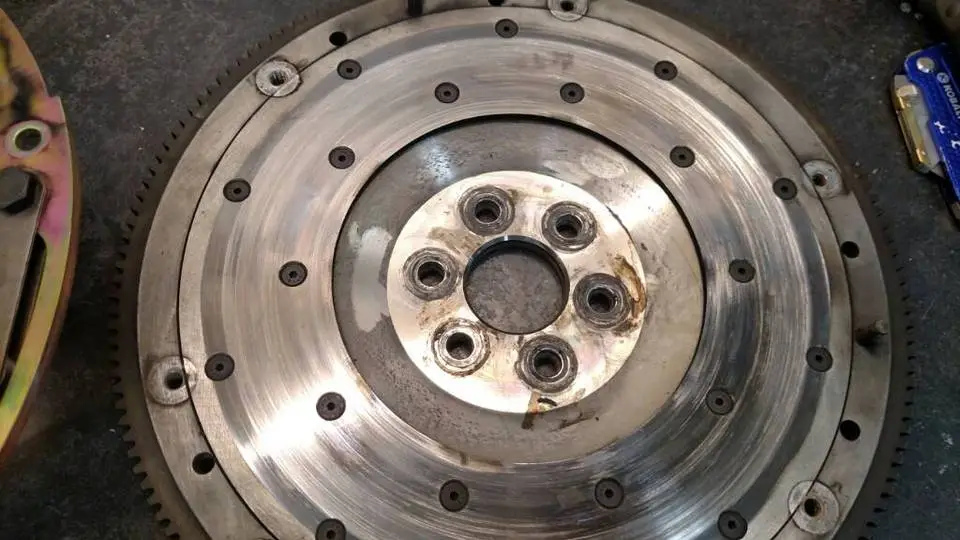

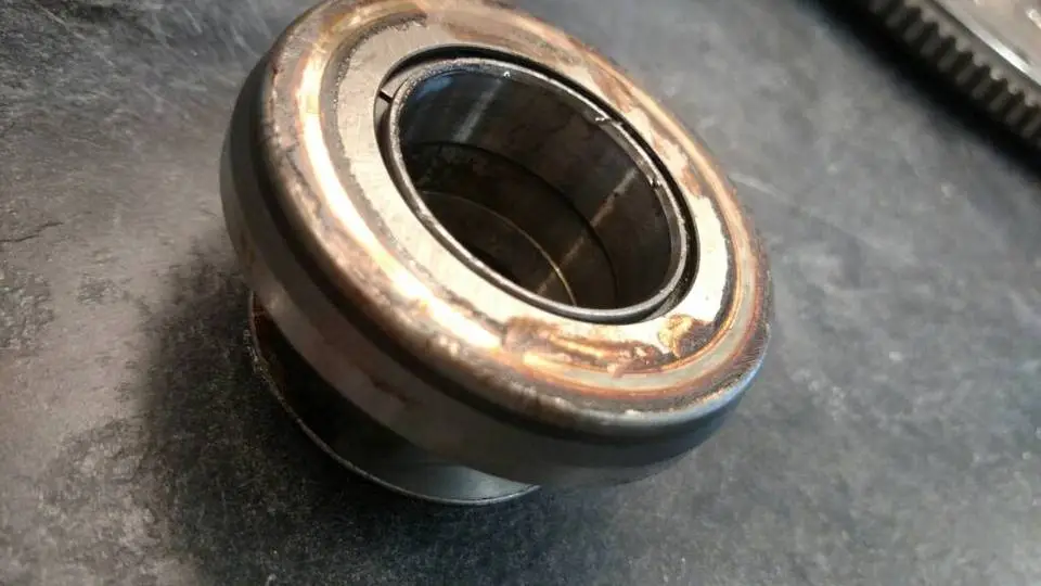

Dropped the transmission today and pulled the clutch out. When I unbolted the trans from the bellhousing I saw oil weeping down the face of the bellhousing. Not purple transmission oil, not motor oil, but an oil that didn't really smell like anything.

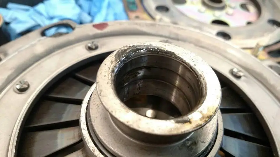

I get the trans out of the way and start poking around the bellhousing with a flashlight. Staring me in the face is a TOB that is soaked in its own grease. The bellhousing comes off and the inside is sparkling with clutch material. I wipe a rag around the inside of the bellhousing and it's slightly wet with a mix of oil and clutch dust.

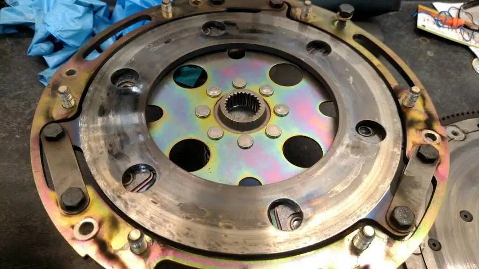

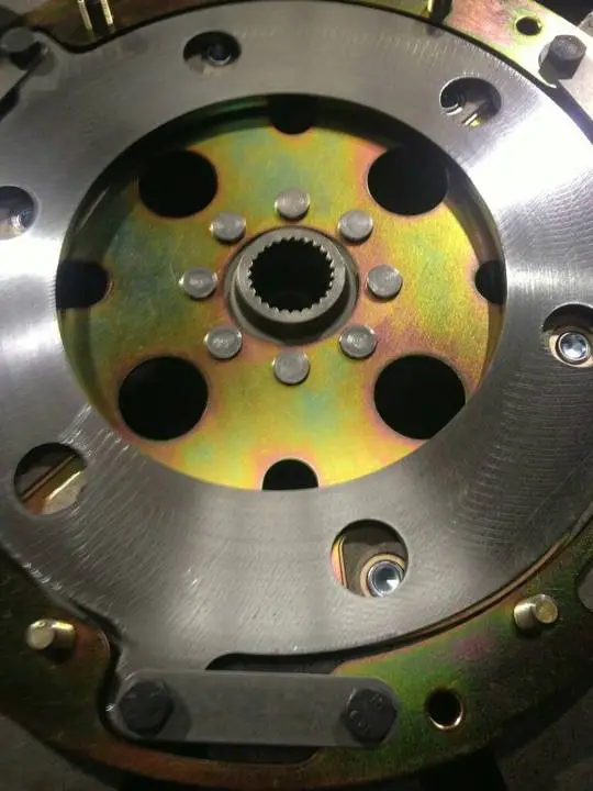

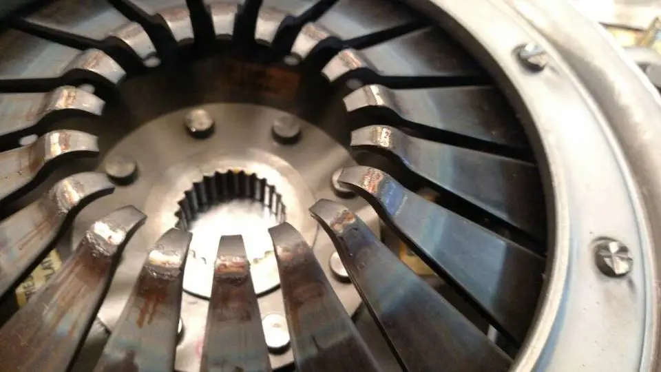

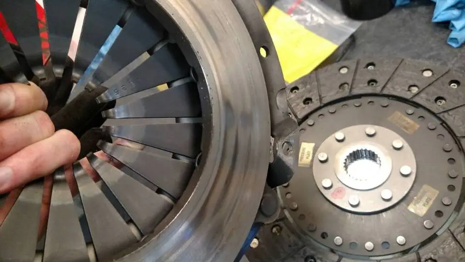

I start taking apart the clutch and the pressure plate has a nice film of oil around the inside lip. It also has a beautiful collection of hot spots. The floating plate looks just as colorful.
Here are some pictures of everything.
It's my understanding that the TOB is meant for constant velocity, so there should be some preload on the fingers of the pressure plate. I think my issue is that there wasn't enough preload and the TOB was barely coming in contact with the fingers, which created excessive heat turning the grease into oil that scattered all over everything. Not good, as you can see.
The transmission is fine. No issues there. In going to call clutch dynamics this week and see what I can salvage. I'm sure the clutch discs are wall ornaments at this point, but hopefully the pressure plate, floater, and flywheel can be turned and used again. I'm also going to be swapping in a T56 Magnum over the winter, so the modified TKO will be up for grabs. Tell yo friends! It's purdy.

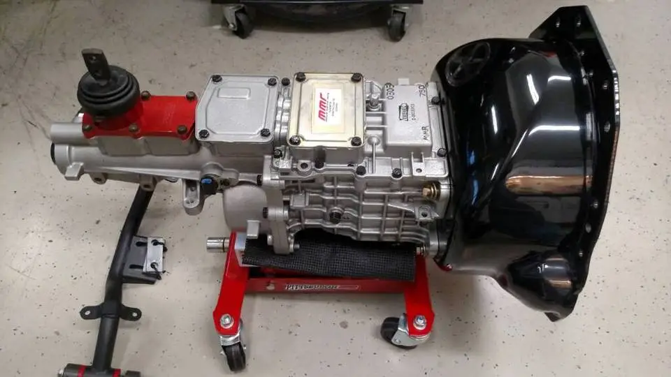

Anyone know any good marriage counselors? Do they come with divorce lawyers or are those separate? :shrug: Should be a package deal. Think I'll start a service like Uber and call it F....
That would be a Lakewood bell.
If he doesn't want it let me know as second dibs after Jeff . This is something I want to add over the winter . Wondering how bad the install will be with long tubes . Most guys were saying this one wasn't as bad as the old red lakewoods .

This one is actually a red Lakewood bell. It's just wearing fancy black powder lipstick.
