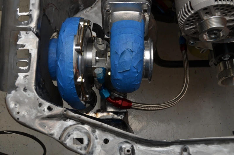

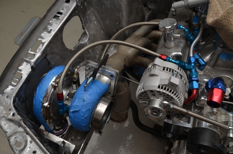

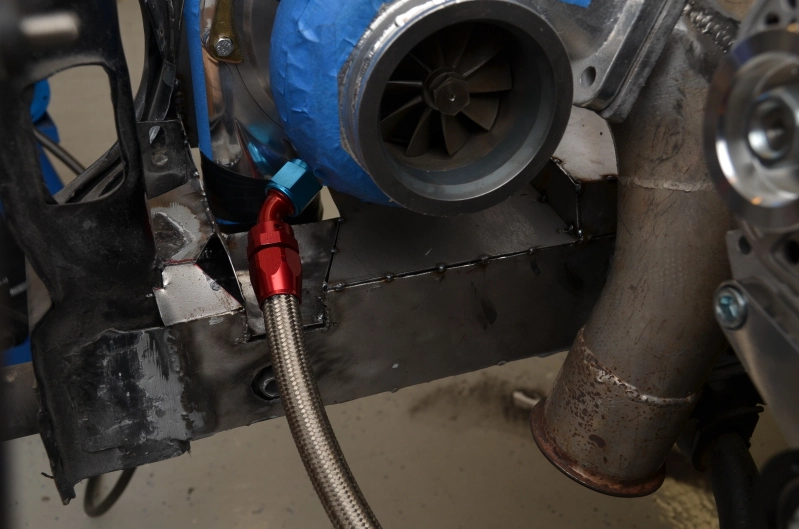

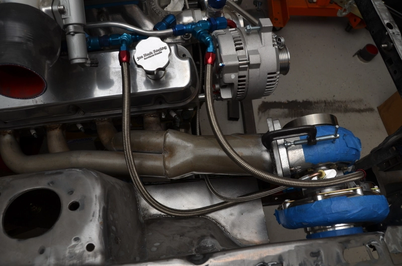

Progress at last!

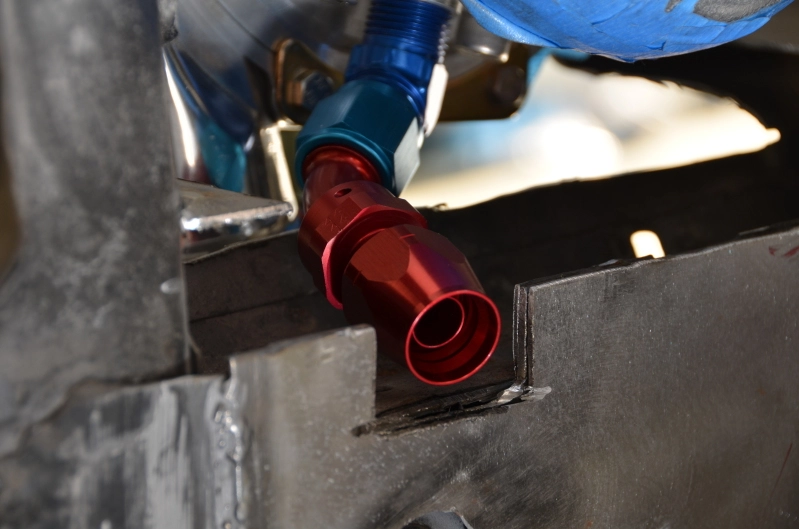

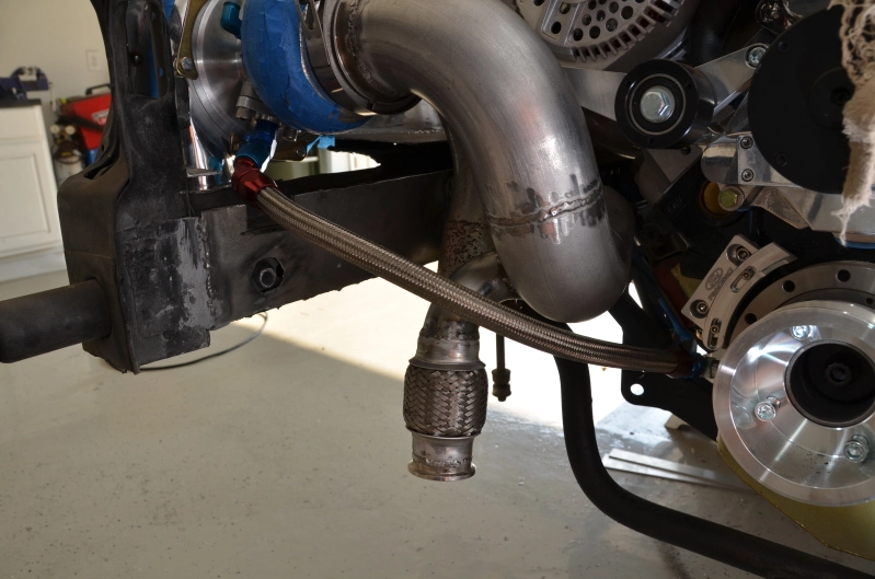

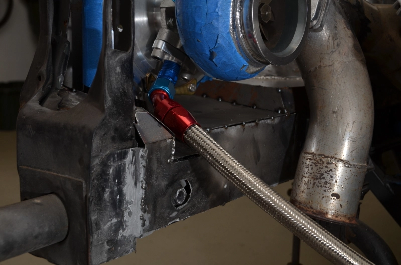

I installed the braided lines for the water and oil feeds/returns. Here are the water lines all done:

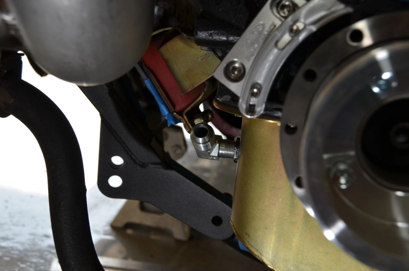

I figured out a combination of AN fittings that would allow me to more easily install the oil drain. I had to notch the frame rail for the fitting to have the right pitch.
90 degree fitting out of the pan:
Line installed:

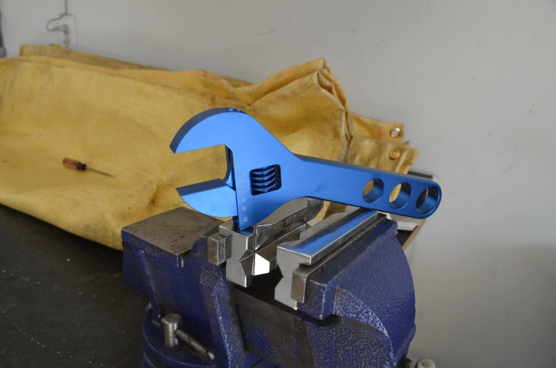

For those that are curious, here are the tools I use to assemble the AN fittings. Adjustable aluminum wrench and aluminum vice inserts. Works really well.
I boxed in just about all the the frame rail as well. Pictures to follow, need to upload them...

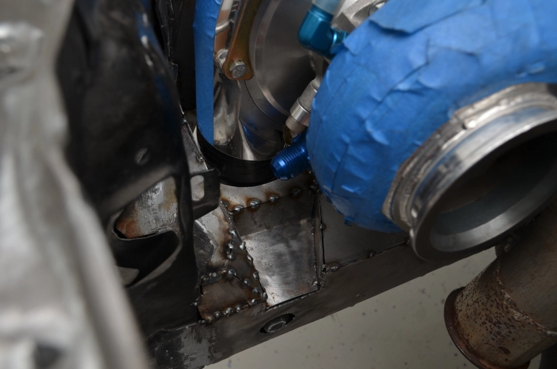

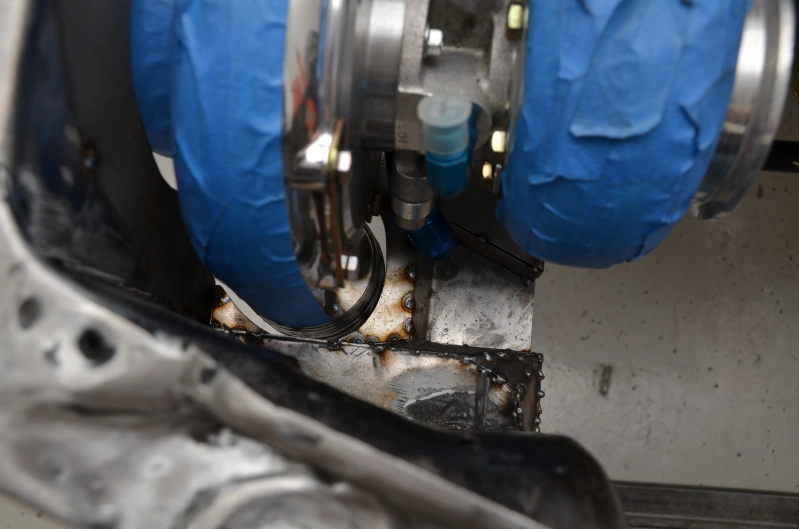

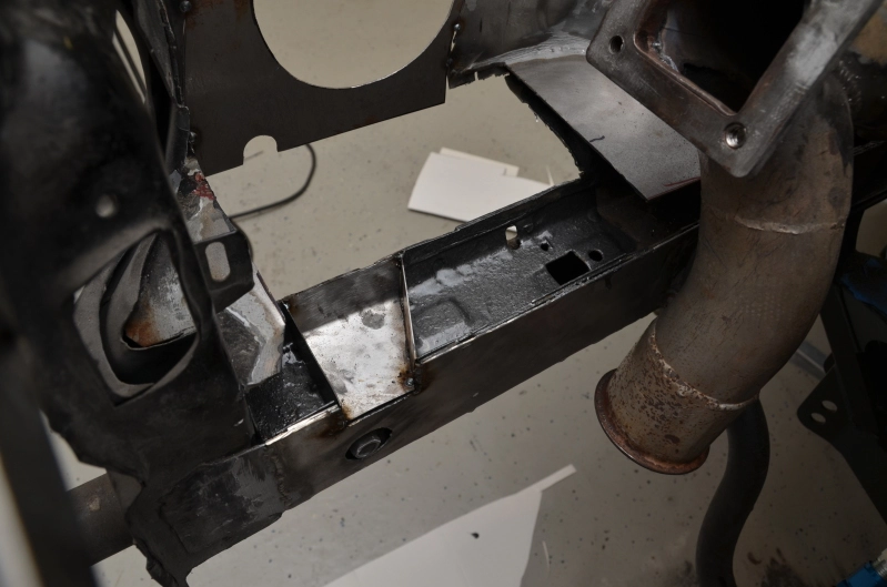

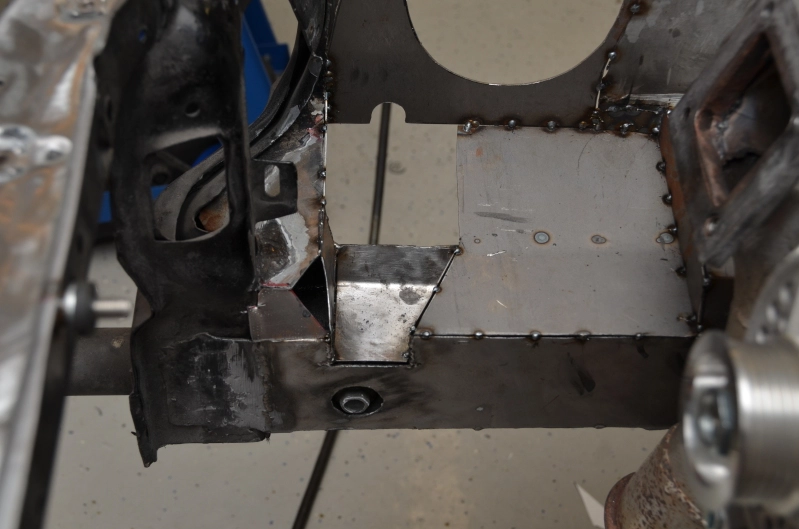

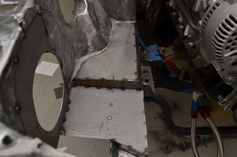

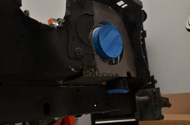

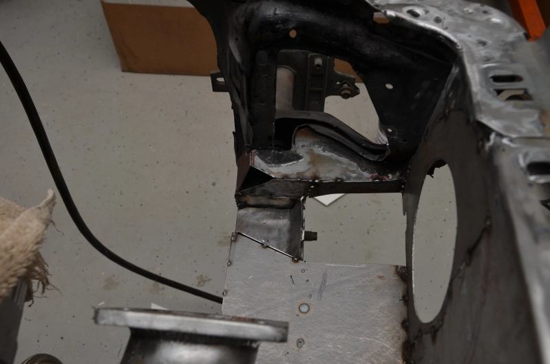

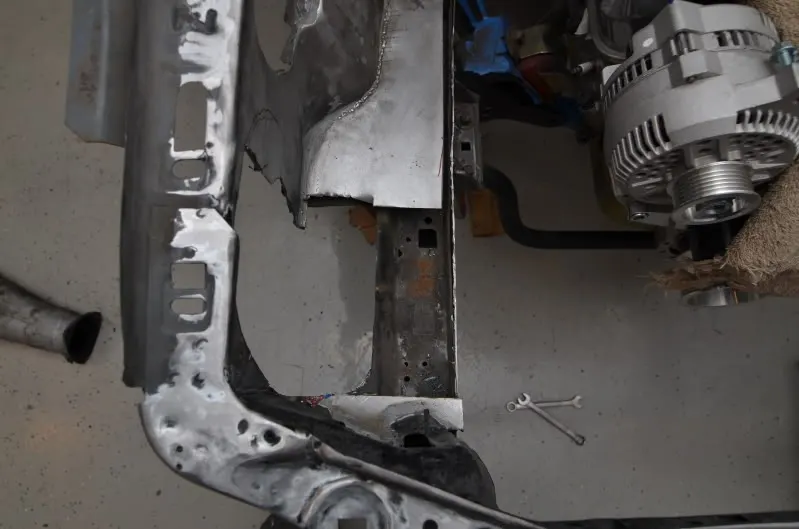

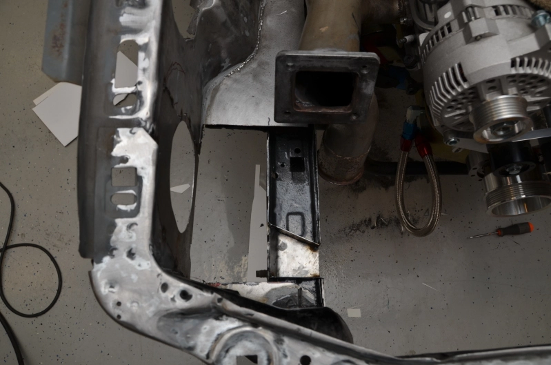

Just to recap, here's the mess I had to make of the inner fender apron to get the turbo to fit:

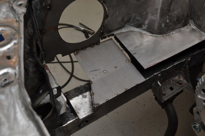

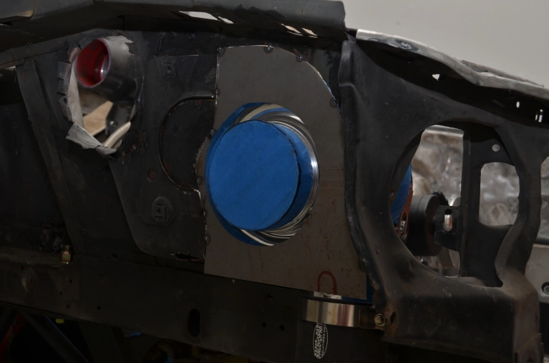

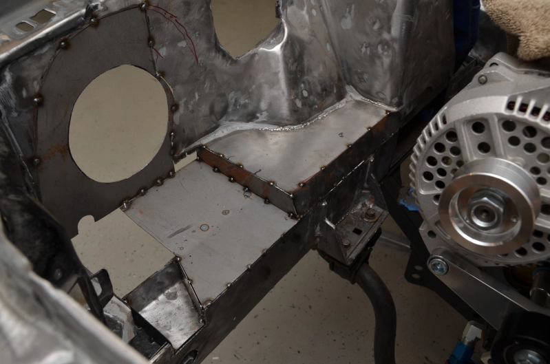

So, the solution was to box in as much as I possibly could to make everything look better and a little less butchered. Took a lot of paper templates and metal trimming to get it done.
Used a cordless jig saw to cut a 5" hole for the compressor inlet
Cut pieces for the boxed out area around the drain fitting:
Cut more and more pieces to box the rest of the framerail in:
Just as I was welding in my second to last piece, I ran out of welding wire
I still need to weld in that missing piece and I also want to weld in some radiused pieces around the outlet to eliminate the round peg in a square hold look. Everything fits pretty well though if you ask me!
I'll finish up the welds and grid everything smooth and pretty once the engine is out. No point in doing it while it's still in there.

Man I tell ya, you are a cutting and welding fool. Everything you've done looks really good. It is really refreshing to look at something that's not just hacked in there.
So many cars down here are done so down and dirty, that that hole you started w/ is usually left that way, w/a 1-3 gal nitrous enrichment fuel cell hanging out of it. I gave up asking people why they left it looking like sh it after getting told that pretty doesn't make it go faster.
"That's OK bubba, fast doesn't make it any less of a hack.
Good Job sir.

Thanks Mike. Much appreciated. My days of hacking things are well behind me. The whole car is still in a very crude fabrication stage right now, so I'm excited to get it all cleaned up and ready for paint. I want this car to start looking like an actual restoration project and not a repo case.
I enjoyed fabricating these pieces more so than the hotside parts mainly because I didn't need to use the grinder to cut the metal pieces. A pair of tin snips and electric cutting shears got the job done. It was refreshing not having a nose and mouth full of metal dust particles for a change. I'm pretty certain I won't be able to have an MRI done for at least a couple months after I'm done with all the fabrication! With all the metal dust impregnated in my skin, I probably won't even get through airport security

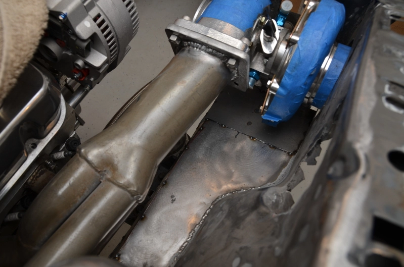

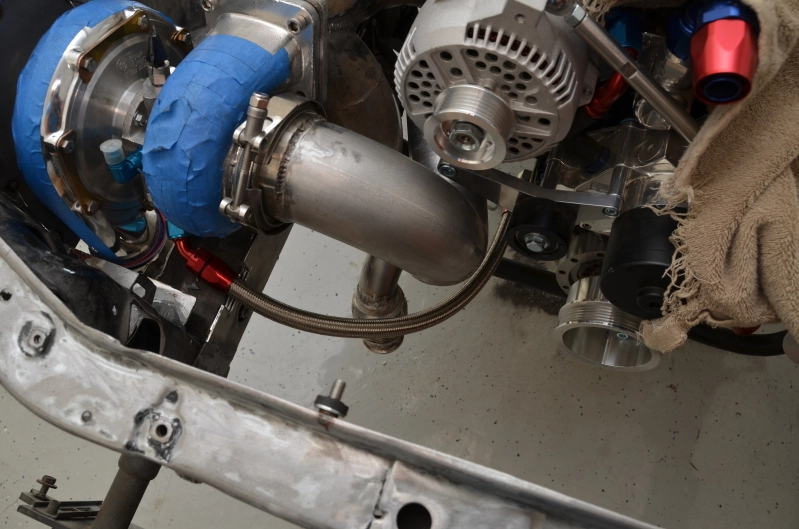

Welded a few more pieces in around the turbo discharge. Gives it more of a finished look as opposed to just a square hole.
Also fabricated the lower radiator mount. This will get drilled and tapped for 2 mounting holes. I'll bolt the bottom radiator mounting flange to it. Rubber isolators will be used to dampen vibrations. I'll weld this to the frame once the engine is out.
Next up is fixing up the discharge tube hole...
