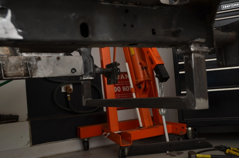

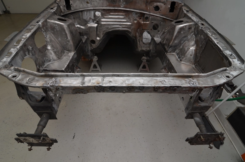

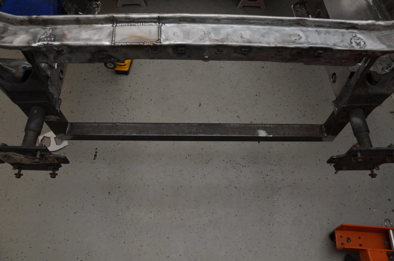

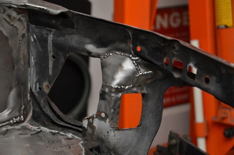

Welded in the new lower radiator support. For those that are wondering, I had to cut out the old one because I hacked it up so bad 7-8 years ago when I tried to stuff an oversized 3-row aluminum radiator in the bay. It was not in any kind of condition to bother repairing it. The boxed steel support I made is probably stronger anyway.
In addition to hacking the lower radiator support, I apparently gave the driver side core support some hell, so I had to cut and form a piece of steel to fix that area up. I sometimes wish I had the tools to stretch and form metal, but a mallet and a bunched up rag got the job done for me.

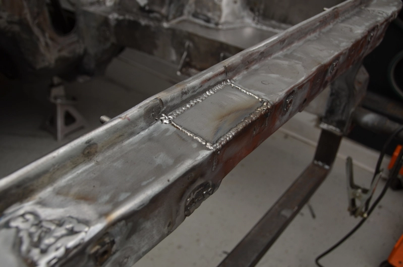

In the picture below, you can see the 'bump' on the passenger side of the core support.
That bump was bothering me, so I cut it out and welded in a new piece that will grind down flush with the rest of the support.
That is all pretty much the last of the welding in the engine bay area. I still have some grinding left to do, and I need to find my carbide bits so I can clean up the corner welds, but other than that and a good cleaning, the bay is ready for filler. I have other things to work on before smoothing out the bay though...

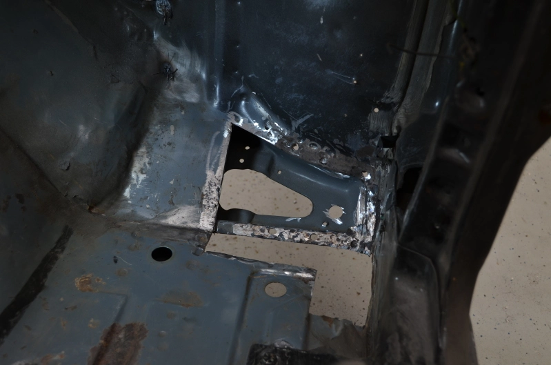

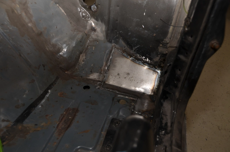

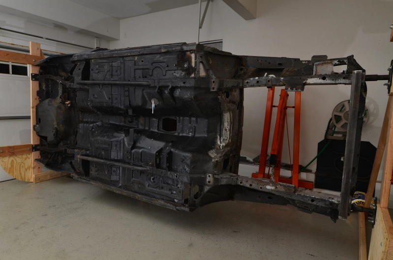

I'm going to finish the underside of the car first and get that out of the way. First thing I needed to do was repair the footwell damage. I cut out all the rust-infected area.

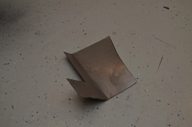

Made myself a new piece.
And welded her in.
Need to do the same thing on the driver side. Ford had reinforcement plates in the footwell area, and I assume if Ford spent the time and money installing them, they must be necessary. I'll have to figure out the best way to replicate something close to those plates.

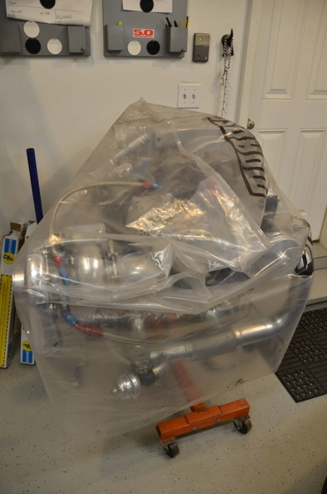

GLad to see they make something that doesn't require modification before installationMeh. I tried the trash bag thing. Kept tearing. That Moroso bag is some heavy duty stuff.
