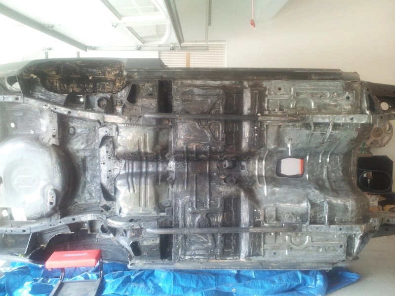

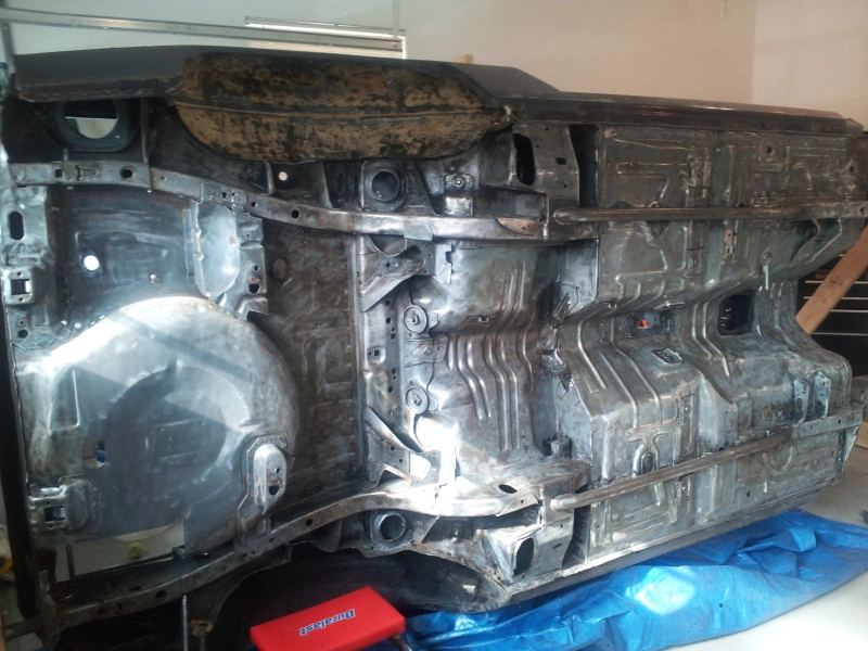

Decided to take some cell phone pictures just to update on progress. Have about 95% of the junk underneath all removed. Just need to go over the hard to reach areas by hand because I couldn't get the wire wheel or scraper in some areas. Coming along though!

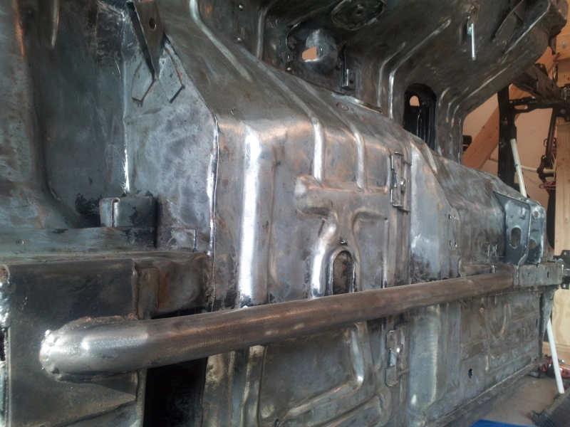

The front portion is after scraping away the undercoating and hitting it with the knotted wire wheel.

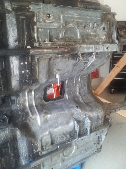

Repeat until the whole underside looked like that...
Once I get the rest of the little nooks and crannies (and wheel wells), I'll wash everything down with a solvent and then hit it with a metal prep and she will be ready for primer, paint, and then eventually bedliner.
