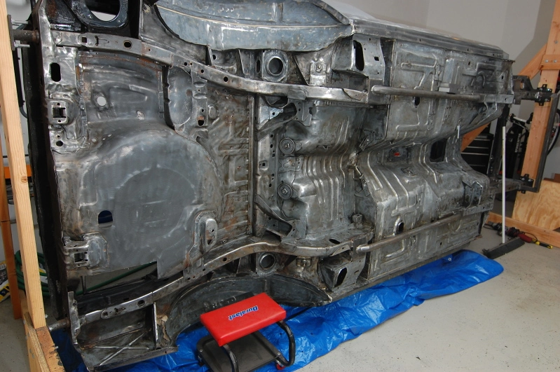

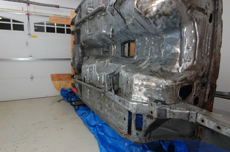

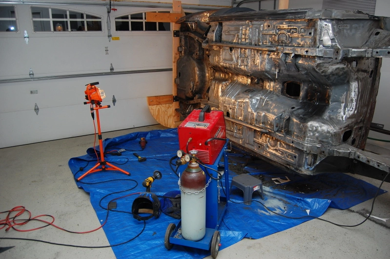

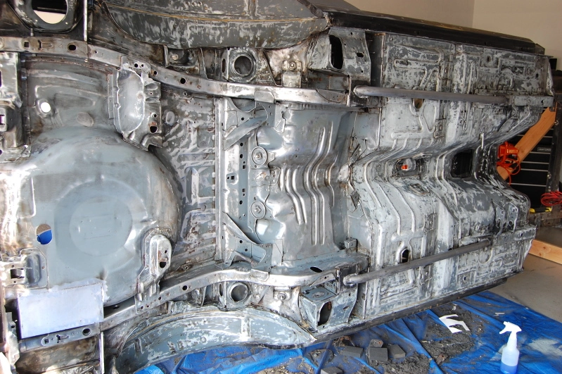

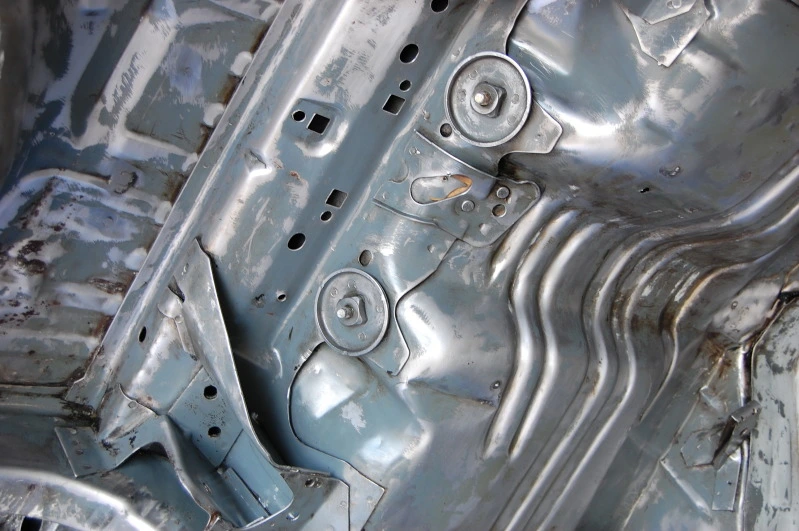

Felt the need to post of some pictures better than the crappy cell phone ones from earlier. I have some minor rust repair and welding to do, then I can clean everything down and get to spraying. Should have bedliner on it by next weekend I hope.

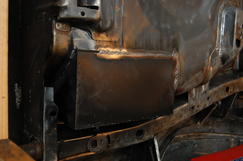

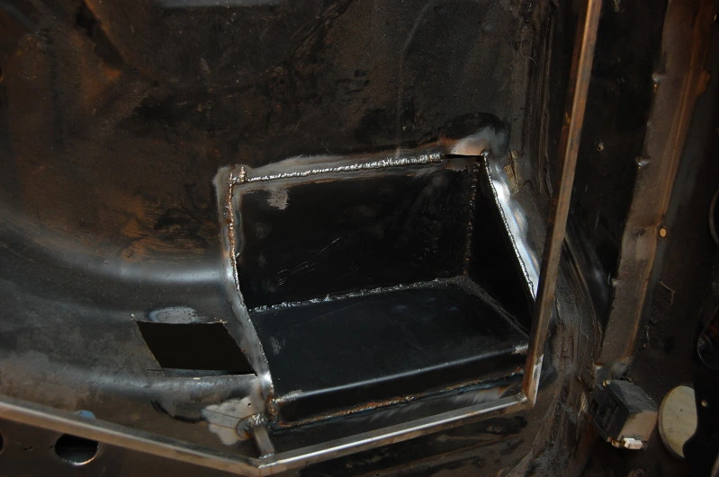

Welded in my battery tray tonight.

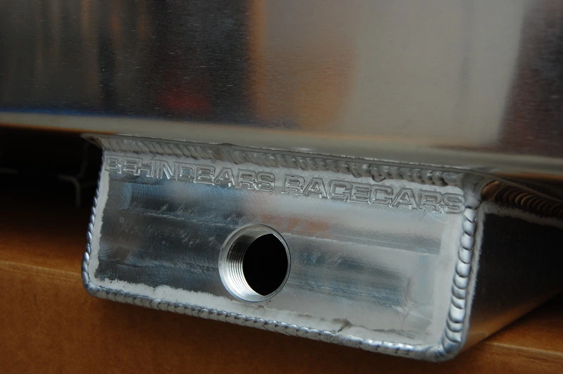

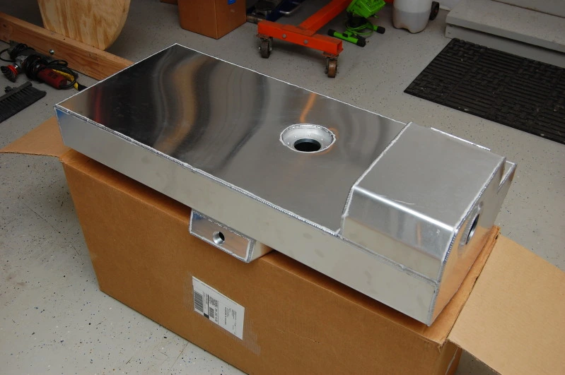

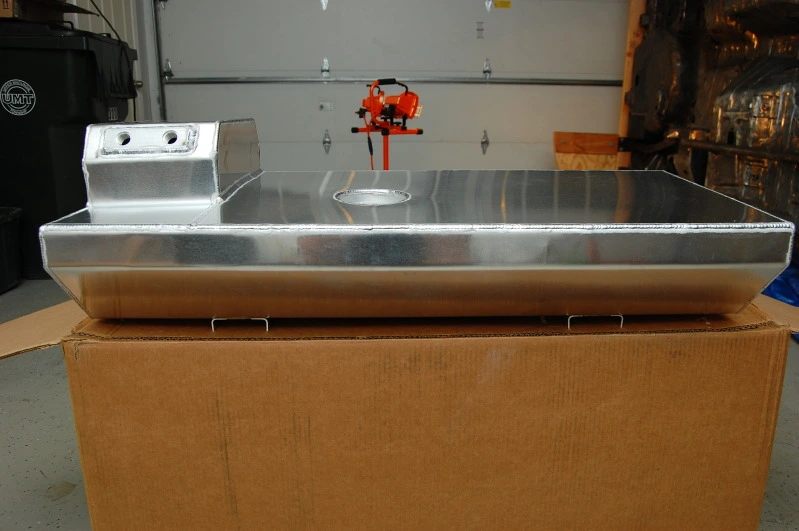

My BBRC fuel tank also showed up today. This thing is freaking nice. Rick 91GT gets great pricing on BBRC stuff. I'm very impressed with the tank. Chris at BBRC does an awesome job.
The tank will be powdercoated the same metalllic silver as the intake and valve covers. Straps will be coated gloss black for contrast. I'm still tossing around pump mounting locations. Rick showed me some pictures of a nice setup he did, and I may wind up going that route. I'm still tempted to have brackets welded to the front of the tank to keep the pump and filters completely out of sight.
The tank is fox specific. BBRC makes tanks for all Mustangs from 85-04. The tank itself does not have any formal pump mounting provisions. It's meant for an external pump, so there is no pickup. There is just the -12 feed out the sump and the -8 return and vent on the top. It accepts the stock filler neck and stock fuel level sending unit.
I'm still debating on how/where I want to mount the pump and filters. Rick has mounted his on a custom bracket that sits between the rear bumber and tank, which I really like. I'm just concerned with how much of the pump will be seen behind my Cobra bumper. The other alternative is to have brackets welded to the front of the tank and hide the pump between the tank and rear end. The pump and filters are all black and I'll be using black fittings and black braided line to hide everything as much as possible.
I think the best place to sump the tank is at the rear of the vehicle because of fuel movement during acceleration. The tank can be ran down to almost empty according to BBRC. You would probably have to keep it at least half full with a front sump.

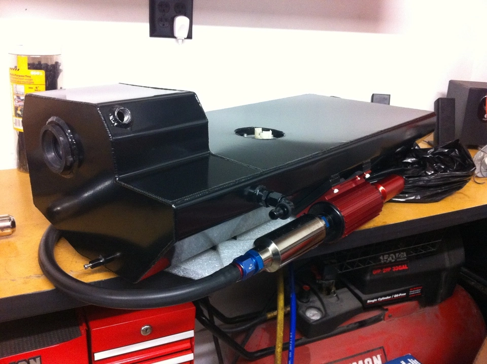

A guy on Corral mounted his pump directly to the tank like this:
I like this because it keeps the pump and filters completely out of sight.

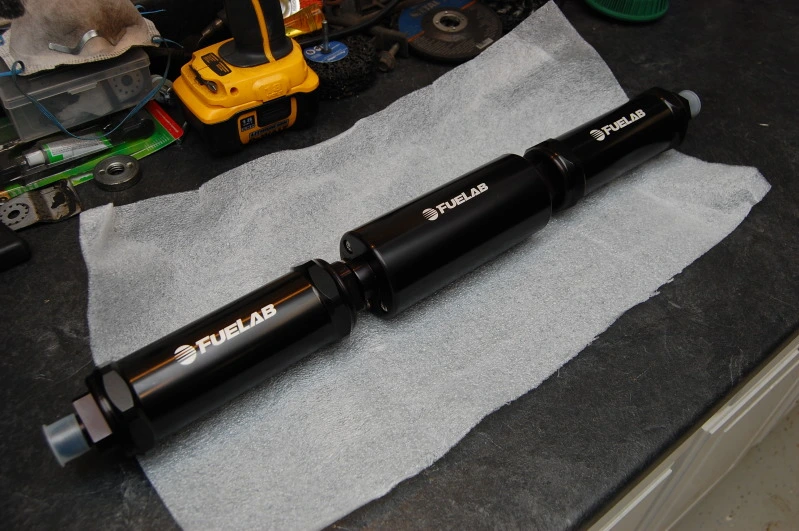

The rest of my Fuelab stuff showed up today.
Consists of a pre-pump filter, 1300hp pump, and post-pump filter with a built-in check valve. The damn filters are longer than I thought.

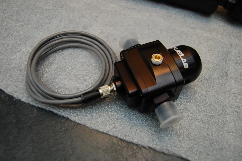

I also got an electronic fuel pressure regulator from Fuelab.
The regulator also doubles as a pump controller. It controls voltage to the pump based on engine demand. These big pumps must run at reduced voltage when just cruising around or else they will burn up. The regulator does the job that an external controller would. I'm pretty sure Fuelab is the only company with technology like this. Pretty cool stuff.

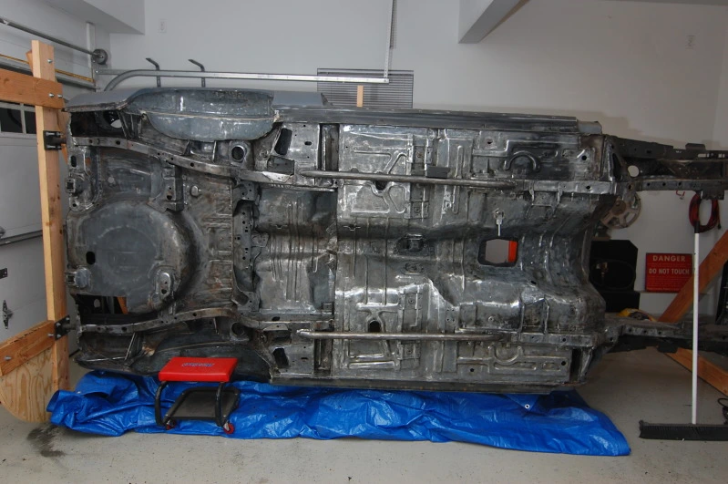

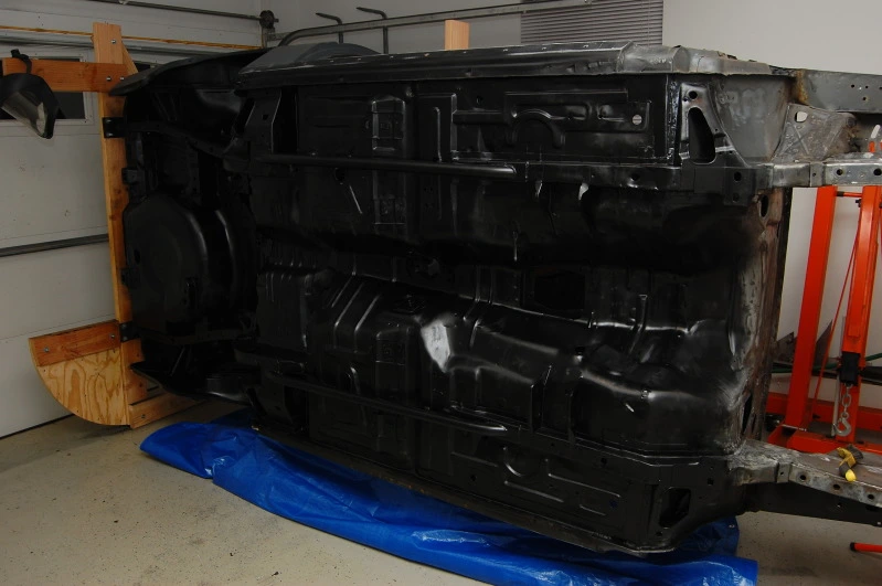

Underside is just about all ready for paint. Just need hit it with compressed air and then wash everything down with solvent and prep chemicals. Should be able to get the primer coat on tomorrow. I still have a little bit of welding to do on the front end but I ran out of gas again, so I just won't paint those areas for now. I was hoping to get the bedliner on this weekend, but because of drying times for the primer and paint, I won't be able to until during the week.
Now I just need to find Ding Pao and get him to clean up this mess. I think he got stuck in the sump pump again.
Finally got this car to look like an actual restoration today.
Scuffed, washed, and prepped. Already ready for some black primer. Because I was going the bedliner route, I didn't bother to get the underside 100% flawless. The bedliner will be very forgiving and will cover up my laziness.

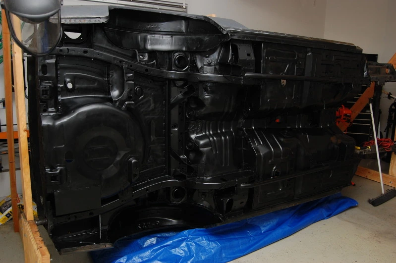

And finally, one coat of primer. Hopefully shooting the satin topcoat tomorrow as well.
