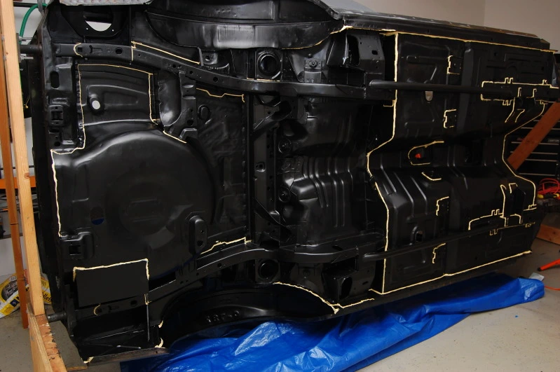

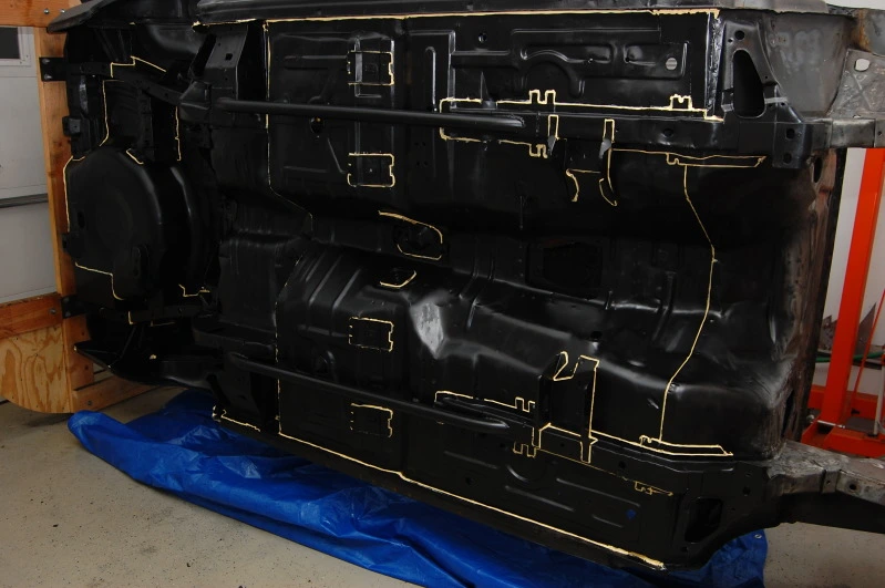

Seam sealer!
One of my gloves tore and I got a bunch on my finger. Definitely not coming off for days, that's for sure.

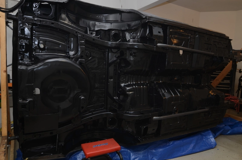

Shot the top coat this weekend. Nothing but some simple Eastwood Chassis Black paint. I also hit the subframe connectors with some hammered texture paint. That will be the same finish on the roll bar inside the car.
I'll be spraying the bedliner by the weekend, weather permitting.

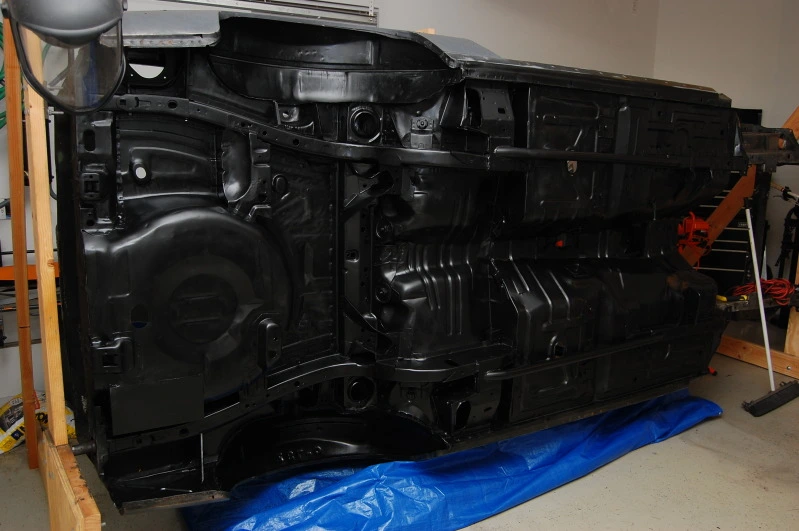

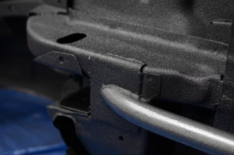

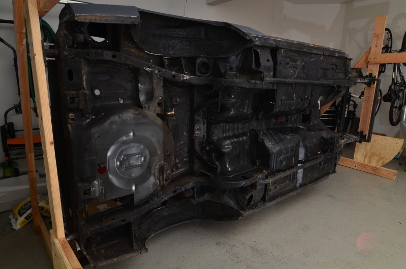

This is probably the best pic I've ever seen of Fox torque boxes on the internet.
bird_dog0347
still married haven't seen testicles in years
Jun 7, 2012
2,307
2,050
174
Little Elm, TX
Sep 11, 2012
#468
  • Sep 11, 2012
  • #468
I assume you mean the nicest torque boxes and not the best pic of them? Seeing as how it only includes the upper boxes... but it does look DAMN NICE!
Admin Dude
Jan 4, 1985
43,194
21,364
Box behind Walmart
Sep 11, 2012
#469
  • Sep 11, 2012
  • #469
Yeah... the ones you can't ever see because of all the crap that's in the way.

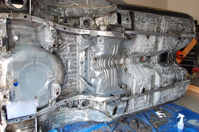

Thanks guys. Everything did clean up pretty nice under there. After spending hours and hours cleaning up the underside and becoming very well aquainted with every weld and seam under there, I truly realized how weak the upper torque boxes really are. One of my spot welds was actually cracked. I didn't waste my time reinforcing them because of the IRS, but with a solid axle, reinforcing the uppers is definitely just as important as reinforcing the lowers.

Whats the spec /type of seam sealer did you use? - you may have mentioned it before.....
RacEoHolic330
I like to dress like a pretty girl
Mar 4, 2003
4,014
1,698
203
Allentown, PA
Sep 13, 2012
#473
  • Sep 13, 2012
  • #473
Thanks bud. The seam sealer is made by Lord. This line of sealer is called Fusor 800EZ. I got it from my painter. It's a professional grade sealer. Not as 'professional' as those sealers that use the dual cartridge caulk guns to appy it, but it's still good stuff.

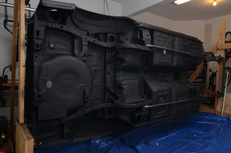

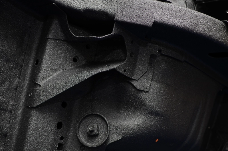

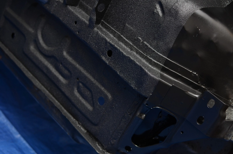

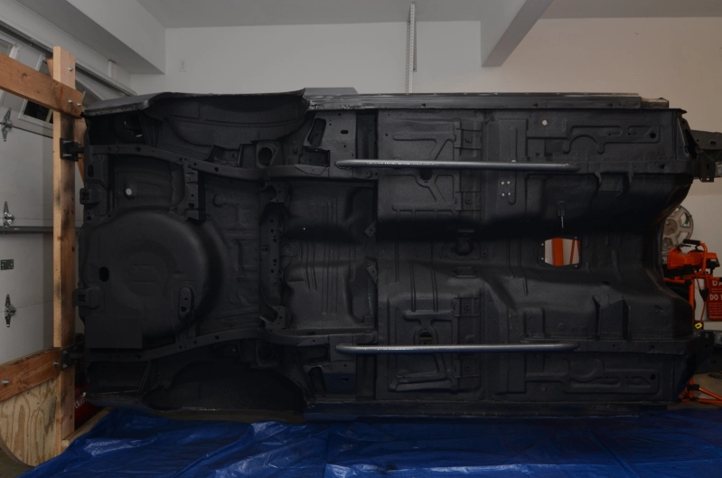

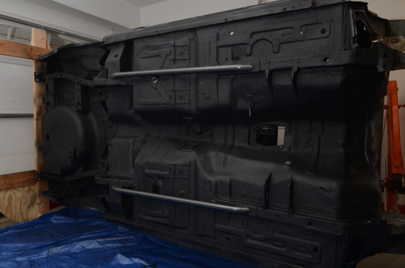

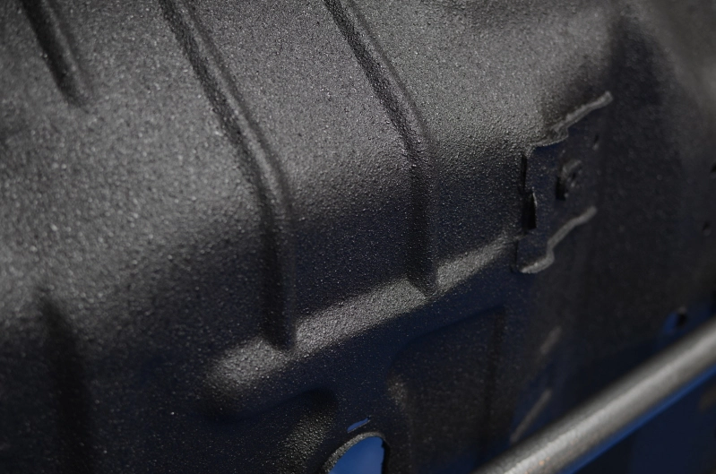

Well, here she is. Underside is officially complete.
I am honestly VERY happy with the results. The pictures don't even do it justice.
The spec sheet said to shoot it between 40-70psi. I knew that more pressure would shoot a finer mist, so I shot it at 60psi. I also kept the gun at least 12" away from the surface. On the second coat, I kept it probably 20" away. This created a final look that almost resembles the look of 80 grit sandpaper. The wheel wells have 3 decently heavy coats on them, but keeping the gun far away kept that sandpaper look even with the heavy coats. I didn't want that 'chunky' bedliner look, and I'm glad I was able to avoid it coming out heavy.
It also hides just about all the body imperfections on the bottom as well. I really couldn't be happier. If anyone is thinking about using Raptor Liner, do it. It's so easy to apply, and for a total cost of $120 including the gun, you can't beat the price. I still have one bottle left over out of the 4 it came with.
I should be able to get the car back on all four whee...err...jackstands this weekend.

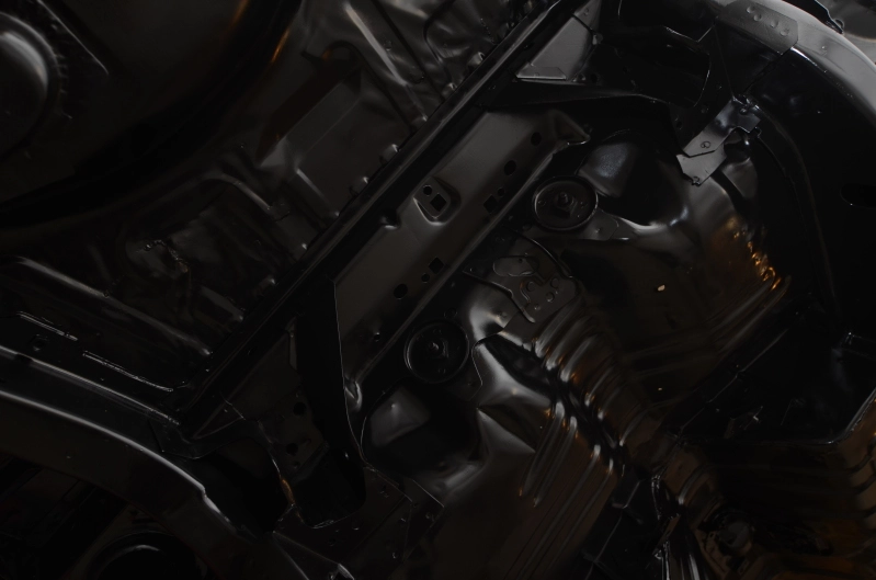

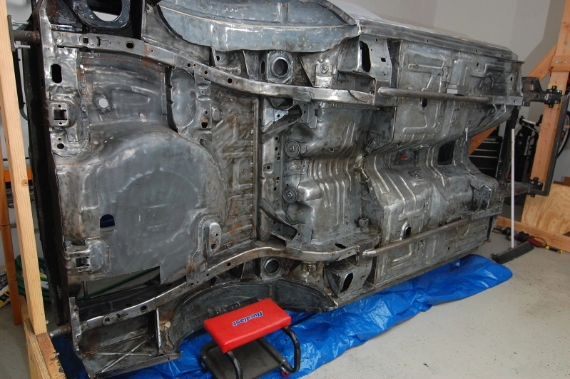

And here is an evolution of the underside to give a better idea how it all progressed:
