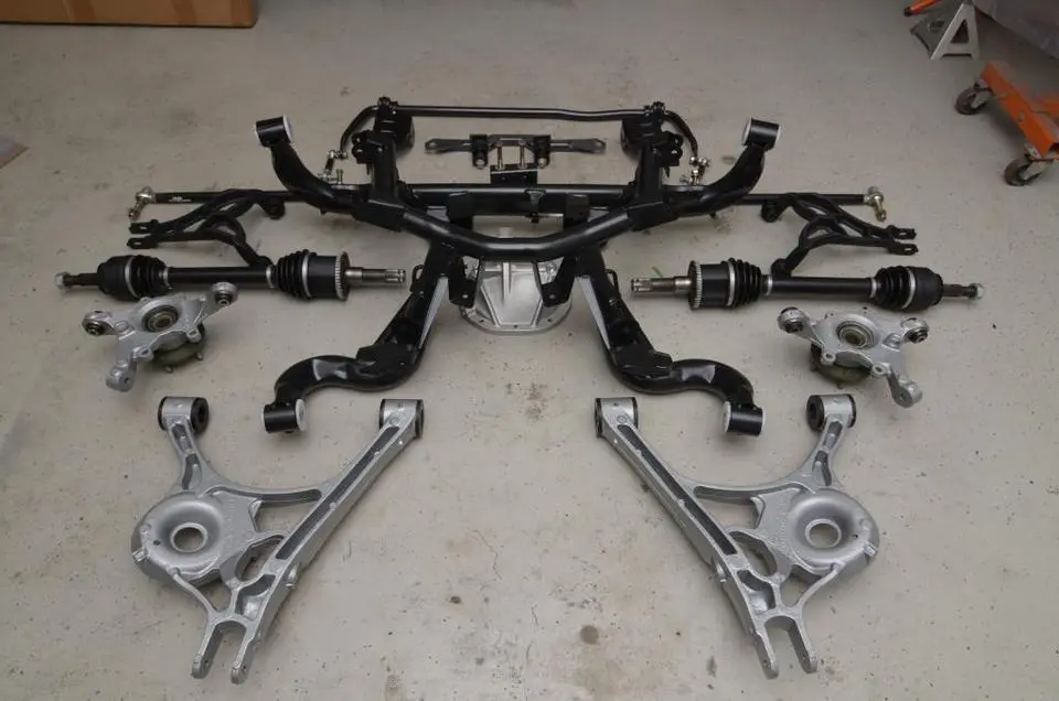

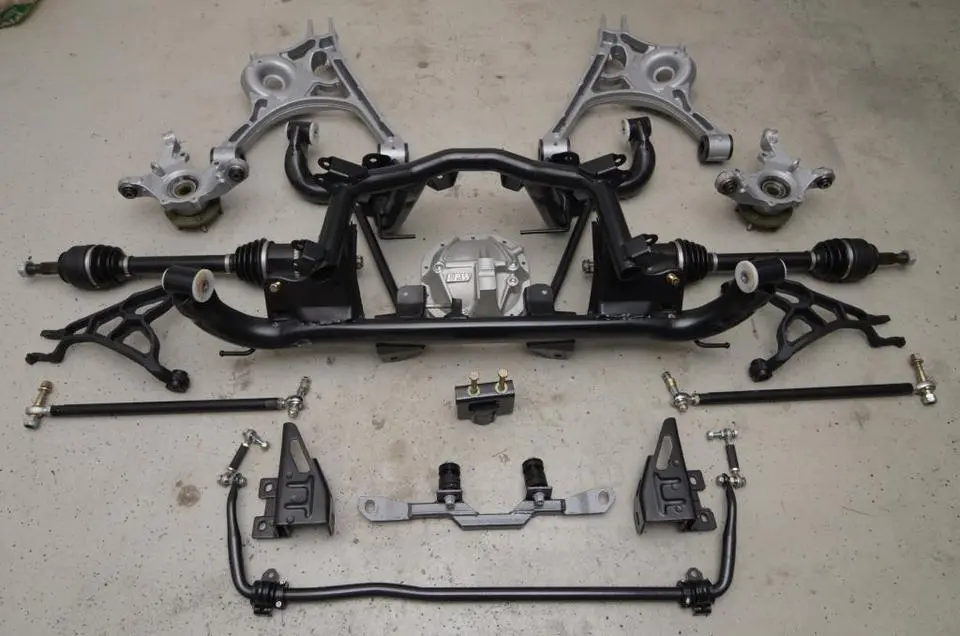

In other news, I realized this thread has over 2 pictureless pages. Not acceptable. I have the whole rear end (minus differential) ready to go for assembly. The local transmission shop owner said he will do the gear install tomorrow. $150. I guess that isn't so bad. I've heard people paying a lot more than that.
So, here's all the IRS parts ready to go...

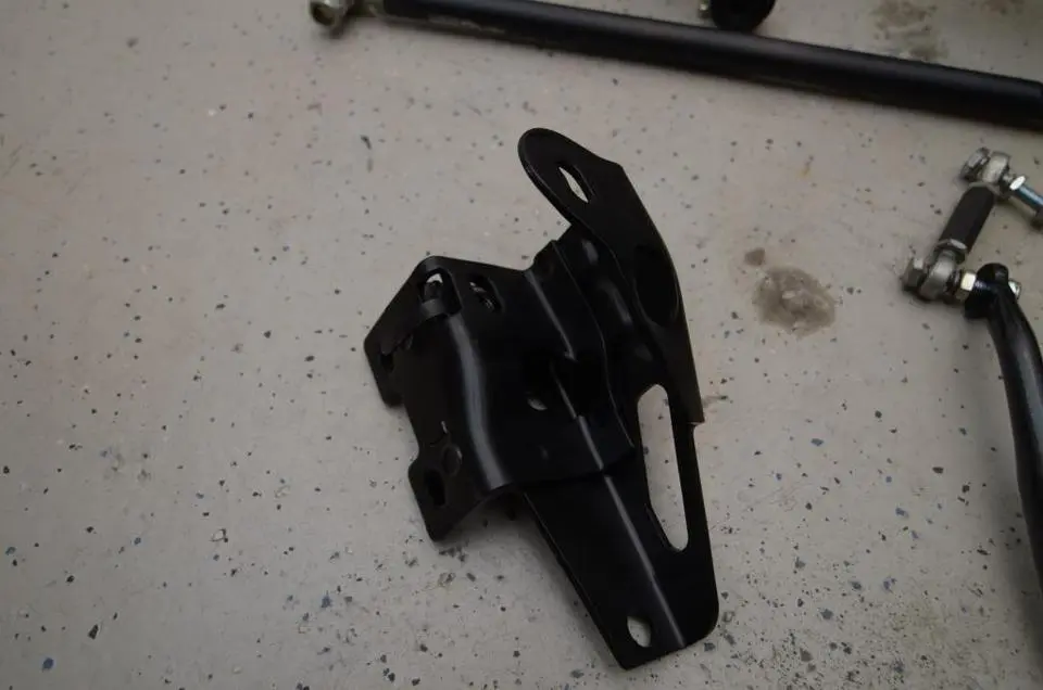

The upper subframe brackets were powder coated in a semi-gloss black.

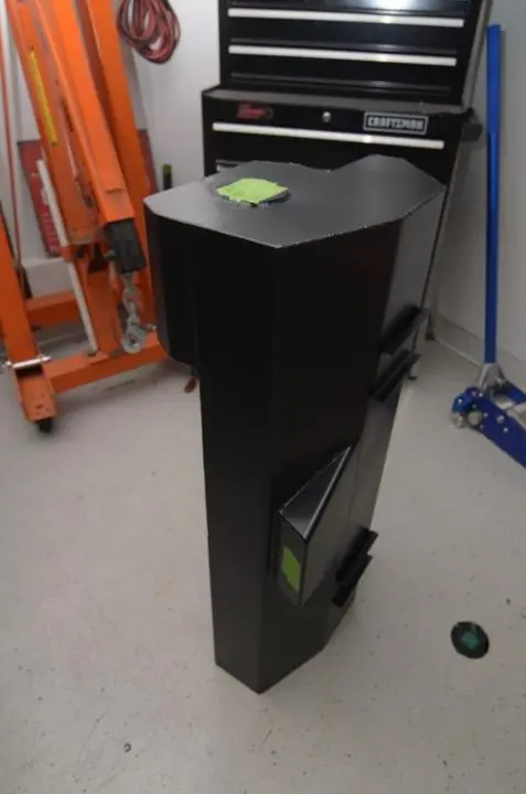

I also had the BBRC tank powder coated in the same black. I was originally going to go silver, but decided I would like the black better because it will not stand out as much with the Cobra rear bumper. I'll have a black fitting and black braided line coming out of the sump. Trying to keep things stealth here. :cool:
The straps are still bare aluminum. I may have them coated silver for contrast. Still undecided on that yet.

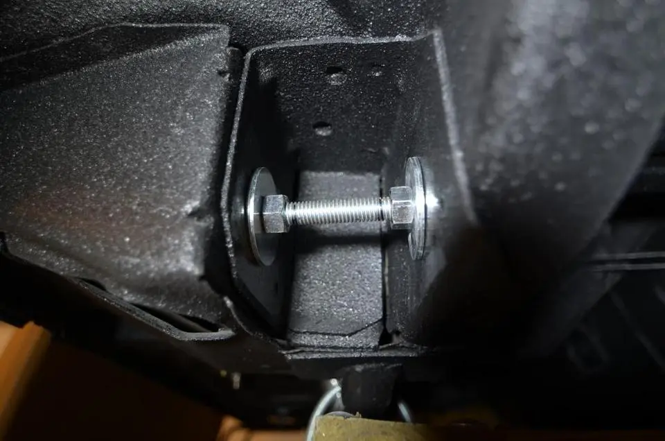

One thing I forgot to do when the car was on its side was to expand the lower torque boxes. When I mocked up the IRS, it was a real PITA to get the lower subframe mounts to squeeze into the torque box buckets, and that was just with a bare subframe. It will be much more difficult with a fully loaded IRS.
Took a 1/2" rod, some fender washers, and two nuts and expanded the heck out of them. The black marks on the threaded rod are the original position.
I should have bought enough hardware to do both sides at the same time, but I'm not that smart.

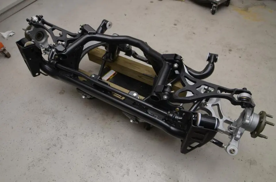

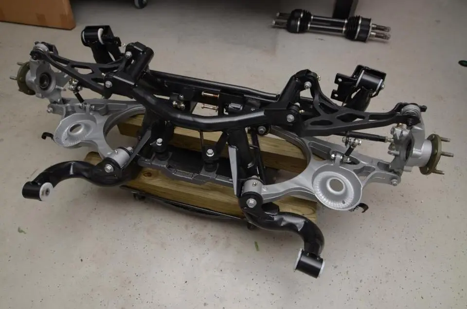

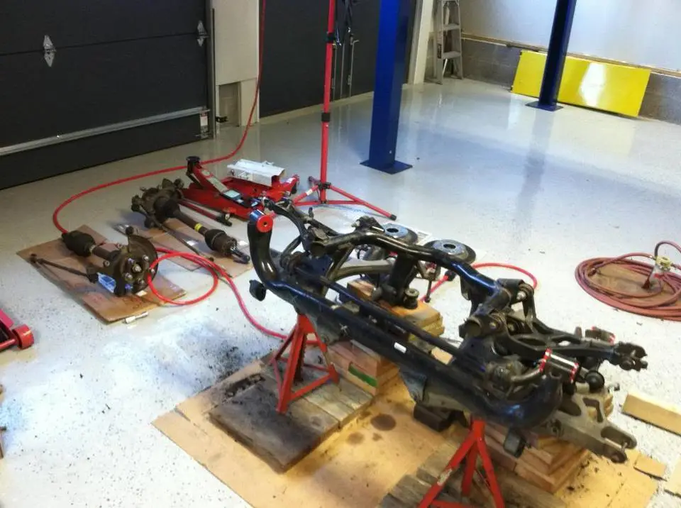

I did manage to get the IRS back together save the differential. Didn't torque everything down yet, but at least there aren't a dozen parts laying all over my garage.
The wheel dolly/4x4 combo gets me a good amount of height. Should make getting the IRS into position much easier.

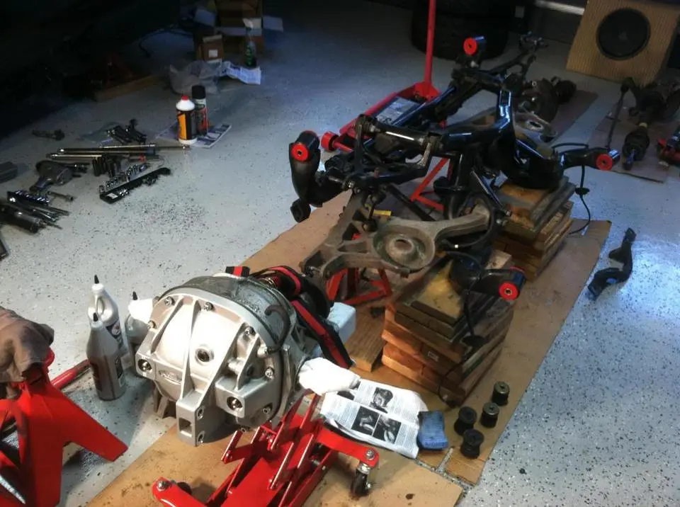

If you don't already have one, Harbor Freight transmission jack is your friend for getting that thing in and out of the car! I've done mine twice already and I could do it by myself with that jack. I had help both times which just made it go faster, but that jack has paid for itself so many times already.

Haha. I know your pain. Thanks for the tip about the jack. I'm definitely going to look into getting one of those. It is a real bear moving this beast of a rear end around.

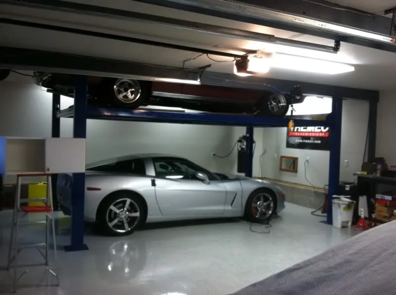

Is that your garage?? Lift and everything?

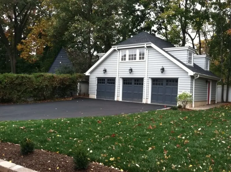

Gahh I wish. It's my parents garage that they just finished building. It's 3 bays now so I'm storing my car there over the winter since don't have a garage at the condo I live at. Not sure if you remember the old 2 car, but here's the new one...

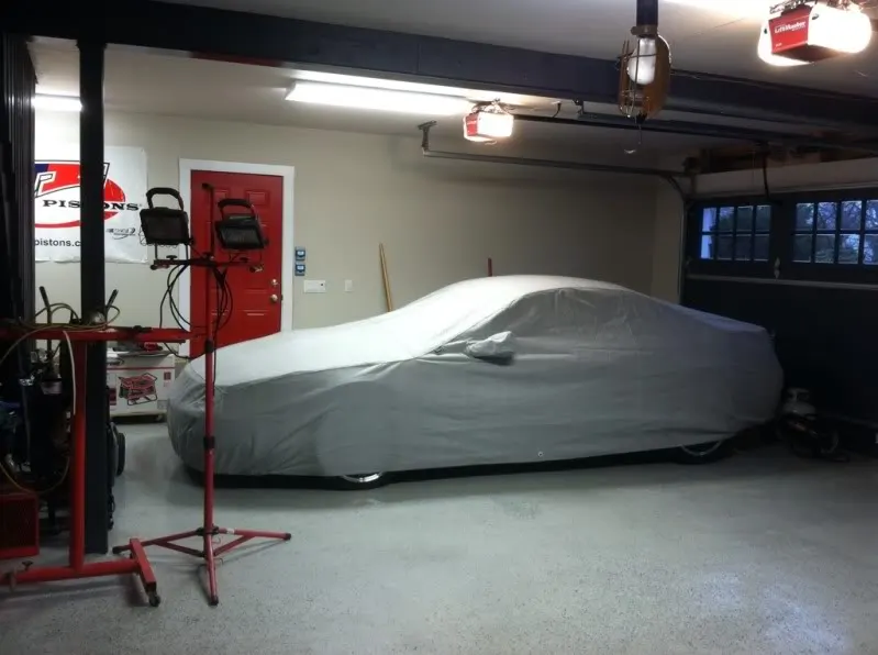

And the babygirl tucked away...

Holy mother of God. That's a garage if I've ever saw one! Who cares if it isn't yours. To have something like that at your disposal is amazingly awesome. I like your dad's style.
Yea I guess I can't complain. It is definitely awesome to have a nice, spacious place to work on my car with good lighting and nice flooring. I had a lot of input on designing many things in the garage and I'm glad because everything turned out so sick. My girlfriend always gets so pissed when we both go visit my parents for the weekend and I immediately go right out to the garage to tinker with something. She's so screwed when we get our own house with a garage...HAHAH!
