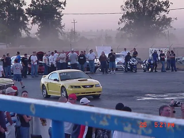

I went with steeda lowering springs.. and lakewood 70/30 struts up front to keep my weight transfer good.. I like it a lot.. best of everything launching and handling..
