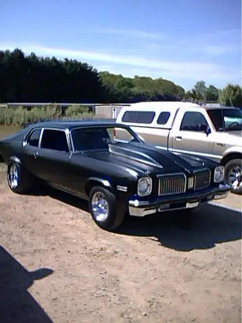

want to paint hood flat black
heres a pic of my car with flat black primer and a 3 " cowl
I'm not even going to ask why you want to do this, but I will try and help. My buddy painted his Omega with Krylon semi gloss black, and it came out incredibly nice for $30.

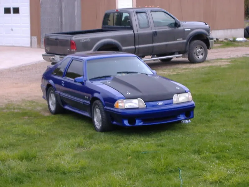

I know this is a terrible pic, it was a cell phone.
I used Duplicolor on my car....mainly because their cans have the fan tip and spray in a fan pattern which is easier to lay on evenly (more like a real paint gun). The problem is that it's going to fade eventually...look at the pic in my sign, that used to be flat BLACK not grey.
