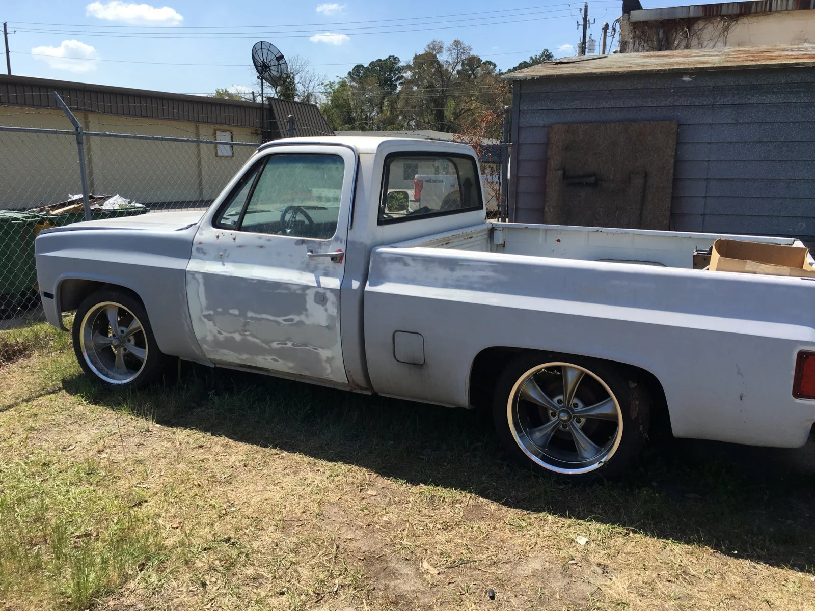

A few months ago the other shop owner, and head mechanic, bought a c10. Besides the paint needing work it’s a really straight southern truck. Only problem is the 6 banger in it is on the last leg.
So I’ve got some decent 302 parts, as well as a good (hopefully) c6 trans and a Chevy that needs a power plant. I’m guessing you can see where this is going.
Here’s the truck:

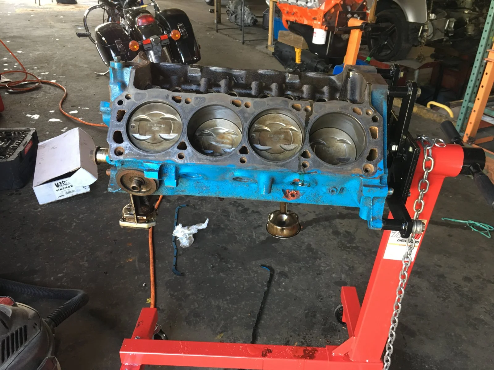

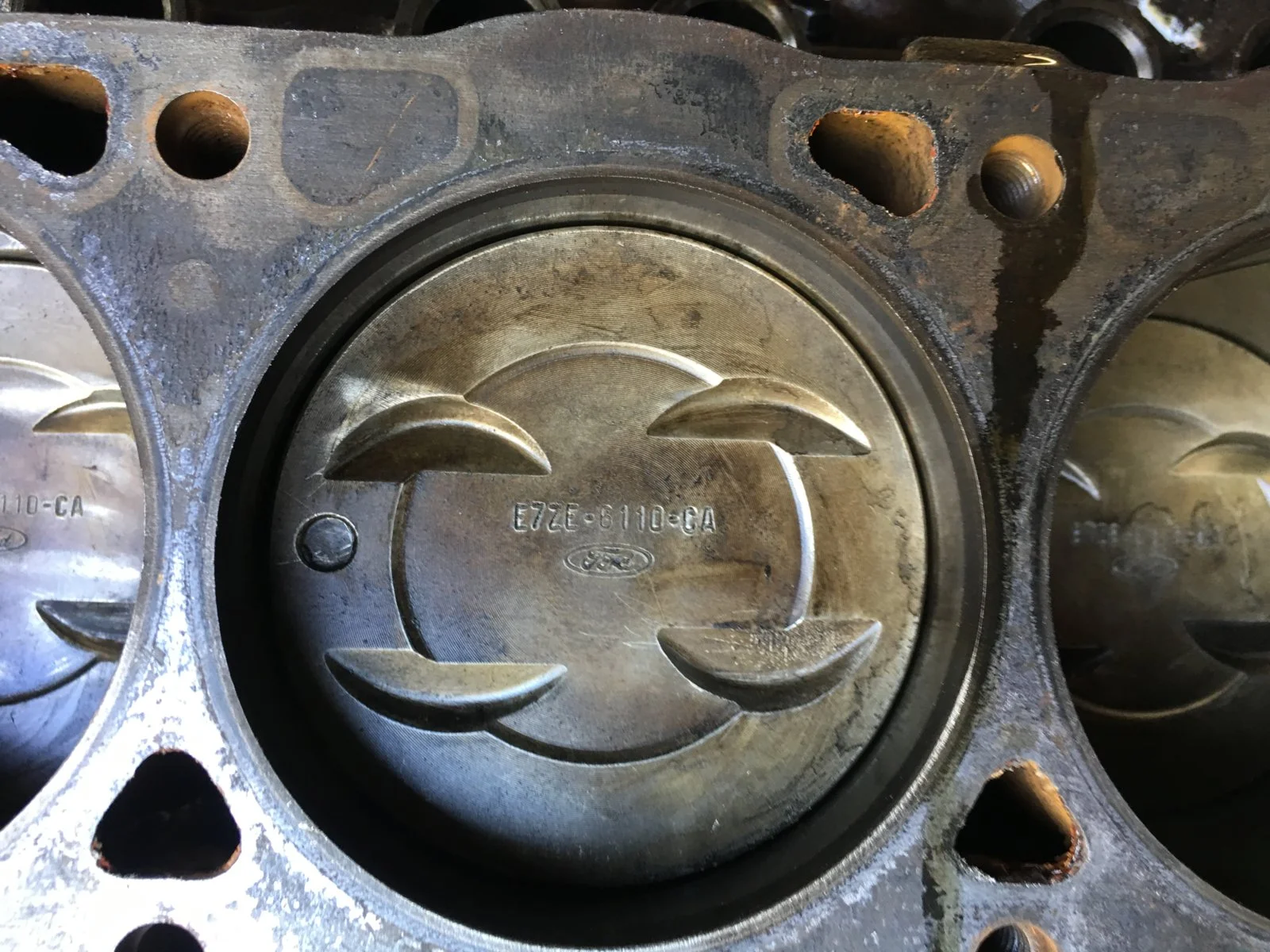

I really didn’t know what shape/year the 302 would be in or even if it was a roller block. I was hoping it was at least a roller, which it was. I pulled the heads off and it looked to be in great shape. In fact, it almost looks like someone started rebuilding it and never started it. Unless the factory pistons usually stay this clean lol.

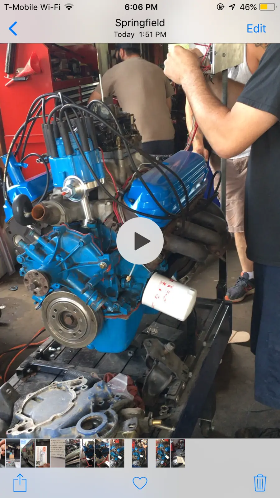

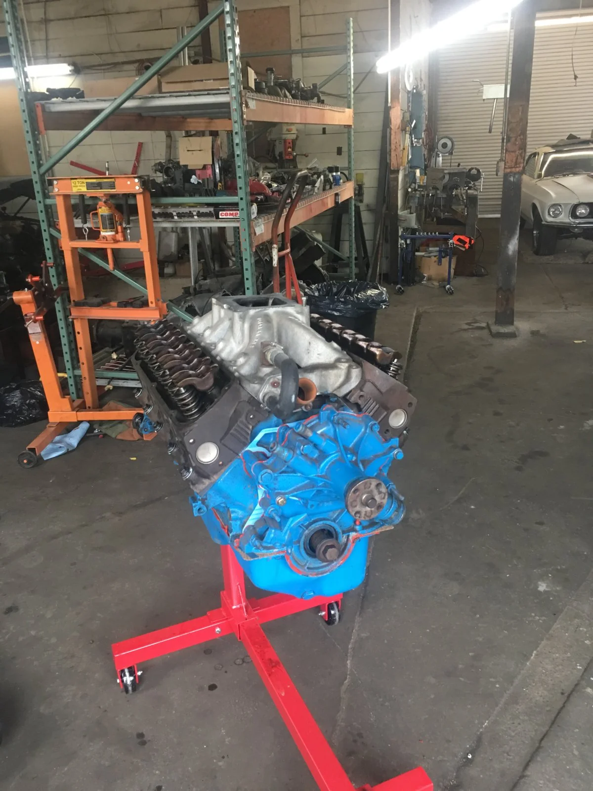

Making progress. A Vic Jr on a truck!
All done. Like the spark plug wires? That’s more stuff the owner won at an auction. Got like 100 boxes of misc wires for like $50. We made use of a few boxes of 4 cylinder plug wires lol. Looks like Medusa.

Pistons are stock, we didn’t even clean up the bore. Cross hatching looked good and there was minimal wear so we rolled them bones

As you can see we build this with parts we pretty much had lying around. Cheap and used are the themes for this. I fired the engine up on the stand today and it sounded great through those open headers. Those eBay distributors actually work great lol. Motor made 50lb of oil pressure at a cold idle. Should live for awhile.
