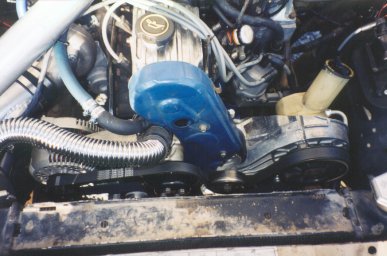

yes, go get the engine brackets from any 93-94 2.3 ranger.... than cut the section off where the a/c bolts too (cause that is where your alterntor currently is already) the alternator side bracket will put the alternator right where your a/c compressor is currently.... Here is a pic of the ranger brackets on a 2.3 turbo with the a/c compressor mount cut off, you can see where he cut on the right, it's the shiny part

see the alternator on your left side, and the power steering pump is in the exact same spot, now you have a perfectly clear shot, and then some, to your intercooler.....

heres my set up now.
here what i think it will look like by the way your talking.
for the most part, i'm not sure if it will run off of one serpentine belt or not.... If you all the pullies line up than you can use the ranger tensioner which is actually under the alternator.... I just saw your post on rangerpowersports.com beleive me you will get nothing..... I had to look for almost 2 months straight to find my brackets tha tI just found.... For the belt they will both be trial and error at a parts store, tell them your custom predicament, and park in the parking lot, usually somoene cool there will let you try a bunch of them and when you find the right one just write down the number for reference if you ever need one again.... I WILL keep an eye out locally here in the junkyards for you since I'm frequently there....
