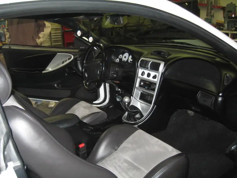

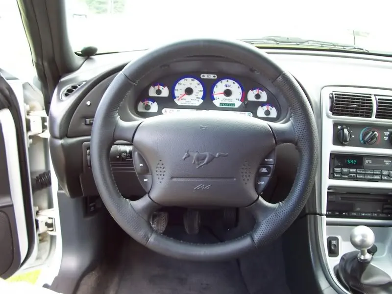

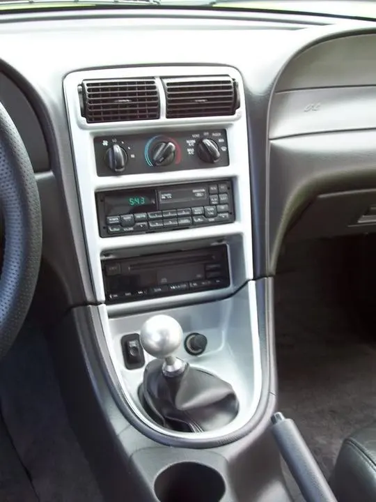

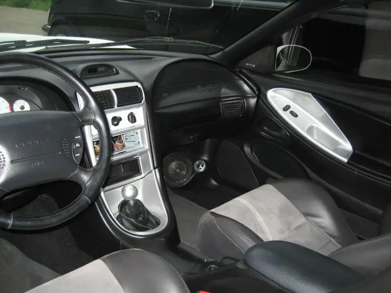

Here's mine... Can't turn down a chance to picture whore
