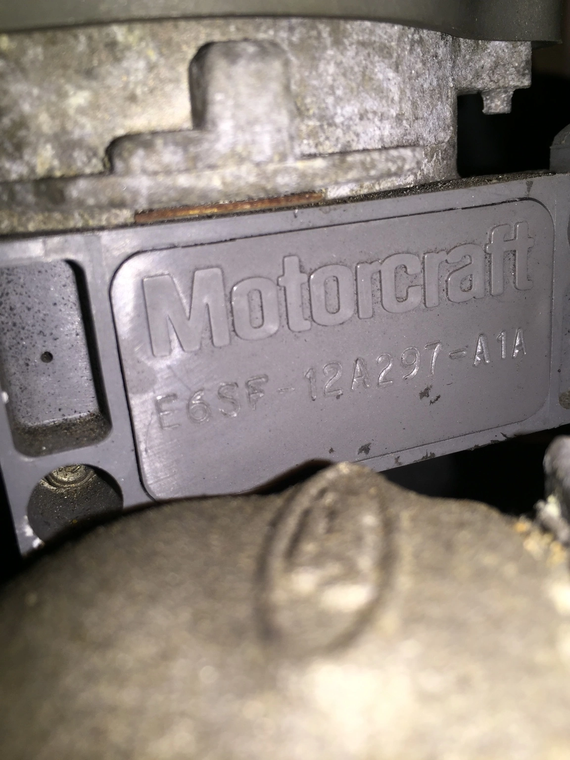

I guess I'm lucky in the sense that I'm still running my original TFI. It original in the sense that I got the car in ~1997 with under 50k miles and haven't touched it ever.
Back in the late 90s early 2000s I junkyard dove a bit, and any time I came across a 5.0, I took the TFI. Prob had a dozen or so, And over the years they've trickled off onto friends cars here and there.
I kept only one spare (kicking myself now) that I keep in the glovebox along with the TFI tool and thermal grease.
Here's the original unit still kicking
I never paid any difference in part number corresponding to transmissions. Is there a difference? Every time I gave my friends one they all ran fine.

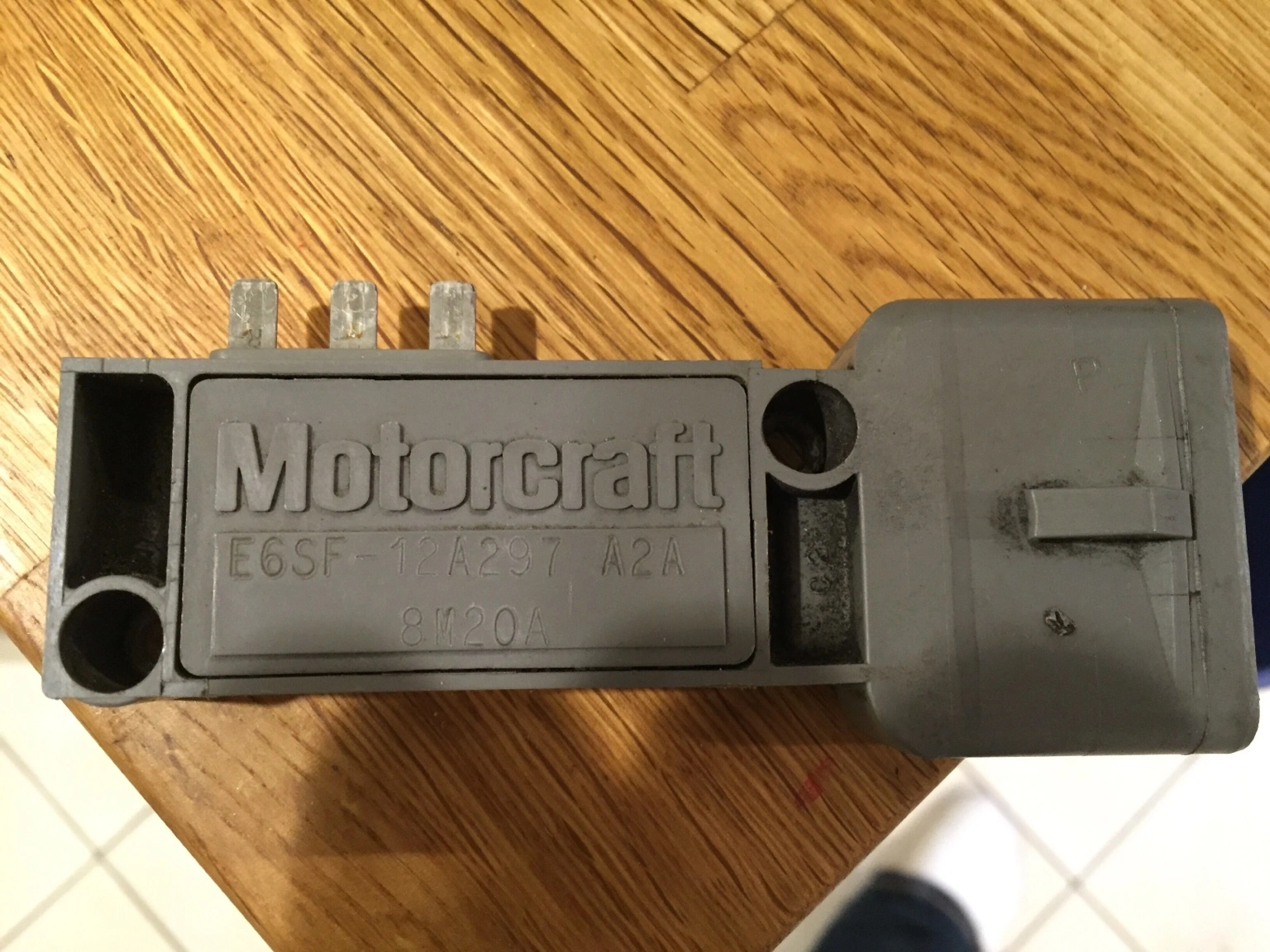

Hey man. Be sure to have that one you got from ebay tested. I bought three from the guy hoping that at least one would be good (aftter the luck ive been having) and all three failed the resistance AND Autozone tests. At AZ, two failed on threshold and one failed on current and saturation.
I guess it's not altogether surprising that these are garbage seeins how they were only $17 apiece by some rando on ebay. I must say, though, that i was excited when i opened the motorcraft boxes and the parts actually had the motorcraft logo! Oh well. These are going back..

I'm at a complete loss here: 7/7 new TFI modules arrive DOA... How is that possible? I've racked my brain trying to determine if there's a likely explanation, but I have nothing. Here's what I've ruled out:
:thinking:
1. DMM works fine and has new batteries. Also used analog MM to confirm resistance results.
2. AZ Wells tester works fine; it is capable of passing a unit. It gave a passing grade to my original Motorcraft (branded) unit.
3. There is no disagreement between my resistance tests and AZ's Wells tester. So far, the results are 100% in agreement across 7 modules tested (6 duds plus my original).
4. It's not the brand. The 1st was a Standard T-Series, the 2nd and third were bunk unbranded Motorcrap, the 4th-6th were branded Motorcraft, and the 7th was yet another unbranded Motorcrap (much to my surprise).
5. It's not the vendor. The 1st was from LMR, the 2nd and 3rd from RockAuto, the 4th-6th from some rando on Ebay, and the 7th from Ford, himself.
