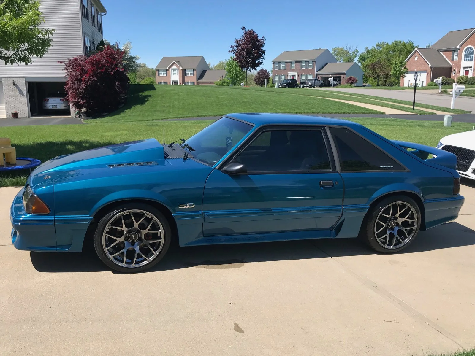

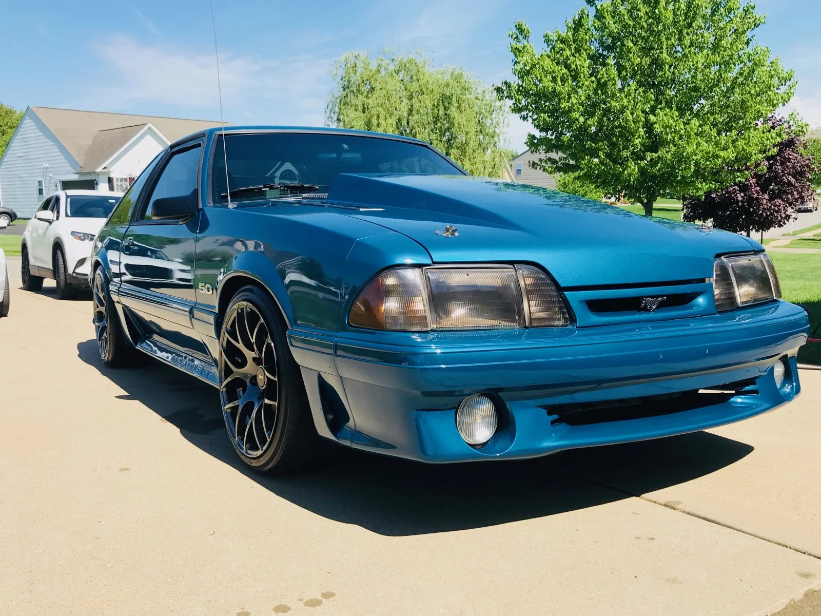

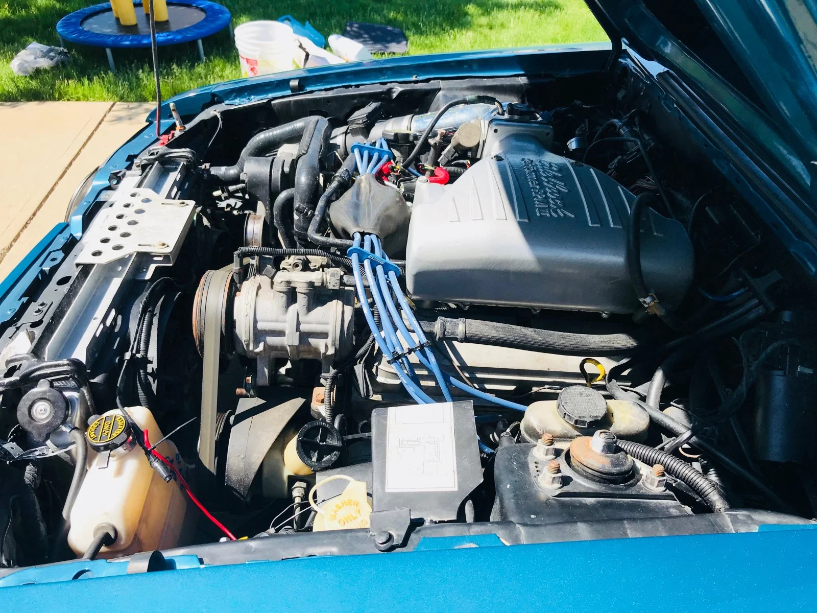

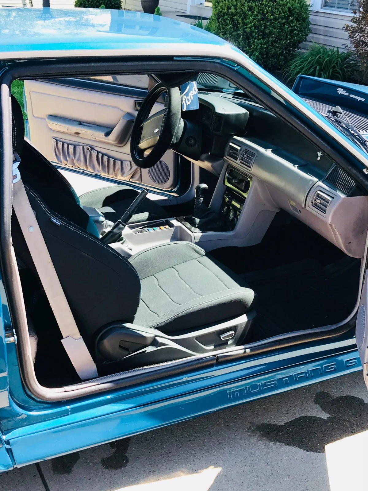

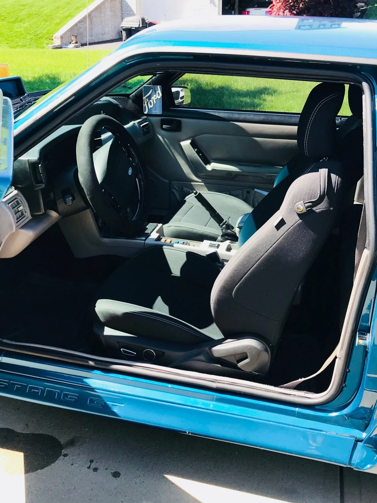

A few pics of the old girl...

Everything is relative.
That car based on the way it looks is gonna have to have two things going on for you to feel even remotely bad about your purchase.
# 1. As stated previously.
You paid stupid money for a car that was supposed to be a complete turn key deal.
#2. The mechanical noise you're hearing turns out to be more than aftermarket rocker arm noise, and you paid stupid money for a car that was supposed to be a complete turn key deal.
Aside from that, and again as stated already....the body of the car, and the condition of the repaint trump ANY mechanical issue. A monkey can swap out an entire engine....it takes a well trained very experienced human to fix a hagged out body, and repaint the car.
Count yourself fortunate.
Unless you paid stupid money.

It's a 351 swap. That's a plus.
How much was invested in that 351?
Does it have a SN95 full 5 lug, 4 wheel disc swap?
Plus.
Does it have functioning AC? Plus.
A car like that can't be built for 10k...but it can be bought for it.
I paid 7500 for it. It’s got summit blueprint aluminum heads and a trick flow stage two cam. It’s also got the Edelbrock performer 2 intake. The short block as I understand it is completely stock .
Five lug swap but not four wheel disc.
AC is there and functioning
